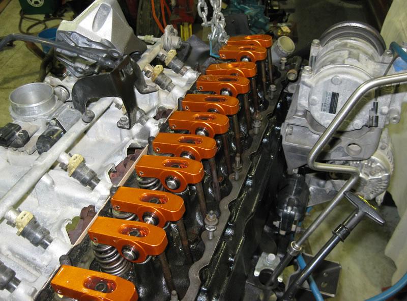

Here's an example - this is a 4.0 but it's the same concept - the orange are the roller rocker arms I used on this engine I built.
The valve cover goes over the valves/springs and rockers and keeps oil in the engine, and from spraying out all over, and keeps dirt out.
You could technically run it without a valve cover........or with a very leaky valve cover gasket, and nothing would happen but make a mess of oil all over the outside of the engine.
There's just no way for a valve cover leak to allow oil into a cylinder.

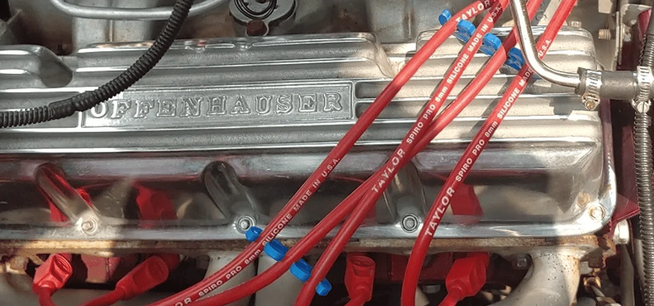

And one of the valve covers on another car I have - if it leaked it would let oil run out all over the spark plugs, plug wires and onto the headers, making a really stinky mess, but with zero impact to running, and no oil can get into the cylinders this way -

Valve covers have nothing to do with the cylinders, and can't allow oil to get into the cylinders.
If they leak, things get messy, but on the outside of the engine.
