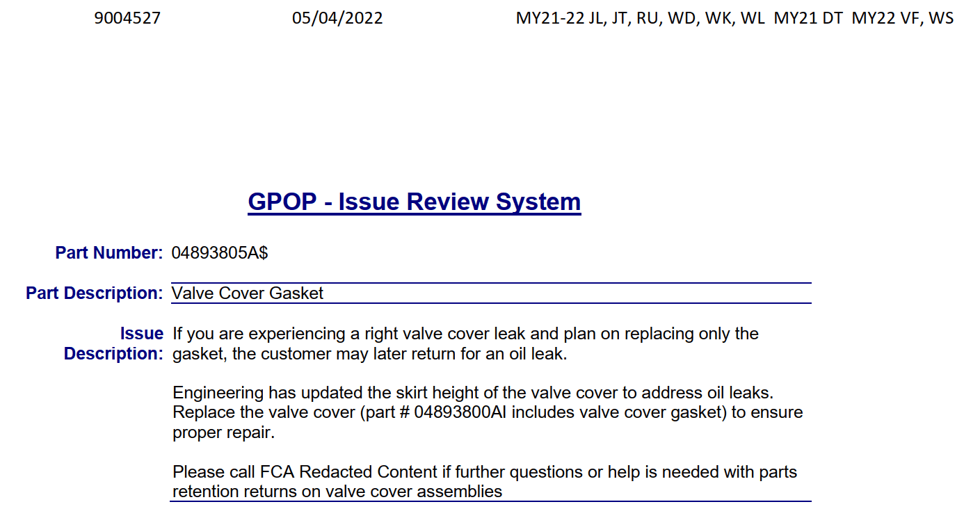

OK, you have a 2021 and a right side valve cover leak. That dealership needs to look at the document I posted. You possibly should have gotten the updated valve cover - it may leak again. Jeep has found a problem with the right side valve cover itself that can lead to leaks.
Model year 2021-2022 (March 2021, right in the middle of the 21 model year), right side valve cover leaks - I bet they owe you a valve cover.

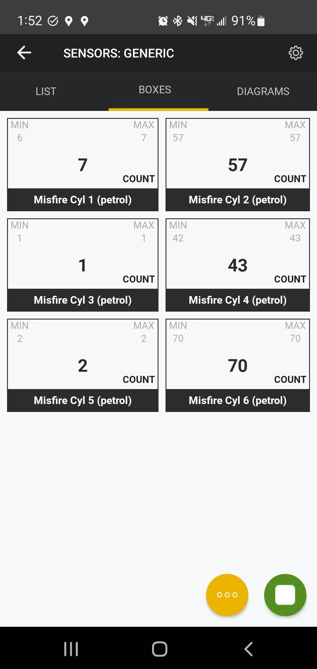

Flashing light again today. Light didn't set, just flashed for several seconds and went away. Truck wasn't running rough or shuddering. Truck had been sitting all day at work - drove three miles to the grocery store and turned it off. Came back outside 15 minutes later, threw code as I was leaving parking lot. Gentle acceleration (2200 RPM when code hit), 83* outside with 52% humidity.
Quicky threw the VLinker in and opened JScan and screen grabbed the code, the freeze frame data, and the misfire numbers per cylinder. Also screen grabbed todays weather information.
Truck running silky smooth and quiet at idle.
Going to get better at this data grabbing. Making a folder on my computer for each misfire instance to put my screen grabs. After I have a small collection I'll take that and @ShadowsPapa TSB and see what they think.
