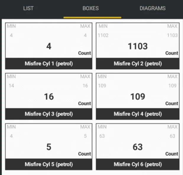

Pay attention in algebra and college math classes, kids - you can do it, too. At 800 RPM it should fire every cylinder 400 times. RPM times number of minutes divided by 2.
So if it's misfiring for 2.5 (that's 2 and a half) minutes, running 750 RPM, each cylinder should fire about 927 times.
I timed mine for 3 minutes at idle RPM and got ->
Jeep Gladiator Survey- For those with misfire issues 1695049267965
The other cylinders on that bank misfired but in decreasing severity as far as numbers. It cleared up on its own after a few seconds and didn't do it again for weeks. In that case the MIL never stayed on.
