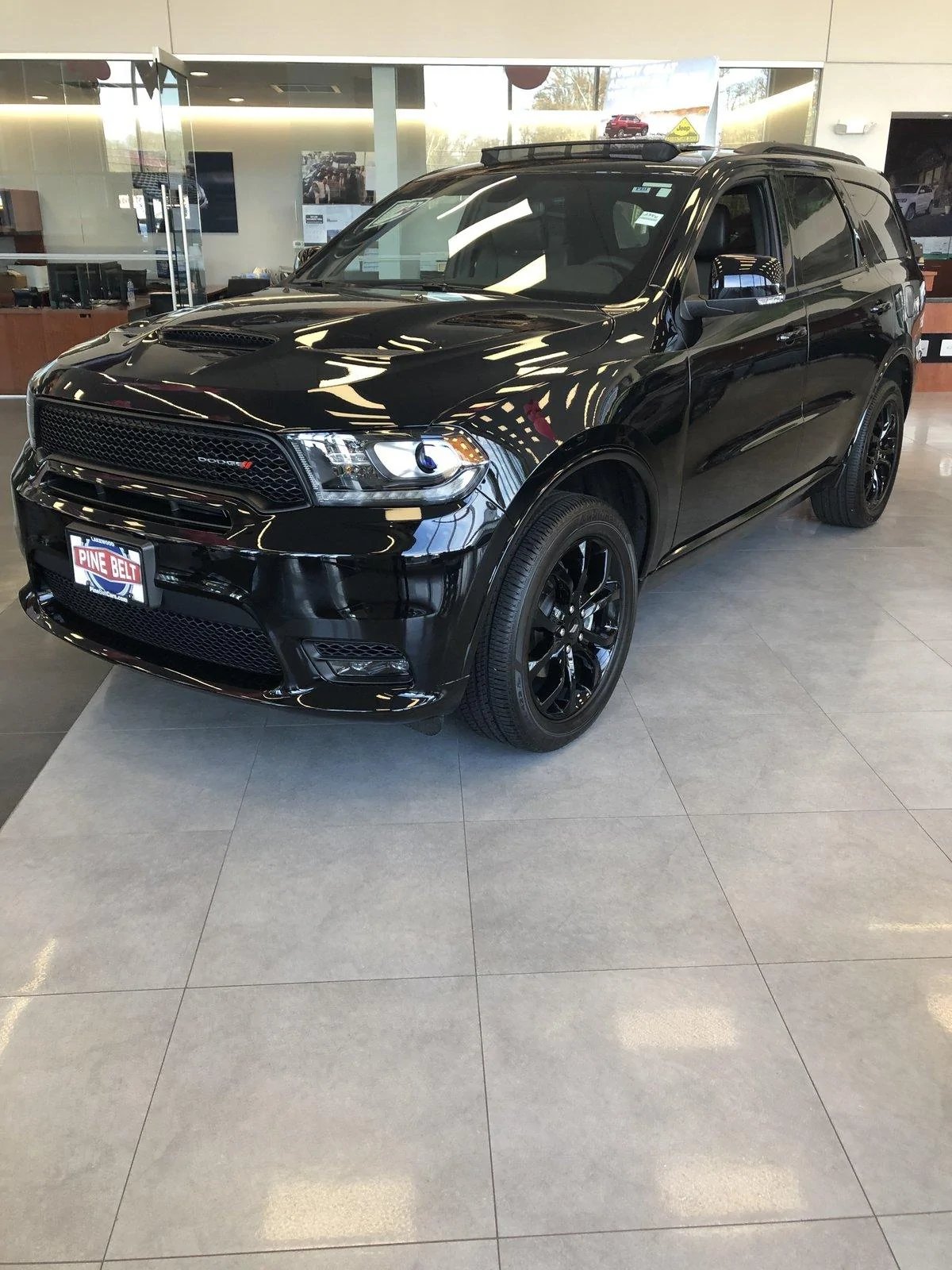

MRCTEK
mark
Jun 16, 2020
NYC
2020 Durango
engineer
Just like to add I have a 2020 Durango same issue misfire. went to dealer moved plugs and coil. no clue on misfire 4700 miles on it. on the way home from dealer same issue and code. runs fine until I go to pass, light comes on no start/stop until I restart. called dealer they said bring it back to reset code. no answer on fix.
