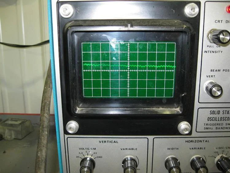

Should still be able to watch, for example, #6 pattern for differences. The ignition cycle is still going to happen at the exact same rate - 1 spark for every 2 revolutions of the crank and idle speed is pretty much the same as anything from the 60s or 70s so you can watch the spark pattern. The kicker is that there's no "central coil" to collect the signal from like the old days so you can really only check one at a time. You'd have to treat it as a single cylinder engine, one at a time.
I should hook my little scope up to my JT and see if I can figure things out. No misfire, but see if I can pull the signal very easily. Heck, I even scope alternator patterns to help diagnose issues there, too.
(well, until the power supply fried, I'm working on fixing that now along with a bazillion other things)

I’d be thrilled to see how you can see a failure of a single lifter through a scope pattern. You’re a lot better than I ever was. I am always willing to learn.
40,496
54,061
More for ignition and fuel diagnoses.
The lifter issue is going to be different.
BUT - years ago we could gather indications of mixture issues from the pattern and when you saw that one one cylinder of a carbureted engine, you knew it wasn't the fuel system - not the carburetor as any issue there would impact all cylinders - or half at least.
The spark patterns should all be even in length and height, the start and stop of the spark should be even among all cylinders. Even how it starts and ends is telling.
You rule things out. If the scope pattern shows perfect ignition cycles and doesn't indicate a mix too lean (I wonder about that.......) then you go mechanical.
