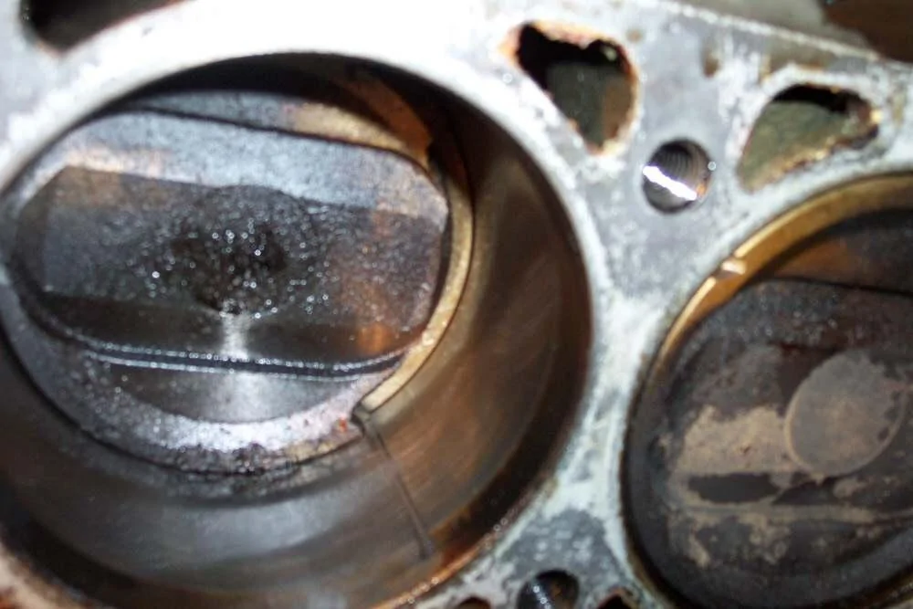

I imagine it could be a bit of both. The fueling and timing tables are better in the agresive driving maps. If there is. Ring seal issue, heat and speed will help if done correctly, better fueling will also help. Light load and detonation is a surefire way to turn marginal ring seal into blow by
Detonation melts and breaks pistons, normally little impact on rings. It blows away the barrier layer in the cylinder exposing the top of the aluminum piston to temps above the melting point. Detonation is the collision of two flame fronts as super-sonic speed,. The sound is literally the "boom" resonating with the block - "ping".
That intense collision can also break pistons (the rings themselves being protected until the piston breaks)
The rings will be 'broken in' extremely quickly on modern engines - in under 100 miles. Boring, honing, and ring manufacturing is so precise all "break-in" does is wear of the microscopic high spots. A few heavy accelerations and it's done. (based on info from Perfect Circle - maker if piston rings)
Heat doesn't help - high differences in the pressure above and below the rings are what force them out hard against the cylinder wall, accelerating the "wear-in) or wearing off the microscopic high points. The rings themselves don't need to wear, nor do the cylinders, only the microscopic highs, or "roughness" you can't see.
Even at 100,000 miles you should still see the ring machine marks and the cylinder hone cross-hatch pattern.
Detonation damage on a V8 I worked on - 24,000 actual miles -
Jeep Gladiator Survey- For those with misfire issues piston-5a
