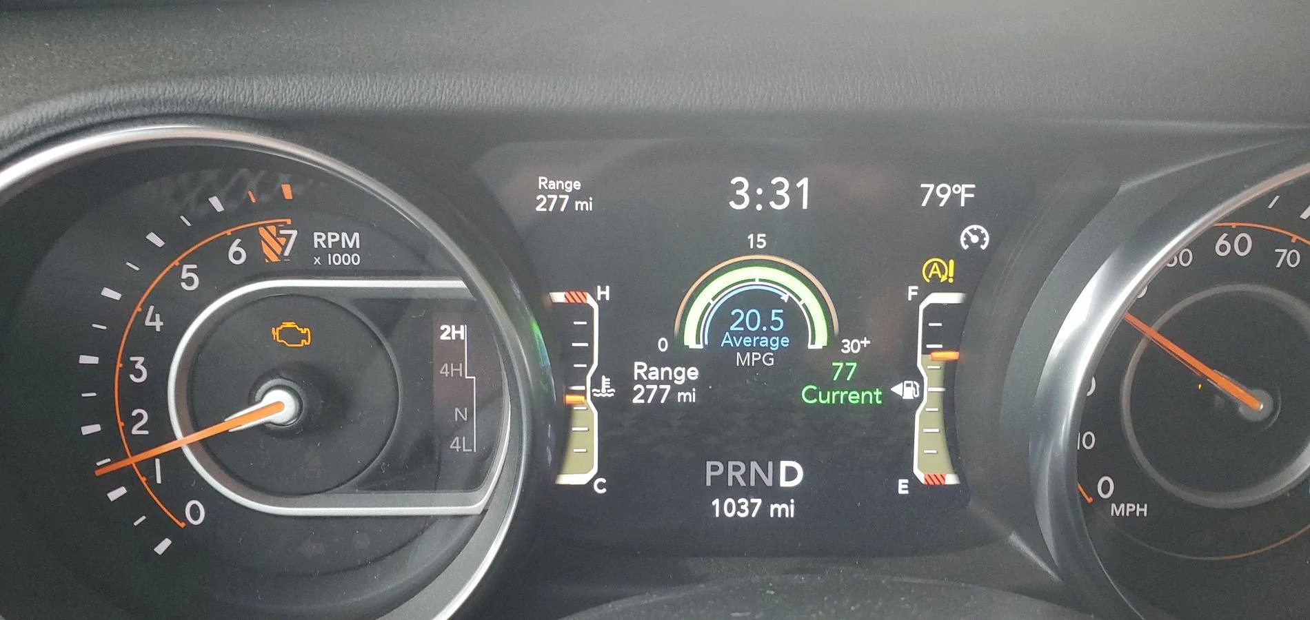

I have my truck back as of this morning.
Anyone want to bet the over/under on how long it lasts this time?
I am guessing 6 days.
ASS light came on almost instantly when leaving work. Maybe 4 days...

Hi, I believe they adjusted the sensitivity of the CEL during the software upgrade without really addressing the root cause of the problem. Furthermore, the ASS light is still coming on as a result of actual misfires because, as I understand things, it is programmed to disengage when a misfire is detected. In my case, that is exactly what was happening. Also, the computer was throwing a PO300 and classifying it as a “pending” code that goes away if it does not reoccur on the next start up. When taking mine in to the dealership the latest time, the ASS light had come on when leaving the house for the dealership. I had the dealership read the codes with the engine running upon my arrival, and BINGO, it had registered a “pending” PO300 misfire code. Upon further investigation, they determined the compression is low on cylinders 2, 4 and 6. They are waiting on guidance from FCA on next steps.
I bought the vehicle in early May and, at this point, I have lost count of the cumulative days in the shop. Also, as a point of reference, the manufacture date is late November 2019. This is certainly not the new car experience that one would expect...

That makes total sense.
I remember every time I have gotten the CEL and it follows the pattern. I believe the one time I shut off the engine to see if the ASS would go away and boom, there it was. I will be sure to take mine in immediately next time I get the ASS and have them check the codes.
