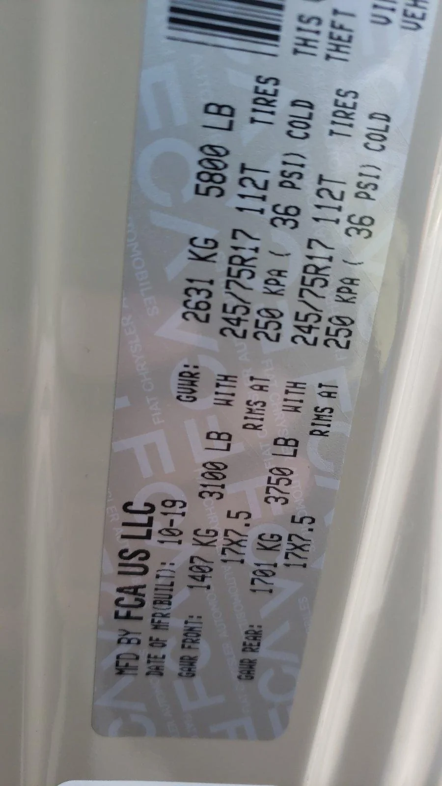

October. Dealer just replaced an injector. Let's see how it goes.

So looks like all the Gladiators on this thread have build dates between September 2019 and February 2020 with the majority falling between October 2019 and December 2019 and were built in Mexico.

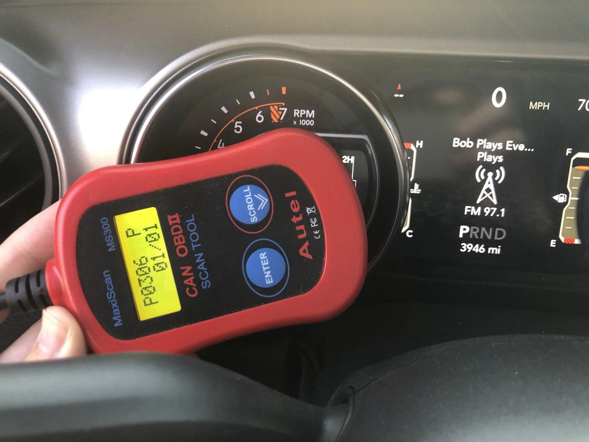

So I’m now at 3946 miles, some 1300 miles since it was last in the shop having the left side guts replaced. This morning I got the first ESS light I’ve seen since back then. Thanks to the wizards in this forum, I checked the codes (I now keep a scanner in the console, which I shouldn’t have to do) and saw it has a pending PO306 - same code it had at the beginning. So I’m afraid we’re about to go for another ride down FCA road...
Sorry to hear that Gameshow. My final step of the buy back is scheduled for next Monday. Turn my keys over and they hand me a check. I seriously can't believe how long this process has taken. Still gun shy to buy another Jeep. Good Luck. Wish you the best.

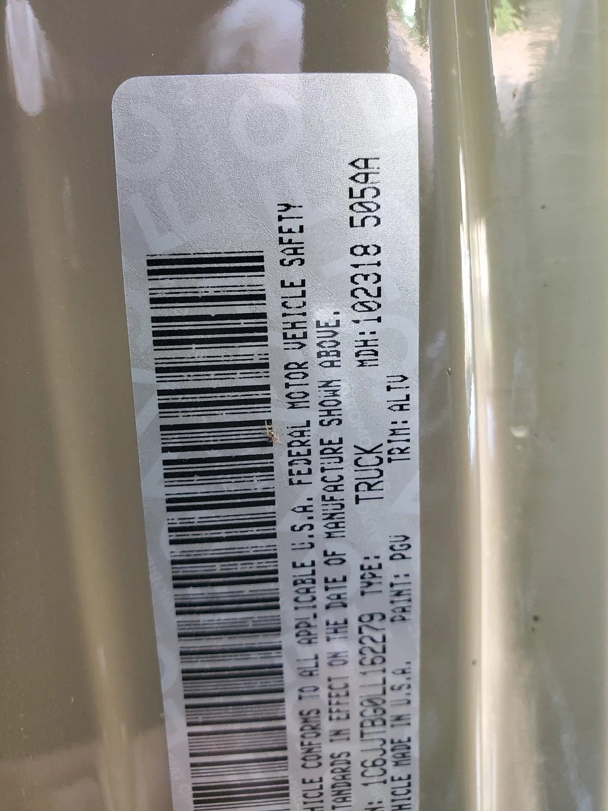

Hey All!
If you have had the P0300 code with check engine light & ESS light post your build date. Look for MDH (month/Date/Hour) on the door well sticker. DO NOT POST IF YOU HAVE NOT HAD THE ABOVE MENTIONED.
Lets keep the replies just to build date so its easy to decipher, not some long write up ok.
If you know your engine assembly location include it. ( should be on the vehicle sticker that shows all options & final price)
Build date is located on the sticker in the drivers door well under MDH.
Let see if we can narrow this down and find a pattern.
