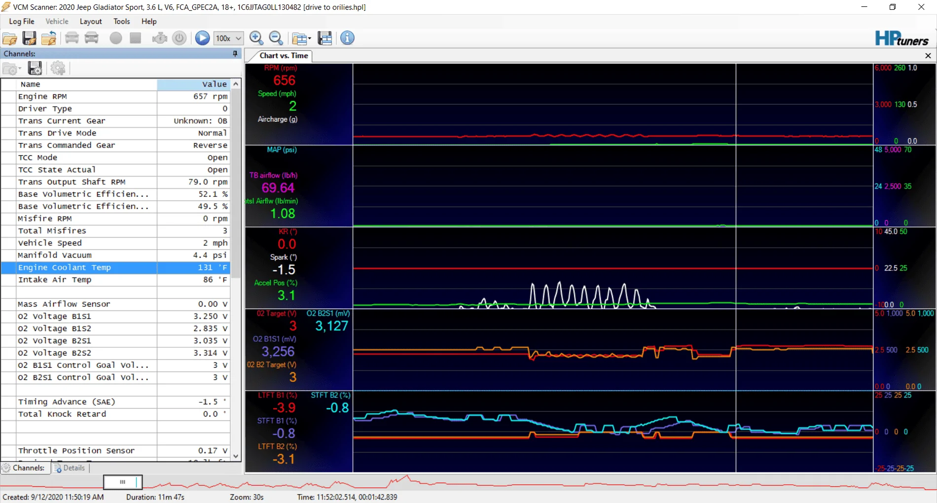

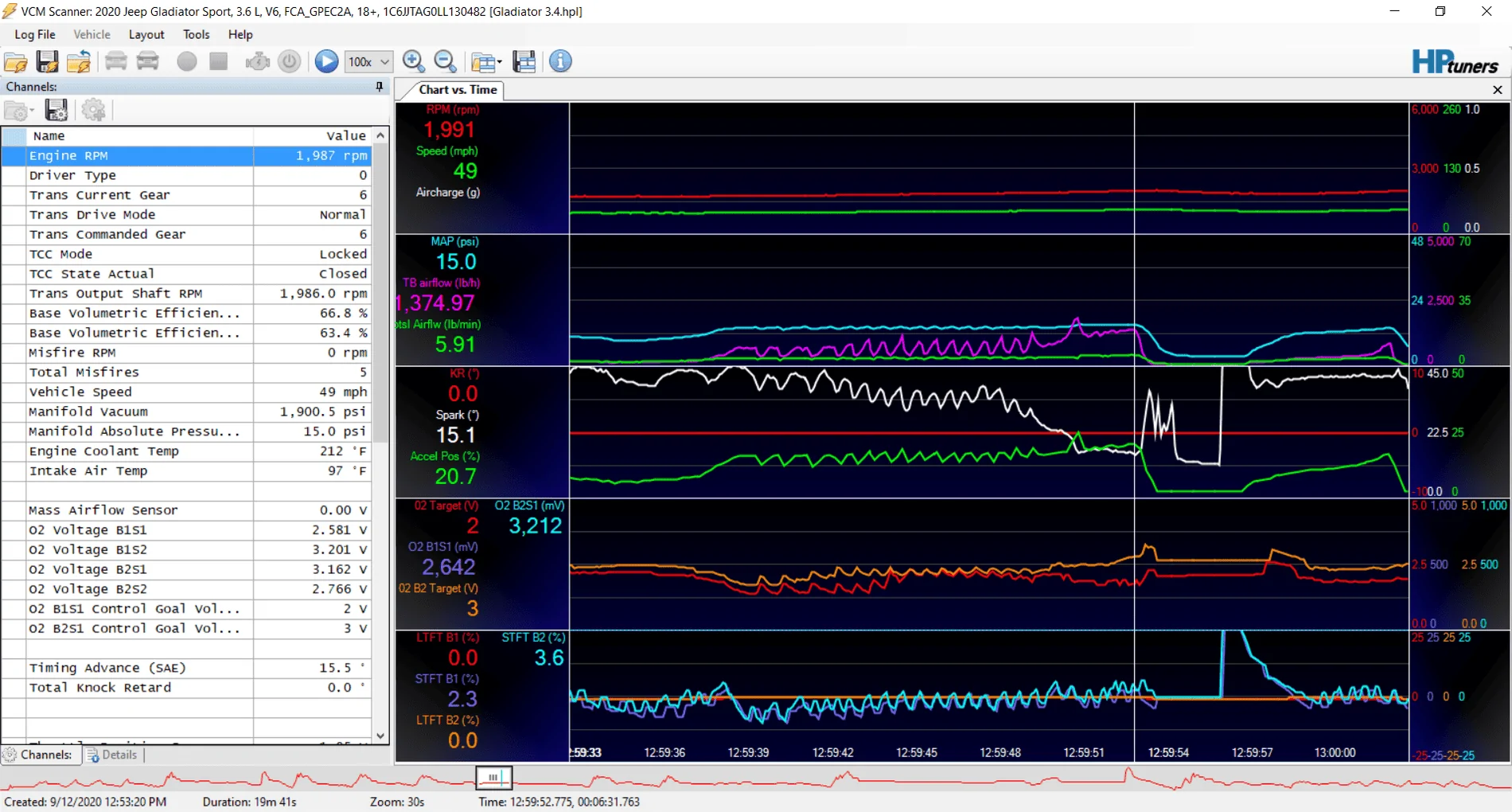

The closed loop air flow model that controls the throttle body and fueling inputs, definitely has some issues with staying in bounds and under control. I have been logging this alot lately, and I can make it pop an ASS light on command. The throttle body can go into oscillation at steady state cruise or warm up. The pcm seems to have no answer for this, most controls will have an out of bounds on a closed loop control and do something to limit or correct the behavior. Those oscillations jump the timing all over the place, making the engine believe it has a misfire. I imagine if the engine does this enough it can be tuff on the variable cam timing components also, as it moves with input from the airflow model. I have a couple graphs of this on my PC, I will try an post of any one is remotely interested.

THe first picture is warm up oscillation. THis happened when I put it in reverse and then let the jeep coast out of the drive. THe bump in reverse is what started the oscillation. Once I shifted to forward and applied throttle it got out of the oscillation. The second is light cruise. If you have a steady throttle foot when the engine goes to light load, it will toggle map and then the airflow model takes off until there is a change or triggered ASS light. This behavior seems to happen when the airflow model has values for throttle position and actual mass airflow that are extremely close to real life life values. If you alter the air flow values to about 20% less than real life this does not happen but the throttle feels a bit jumpy. I imagine FCA is hamstrung by the fact that changing this model requires OK by the EPA. Notice during all of these there is no actual misfire. The timing is just super erratic, making it feel as if that is occuring.
Jeep Gladiator Survey- For those with misfire issues Warm up oscillation
Jeep Gladiator Survey- For those with misfire issues cruise Oscilation

You aren't kidding on the oscillations - that's obvious on first glance.
If it was slower, it might feel like a lean surge. At that speed, it's throwing things into a tizzy and would feel rough - rough running.
