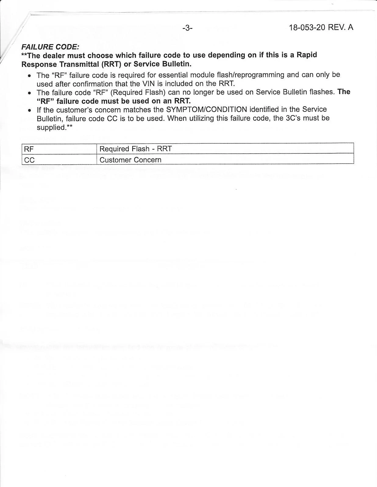

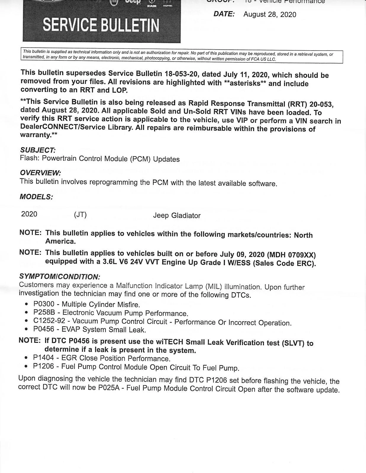

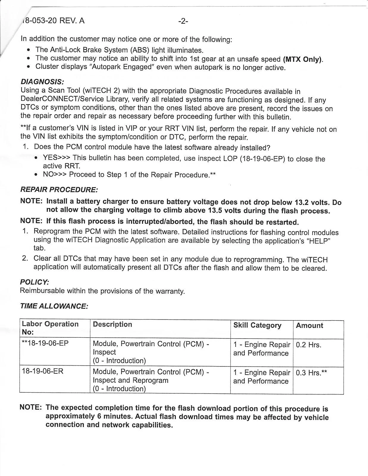

Last week I had my JT in for the steering TSB. While in the shop, they also updated the PCM using TSB 18-053-20. It is also list as Rapid response transmittal (RRT) 20-053 dated 28 August. It is a flash of the PCM. Seemed to smooth out my JT engine's performance.
A note states "applies to vehicles built on or before 9 Jul 20.

Let me know if you want the second page of the TSB
That's the same TSB/PCM flash I got on August 28th and posted about the day after. It made my JT feel like it had a small tune on it. For me, the multiple cylinder misfire (P0300) came back shortly after as well as a pending P0304 (cylinder 4 misfire). I hope it solves it for you.

That TSB in regard to the PCM flash covers vehicles built on or before July 9th, 2020... so I'm guessing they found what the issue was and corrected it from July 10th on. We're not seeing every case of this. I'm sure it's much more widespread than we realize.
The problem is - and I have ASKED dealers, unless I have an indication, rough running, a light or error, they won't simply perform a TSB like this one. I asked. They said there's no codes and it's not running rough, they don't simply update software without an indication of an issue.
I asked them specifically about the PCM flash - nope, we don't do that, there were no indications of a problem.
I personally think that any time there's a software update, it should be applied if the customer asks, but they won't.
