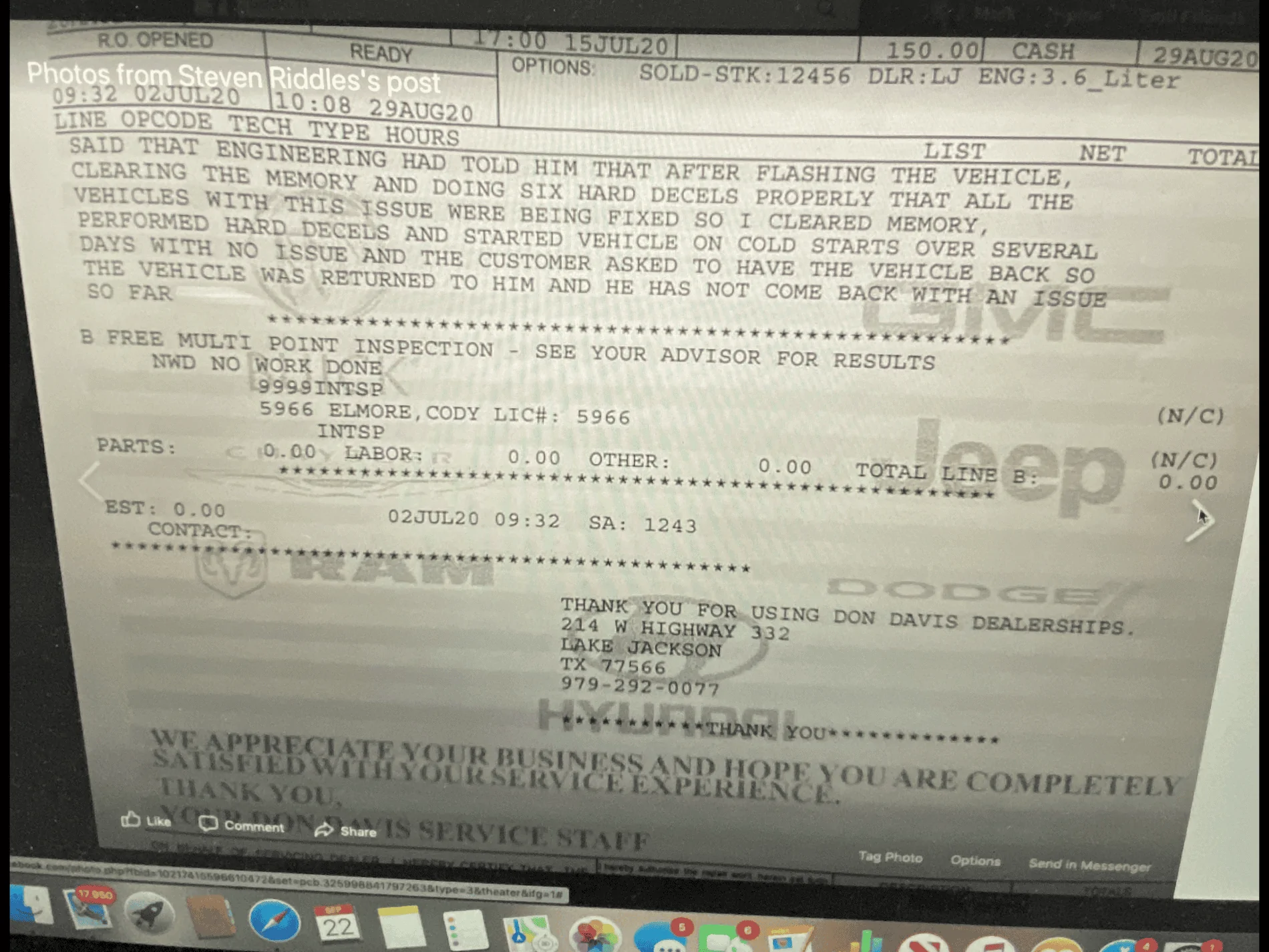

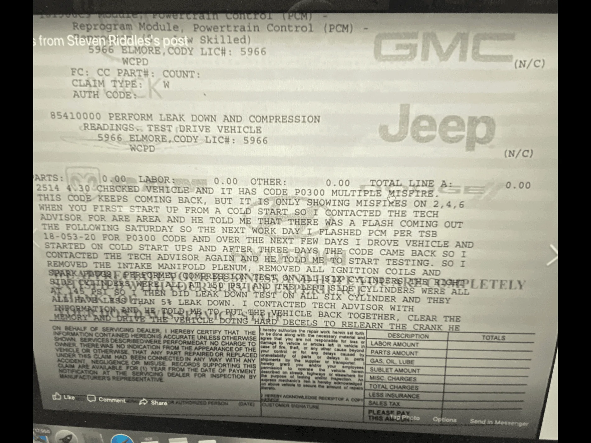

How does one do a hard decel? Manual downshifting?

I am surprised they noted that.
Om my second time in, I was told that they had been advised to go through several rough accel, decel cycles as if to try and set rings that were not fully seated.
Sounded weird to me but they never documented it.
If those rings aren't already "seated" - it's a bit late. Glazing and other issues will be present.
That's such an old-fashioned belief that on an engine with hundreds of miles on it that you can fix the rings that way.
According to DANA/Perfect Circle, they are broken in within the first 100 miles.
To me it acknowledges that they believe there's a physical issue - rings are not round or the cylinder is not round.
A compression test then a leak-down test would confirm any ring issues.
Further, it's the full load higher gear acceleration that forces the rings out against the cylinder.
Pressure DIFFERENCES force the rings outward, so you want really high combustion pressures, seen with heavy throttle high gear accelerations. Since you can't get more than 30" of vacuum, that's not a lot of pressure difference between the crankcase and the chamber.
Maybe I need to show some of these guys the books I have that discuss this - from the engineers at Dana and GM and other companies.
It's not the shops making this up. They are getting orders from enginerds in FCA corporate!
40,495
54,056
That's scary. It's grasping at straws, IMO, unless they showed a compression loss - or higher than normal leakage past the rings in a leak-down test. Still, expecting that to resolve the issue is really odd. I expect that sort of response years ago.
What the heck - take the thing up to speed and force a downshift and wind that puppy up and peg the vacuum gauge a few times............ get it over with so they can fix it.
