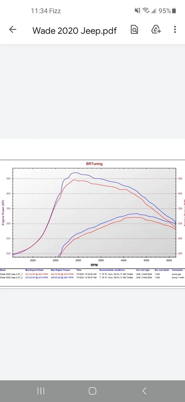

When he said the v6 roars like a v8 I figured it was all bs. Comparing back to back test drives in stock JLs at nearly sea level (georgia) ignores all the ways where the 2.0t was far superior. They are close on paper at sea level, but run them at 10k feet and the 2.0t has an ~25% advantage. Where's the best wheeling? The mountains. Who cares about a broader power band when you've got an 8 speed auto? Both are in the power almost immediately when you get on the throttle. Slightly better fuel economy stock turns into a huge gap modded. Driven the same on 37s we get 11-13mpg from the v6 vs 17mpg from the 2.0t. That's 40% better fuel economy. Of course being boosted is easy to turn up the power. These dyno runs are wheel hp from nothing but bolt one and a JB4 piggyback controller. That's more wheel torque than the 4xe or 392.
Jeep Gladiator Swapping out 3.6 for the turbo 4 ? 1633465741435
Not that I'm advocating for the swap idea, just put in a hemi or LS/LT.

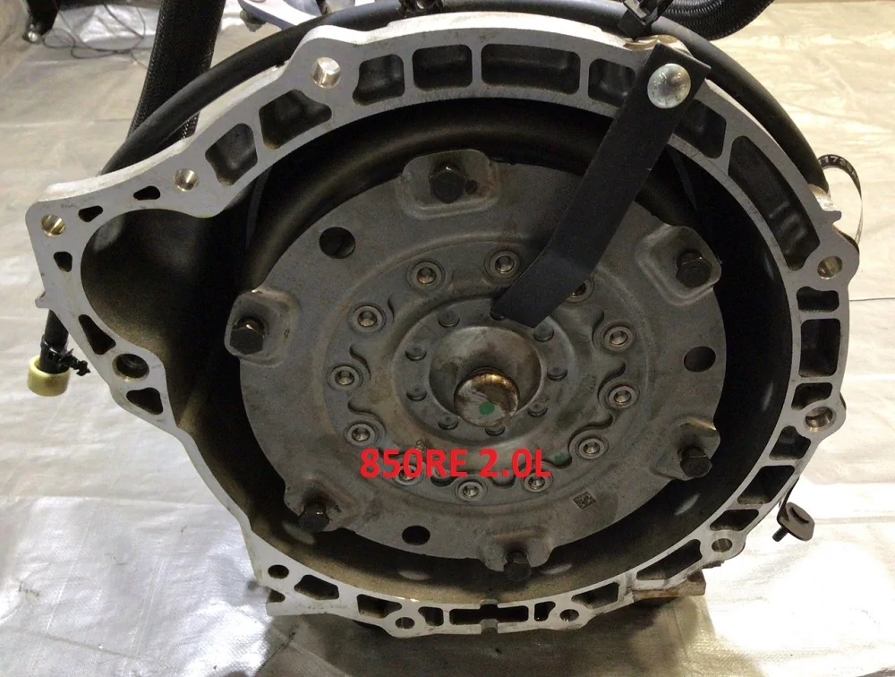

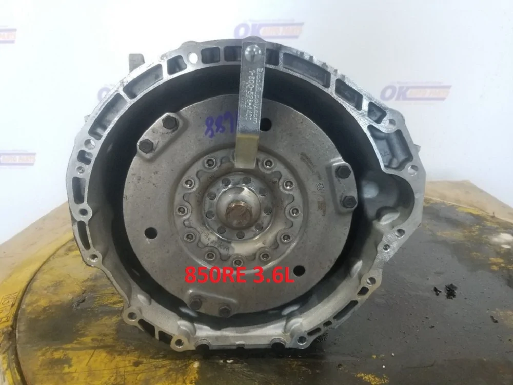

In my opinion if a 2.0T swap was to take place it would be fraught with bugs & how does anyone know if the rear of the block casting & bell housing pattern is even the same .
That is a good point. I had to look into it and while they both share a 850RE transmission, the bellhousing is way different with mainly the starters are on opposite sides.
So any swap would mean an engine and transmission. IMHO, one would need a wrecked salvage JL for a donor to get all the bits and bobs as I am sure it would require a few more things.
Great job looking that up. I figured there would be something different didn't imagine it being that drastic. But yep the entire drivetrain wow that would be a monumental undertaking for anyone without alot of tools, lift, hoist etc..
The torque coverters are even different
