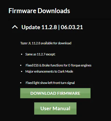

First, you should probably upgrade to version 11.2.8, which has been out for a month.
Then follow Patrick's advice in post #38.
