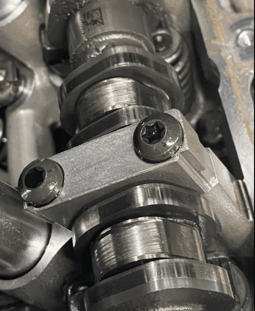

Well look what I just found on Facebook. It is happening folks, and the sad thing is it is almost undetectable until the damage is done. If you are having a rattle you need to have misfires logged on your Engine for each individual cylinder when ot is revved beyon 3500 rpm at 50-75 percent load.
Here is what I found. There is a variable lift oil solenoid in the front of the valve cover. At Idle to 2800 rpm it is off and supplies oil to the number 1 intake rocker. Once you get over 2800 RPM it turns off and the rocker is spring loaded to go to full lift. The problem I had, is the ECM turned it off but the oil kept flowing so the high lift lobe was never getting activated and I imagine has done this to my cam. There is no diagnostic or sensing measure for this failure. The 3 and 5 cylinders are on a different solenoid.
So rocker problems as they where in the old 3.6 may be solved, but this is a whole new level of mess.?

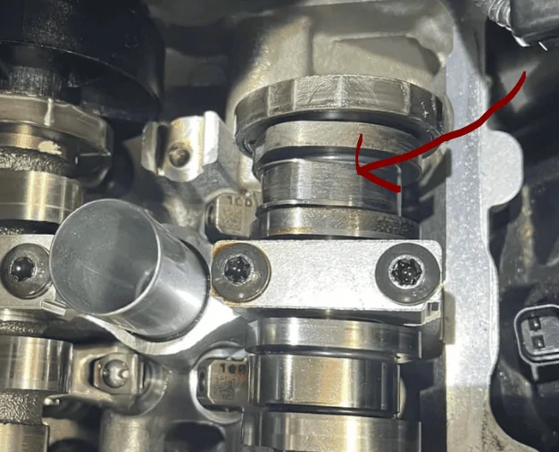

What are we looking for in those pics, Dave? I don’t see anything with chunks taken out, no shards or shavings, and no major scoring, so I can’t see where the problem is. Enlighten us less educated Neanderthals please!

No major scoring? Maybe the problem is you need to open the pic on a computer and not a phone? Seriously, the lobe I've pointed to with red arrow is toast, worn badly and some scoring showing it was under a lot of pressure with no lube, or had crazy forces acting on it (like a bound valve spring. This used to happen when performance builders used high-lift cams but didn't allow for the spring compression and the coils bound up)

Look at the top righthand highlift cam lobe.

Man your freaking me out SP, cause in these pictures it does not look like it is relegated to one cam lobe. Yours looks to be on the opposite side of the engine!!

Oh man, my eyes skipped right over that. I wasn’t looking for damage that extreme. That’s not scoring, that’s shaved clean down. I’d imagine that thing is nearly circular at this point.
So while there’s no direct indicator to watch for this, I take it that logging for misfires and coming up clean is a good sign that you *aren’t* suffering from the problem?
