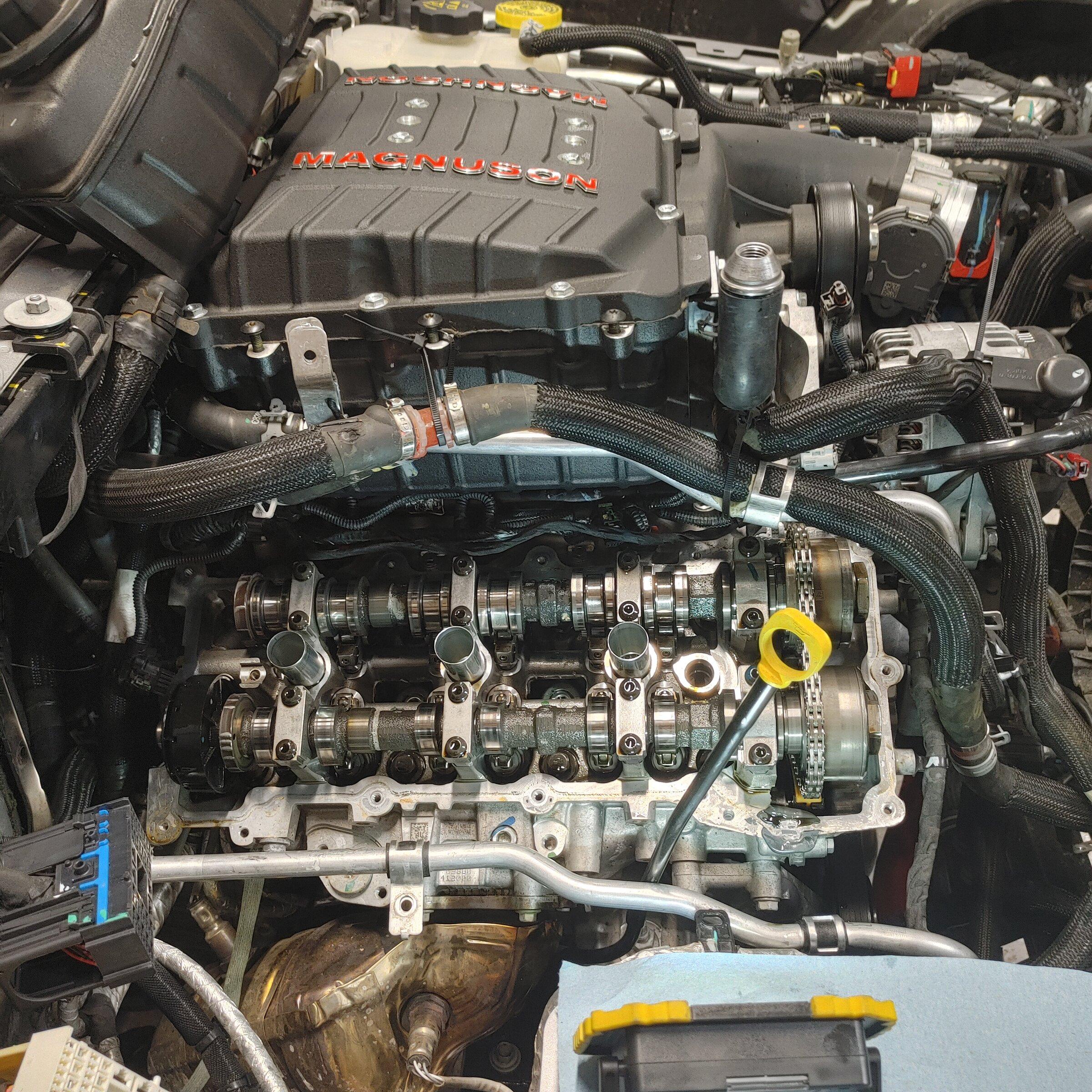

I believe what you are saying is that this sneaks up on you............ they can tolerate a lot of wear and not "misfire" - but I'd bet the trim tables would have to be off? I mean, if you aren't letting in the air, or letting out the exhaust, aren't you going to see the thing trying to compensate by changing the fuel going in? Intake lobe badly worn, valve not opening like it should, less air going in so the normal injector spray would be too much for the air that did get in - and the PCM would try to trim it back?
Time for another coffee - maybe it doesn't work like that - but if you can't get the exhaust out (in cases of worn exhaust lobes) or in these cases, the intake valve isn't opening and letting enough air in, won't that trigger a mixture change? The O2 sensor readings would have to be off.
On old engines if there was a badly worn lobe or the lifter caved, it would pop - BANG - back through the carburetor.

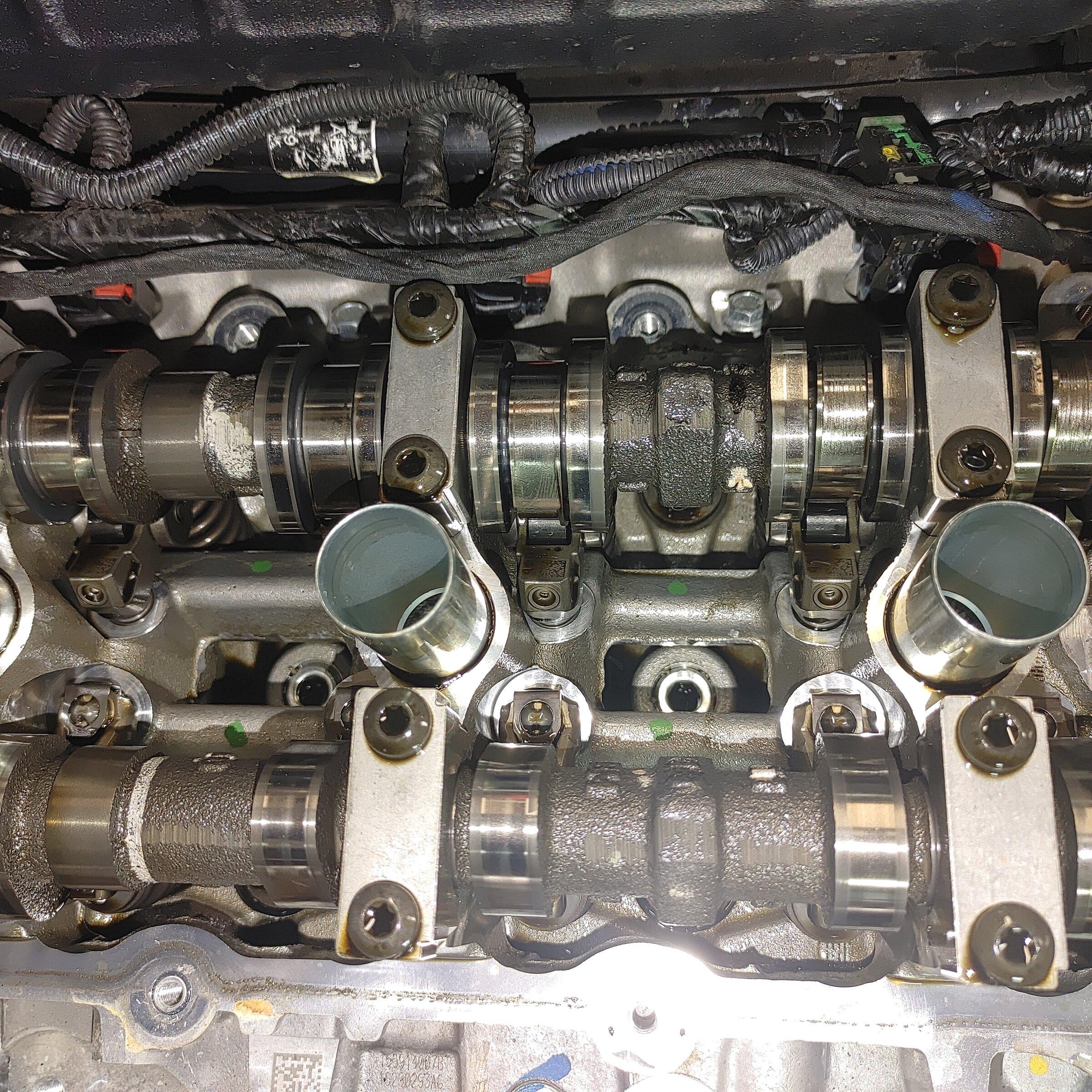

So here is the issue. The only part affected is high RPM on the intake valve. The lobe in the middle you are seeing worn down, is the high lift lobe. As your engine crests 2800 RPM a solenoid shuts off the oil sent to the rockers to activates a valve in the rocker that deactivates the high lift lobe. Then the rocker and intake cam run on the outside skinny lobes from idle to 2800. ingesting fuel and air as it normally would. Once you crest 2800 a solenoid in the head shuts off the oil and the the rocker spring loads the center lobe and locks it out, to ride on the center of the cam. If that lockout does not happen, because the solenoid will not close or the rocker is broke, then the center lobe does no lockout and it rattles around making noise and messing up the lift profile for that valve, as it is a mix of bouncing high lift lobe and riding on the low lift lobe.
Also how do you flag a diagnostic on a solenoid that has shut off but not closed?
SOooooo basically the intake cam is the only cam affected
It is only affected above 2800
It still opens at high RPM but the profile is drastically altered and erratic
The VVL solenoid may work sometimes, but if your cam is wiped now your just grinding your cam.
SO anyone could have this issue right now and you may never know until you drop the hammer in your truck and it makes some weird noises and possibly trips a misfire light.
You will chalk it up to bad gas or a hiccup and continue to drive grampa style, as metal courses through your engine.

Reading this thread reminds of the 5.7 Hemi MDS problems causes by bad solenoids that controlled the oil flow for the lifters. That it wiped out cams and lifters too.
Luckily the hemi crate engines do not utilize this solenoid

Really sucks. I have spent so much time getting this to run fantastic. I love the power, the response, the whole package. I just drove my mustang the other night and I like this performance better. But this cam thing is a ticking time bomb

The problem is you may never know when it fails until it fails catastrophic. If you drive normal most of the time you are not in that rev range very long. Who says it is not my harness or ECM drive not working well with the solenoid. Maybe I have low level stand by current or EMI than hangs it open.
Honestly there should be a pressure sensor after that solenoid to confirm it is functioning correctly. Otherwise it is a roll of the dice!

If you have a rattle STOP driving your truck. It is a bad cam!!!!
