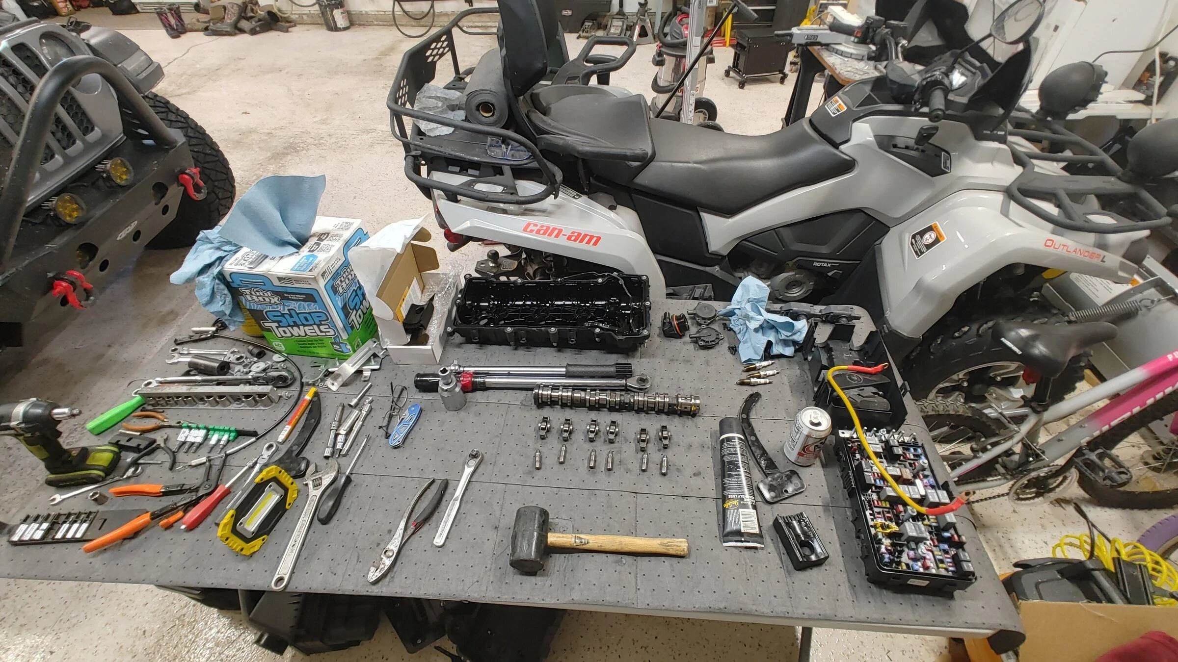

Well it is going together. Also you know how I know I am old? I have a layout table lol

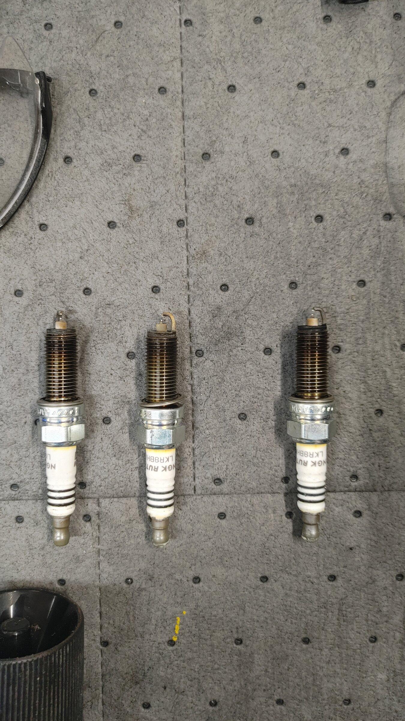

The fueling looks pretty good on these plugs!!!!

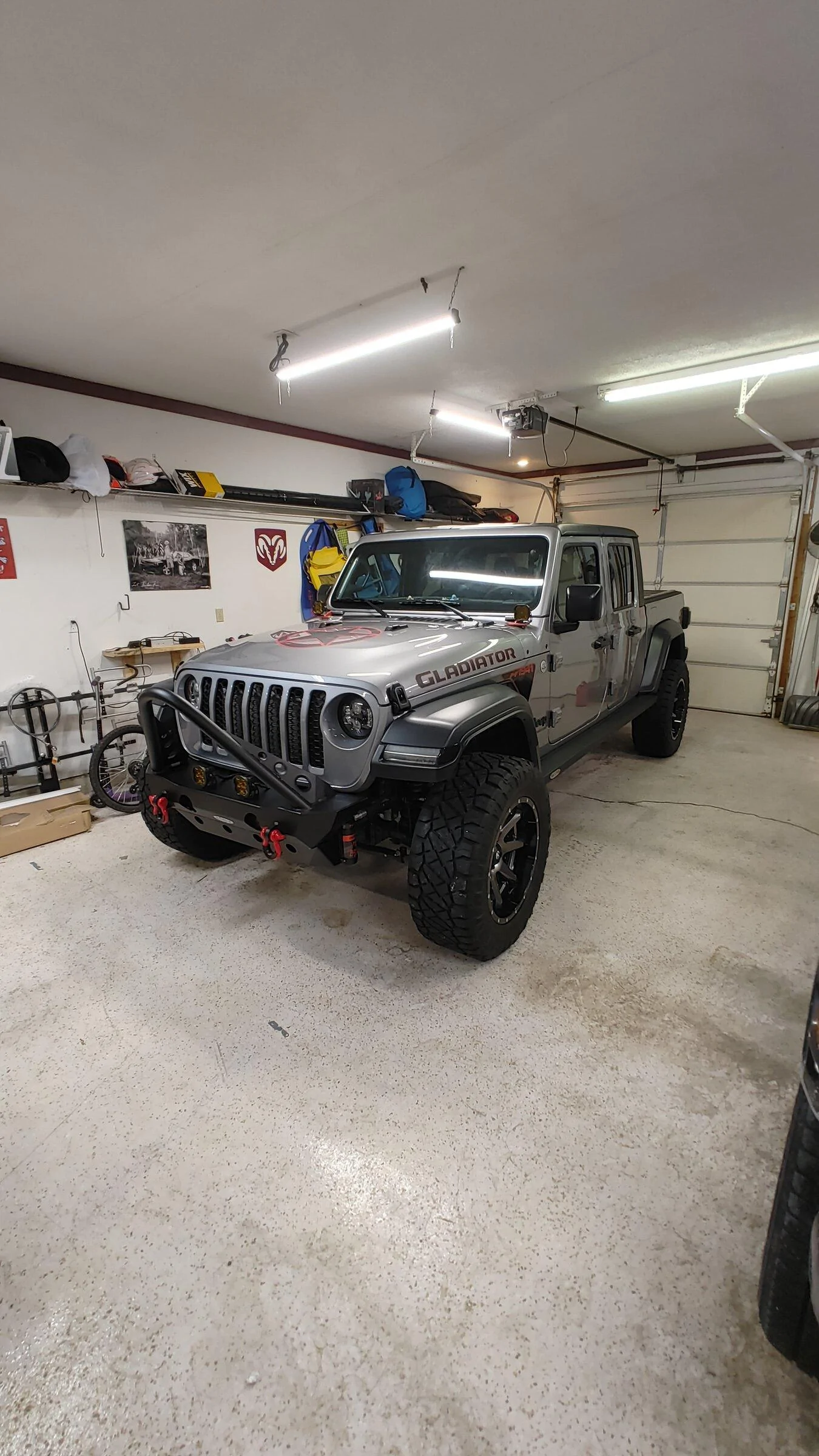

Well I put about 35 miles on it today. With the new cam and hardware, it is so mellow off the line. The tune was good news. It was running a bit on the rich side. My guess is, being in highlift all the time, it was consuming more fuel until the lobes wore down. It felt more aggressive before, but now things are very smooth and predictable.
The really good news, I kept going back on tunes and when I finally hit good fueling, it was at bit before the small pulley split. So standard pulley tunes should be good.
Small pulley guys I have an update. You are running rich around 5700 rpm. I have your names recorded with your current tune ao I will start Monday with sending out updates. I apologize guys, never would of imagined my engine was assembled wrong.
I drained the oil and cleaned the pan surprisingly it was pretty clean, I guess the oil filter setup is good!
Man jeeps are a bit of work to keep them A1?
