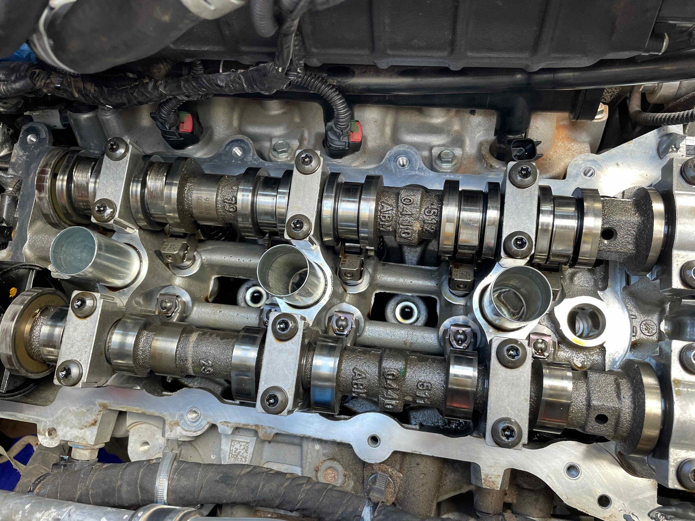

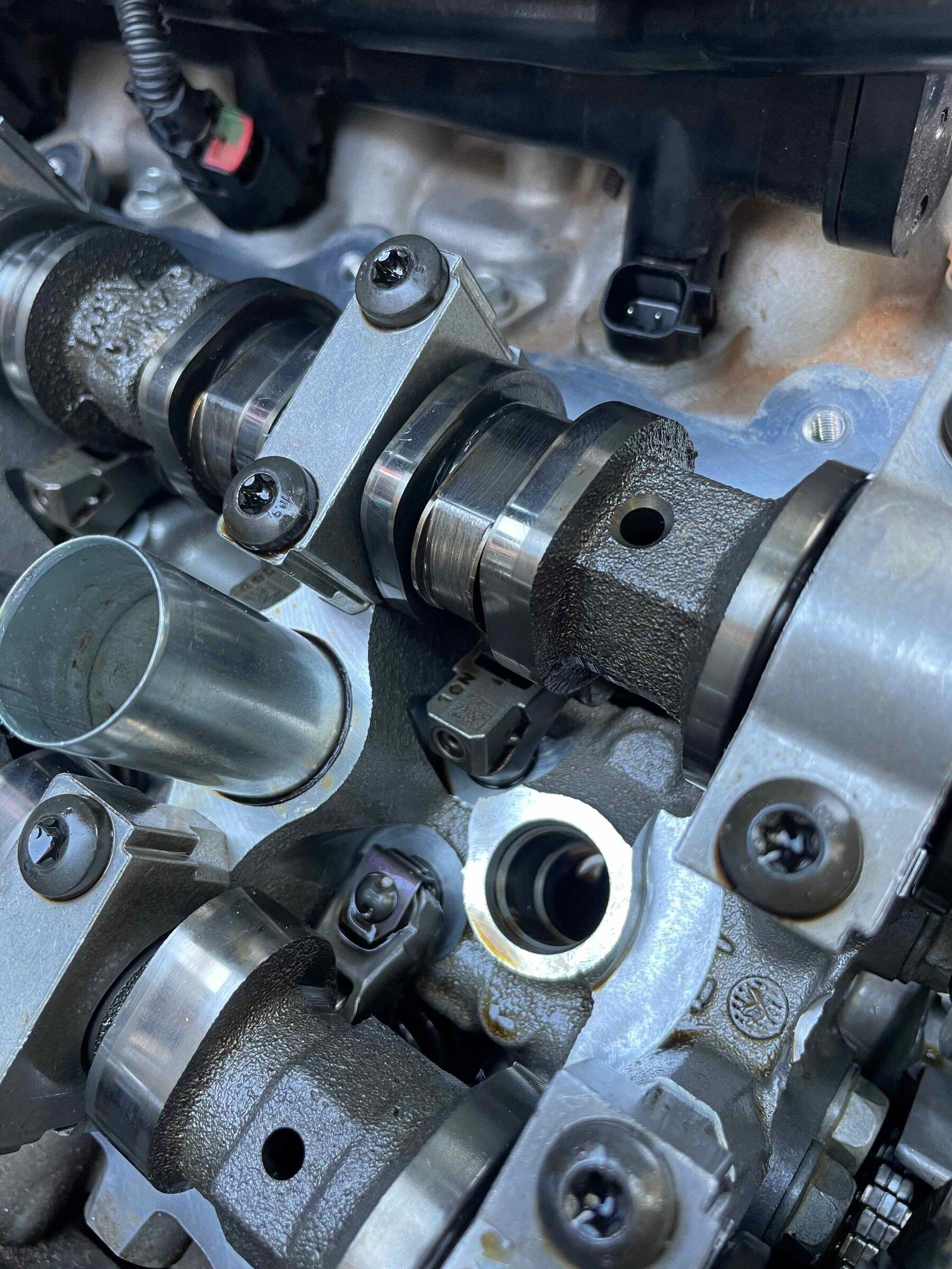

Hi David - been watching this thread with interest from Australia. I have a 2020 Gladiator Launch, also with a Magnuson blower on it. Done less than 35,000 miles.
Pulled the timing cover off Bank 1 (i.e., passenger side in the US) and my intake cam looks exactly like yours did!! Symptoms were a more constant rocker rattle (especially while towing); and then a code with a Bank 1 Cam 1 fault (P000A).

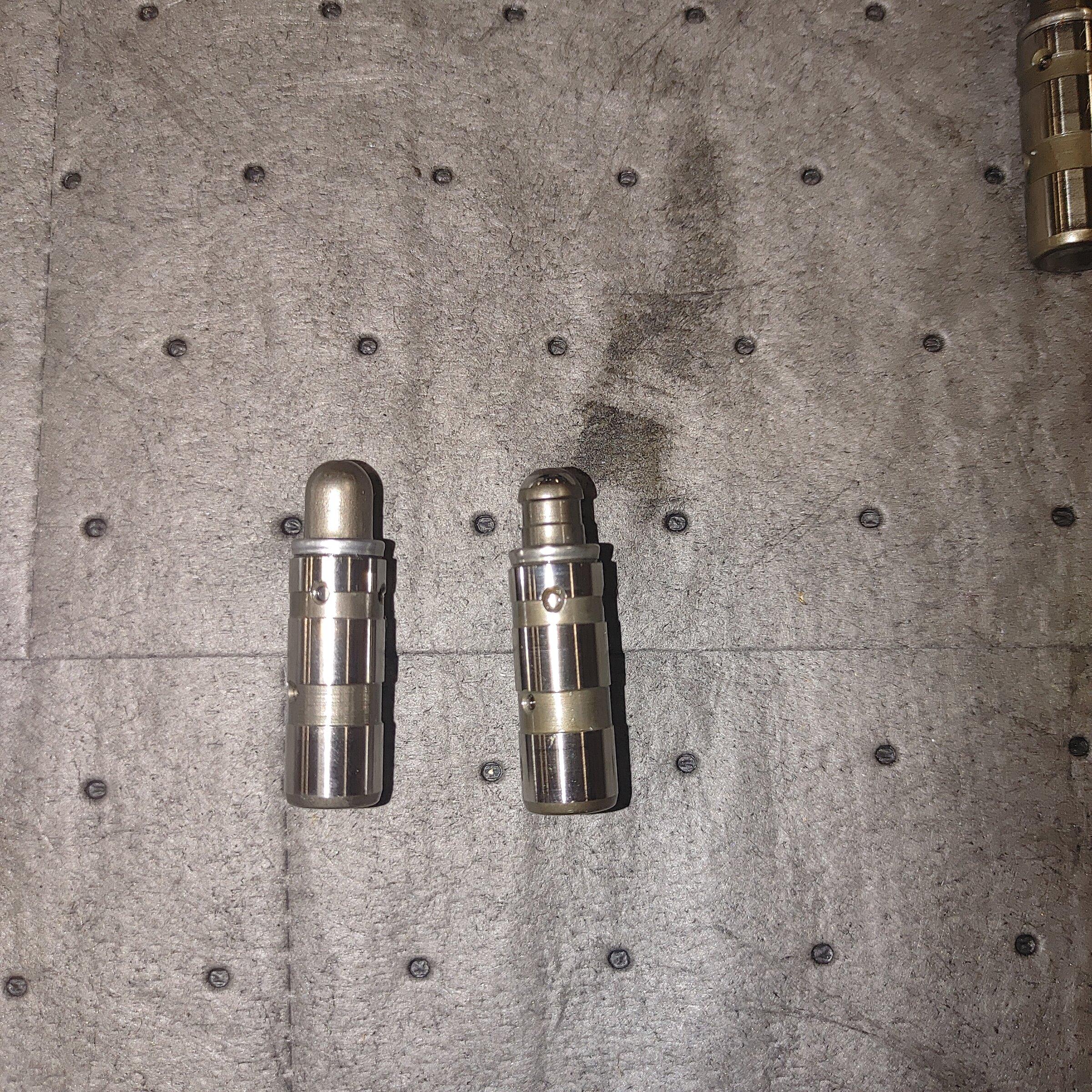

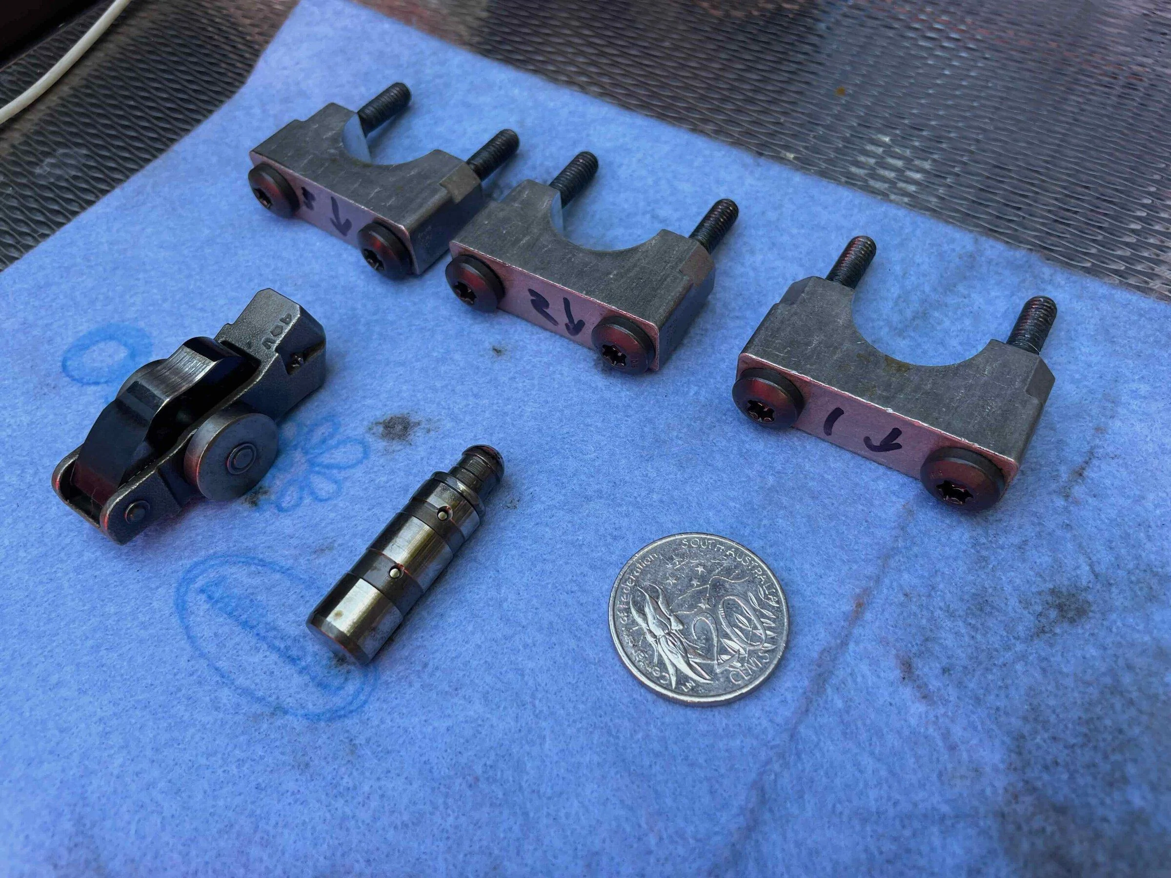

Below is a picture of a lifter - just to confirm, from your research, does this look like an exhaust lifter (which I removed from under the intake cam)?

As per post above... the centre lobes above all 6 intake valves are toast; as are the rockers

Just got the pictures. You had the wrong lifters installed on your intake cam. You can tell by the machined groove in the head. Intake lifters are completely smooth. What sucks, is how do you get Jeep to own up to it?, has nothing to do with being supercharged, it has the wrong parts in it.

The one on the left is what an intake lifters is suppose to look like. The absence of the groove helps keep the rocker seated and the oil from escaping as it is pumped into the lift mechanism of the rocker. The intake rocker does not move as much as the exhaust so no need for the extra lifter clearance.
