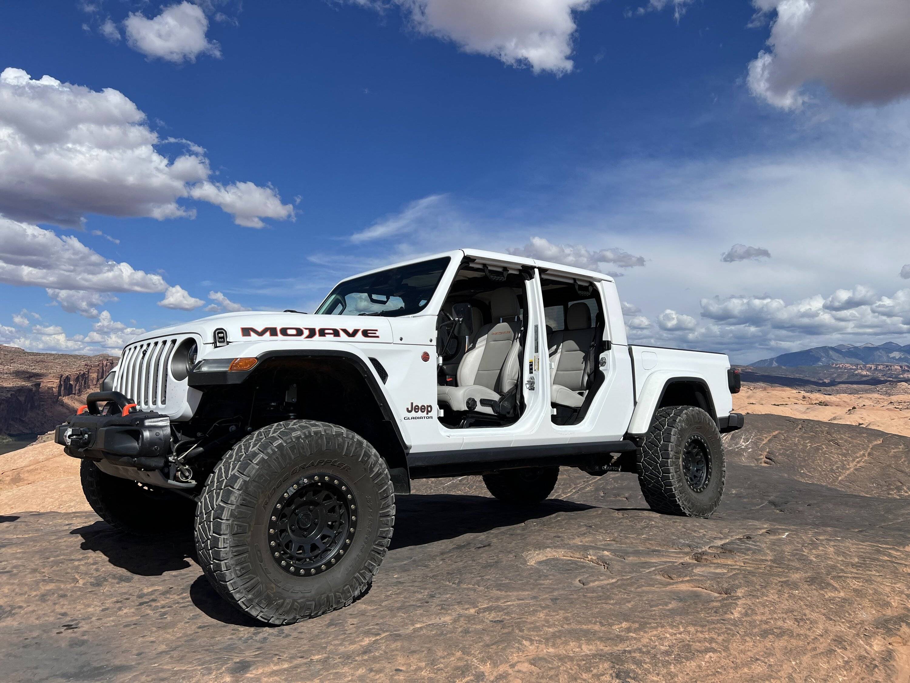

Your build looks great! Video in Moab shows the capability of your Jeep.

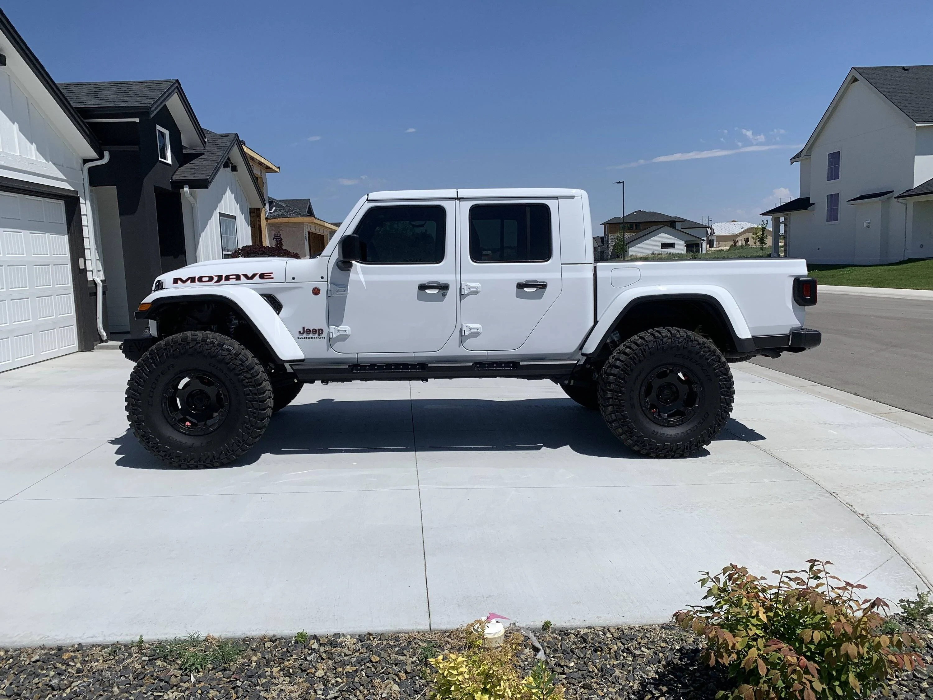

Hey nice ride installed the same Clayton lift but I ended up selling the fox shocks really did not like them with the new lift and with the money from the sell bought teraflex 3.3 adjustable and love them. Also got the teraflex adjustable stabilizer which is great especially with my 40’s. I drive the freeway at 80 all the time and hit pot holes no wobble and surprisingly 410’s push the 40’s no problem but will be regearing and getting a elocker same time Hopefully soon. I get compliments on the ride all the time people are surprised how good the ride is.

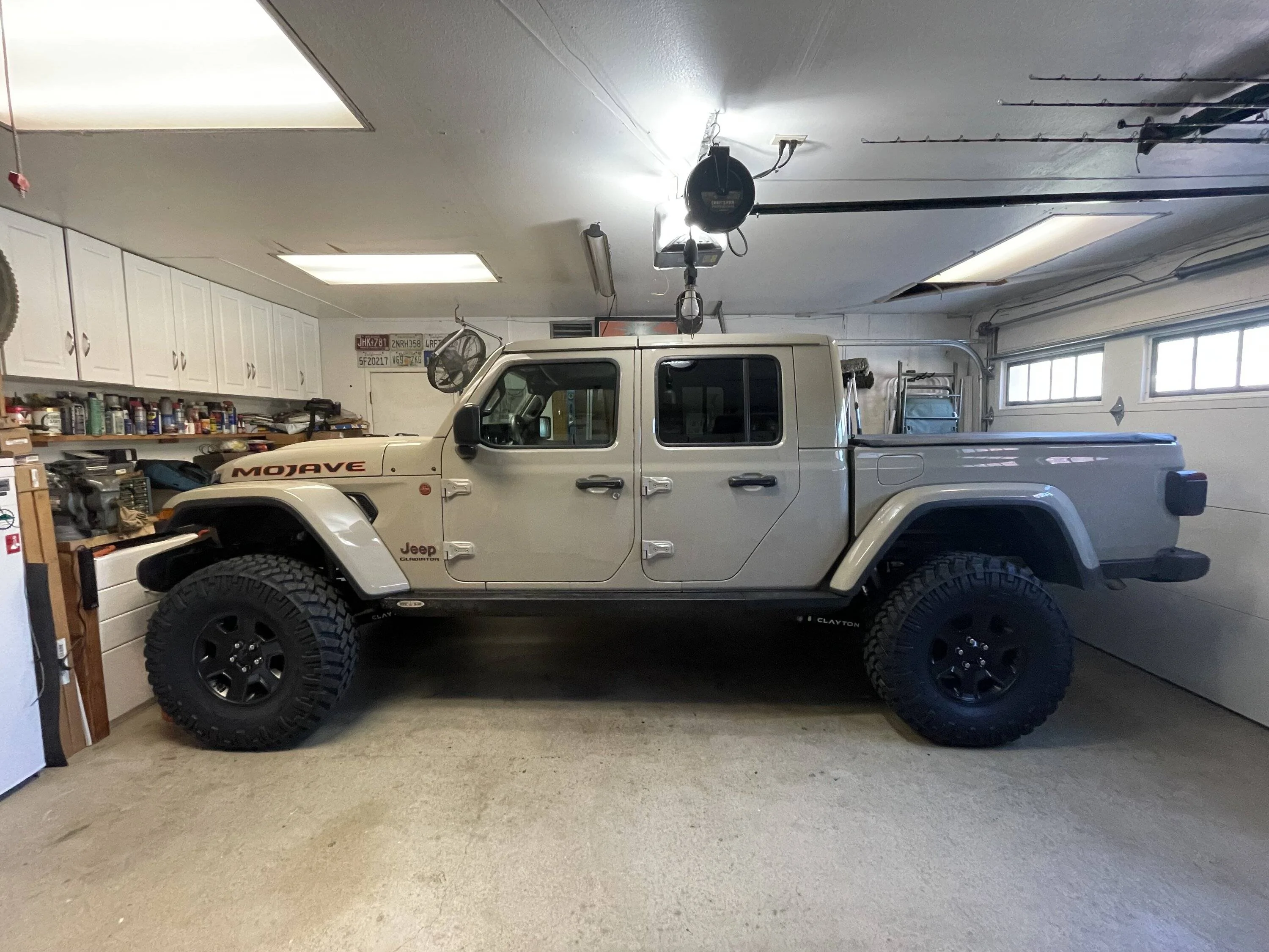

Sorry to hijack- what Fox shocks did you have? I just finished the install of the COR 3.5 Overland with the Fox 2.5 DSC’s and still trying to adjust them to ride close to the JTM Fox bypasses. They are bumpy on the roads.
I had the stock fox 2.5’s with reservoir. And with the teraflex 3.3’s I have them at 2.4-2.8 on highway.
