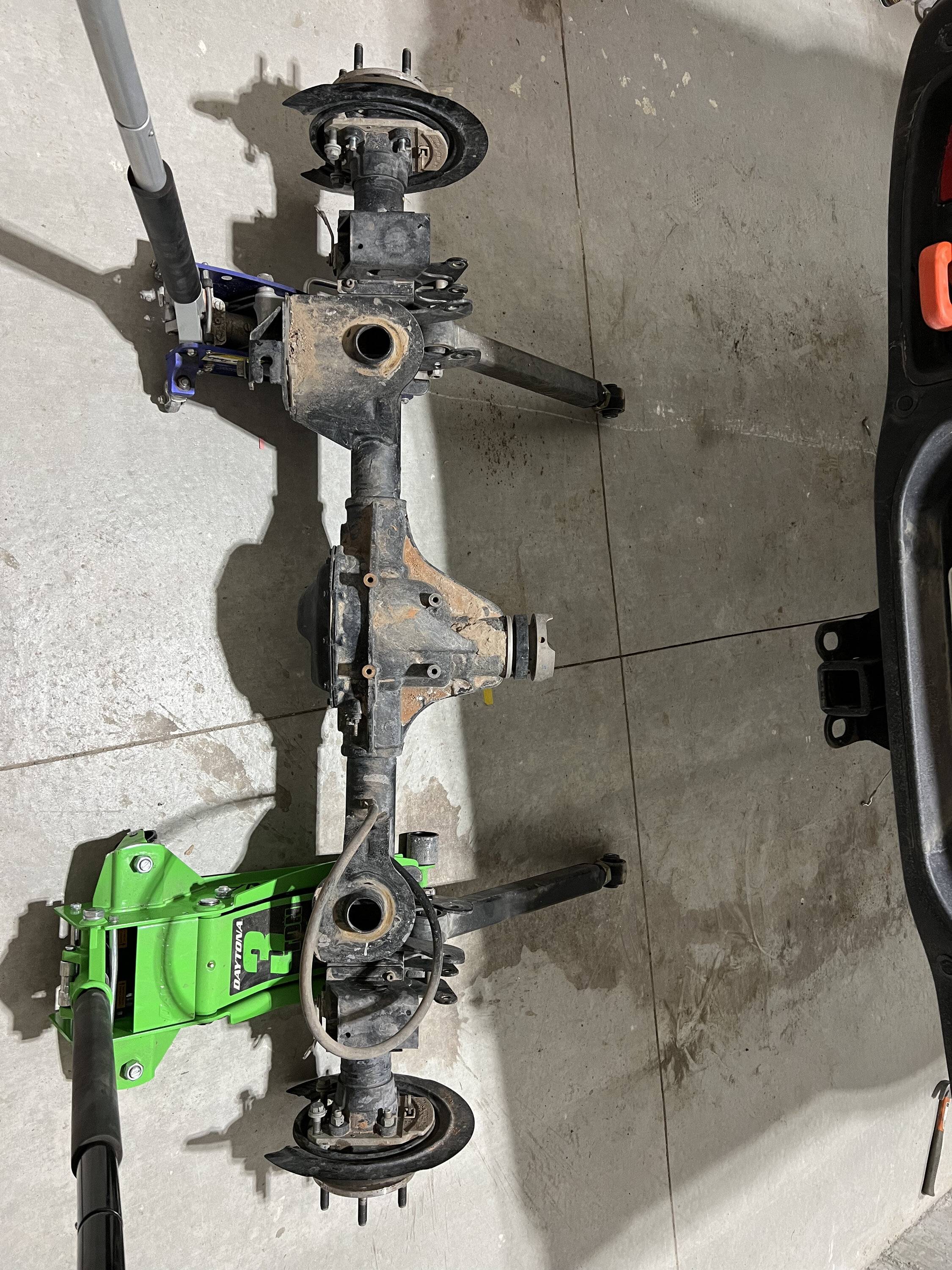

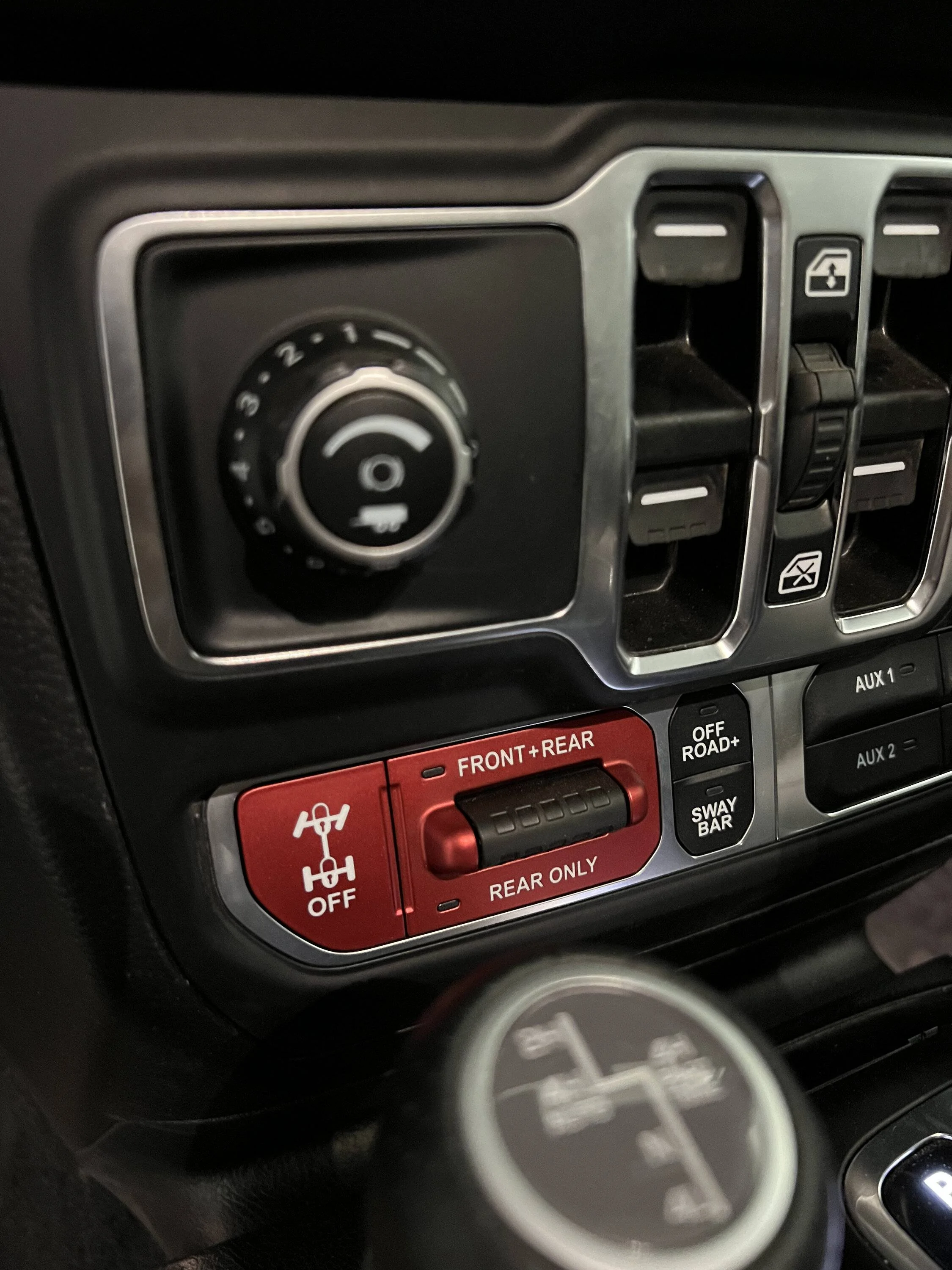

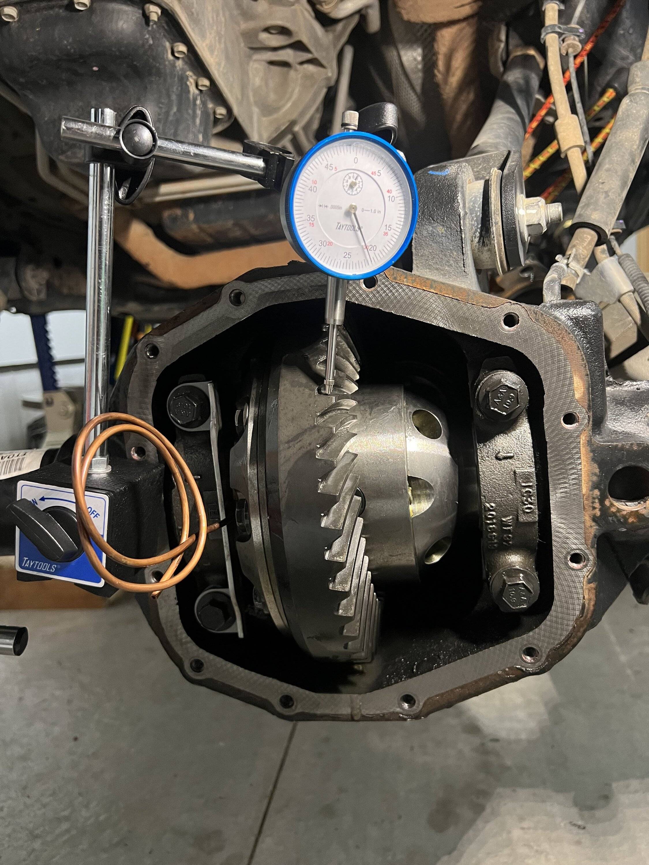

Regear to 5.13, ARB Air Locker (Front) w/ OEM control, Synergy Springs
What a project! After many hours of research and learning, I tackled the project of regearing The Mojave. I added an ARB RD245 air locker to the front as well, and swapped out the too-stiff-for-me Clayton springs to Synergy (4" front, 3" rear").
  • Yukon Gear and Axle 5.13 gears w/ master install kits front/rear (YGK069)
  • ARB air locker in the front since the Mojave doesn't come with a front locker (ARB RD245)
    • Wired up to a factory Rubicon off-road switch following this thread as a template. Made my own circuit board to mimic the OEM locker signal.
  • Synergy Mfg Springs
    • 4" in the front and retained my previous 0.5" spacer and other lift parts from previous posts. 3" in the rear to maintain level ride.
    • These springs ride so much better for me and match the Mojave OEM shock tuning so much better than the Clayton springs. I don't fault Clayton - I just don't carry a huge static load all the time.
I'm really excited about having a front locker and frankly to be done with this project. It took me many hours and towards the end I was really wishing I had just paid a shop to do it, however, the things learned are invaluable to me. AMA!
Jeep Gladiator The Mojave JT - Build Information & Journal IMG_6361
Jeep Gladiator The Mojave JT - Build Information & Journal IMG_6828
Setting up backlash

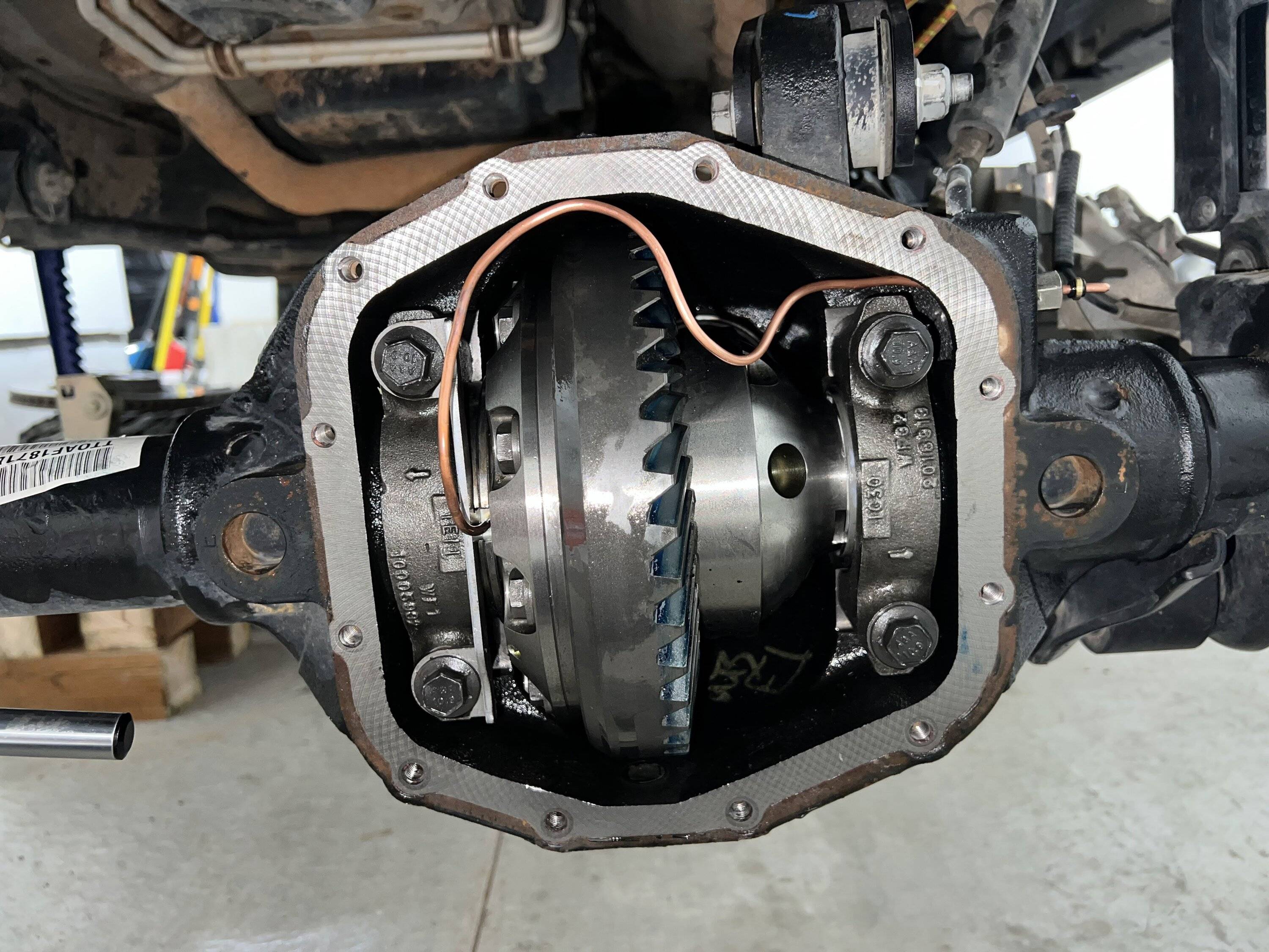

Final setup in the front

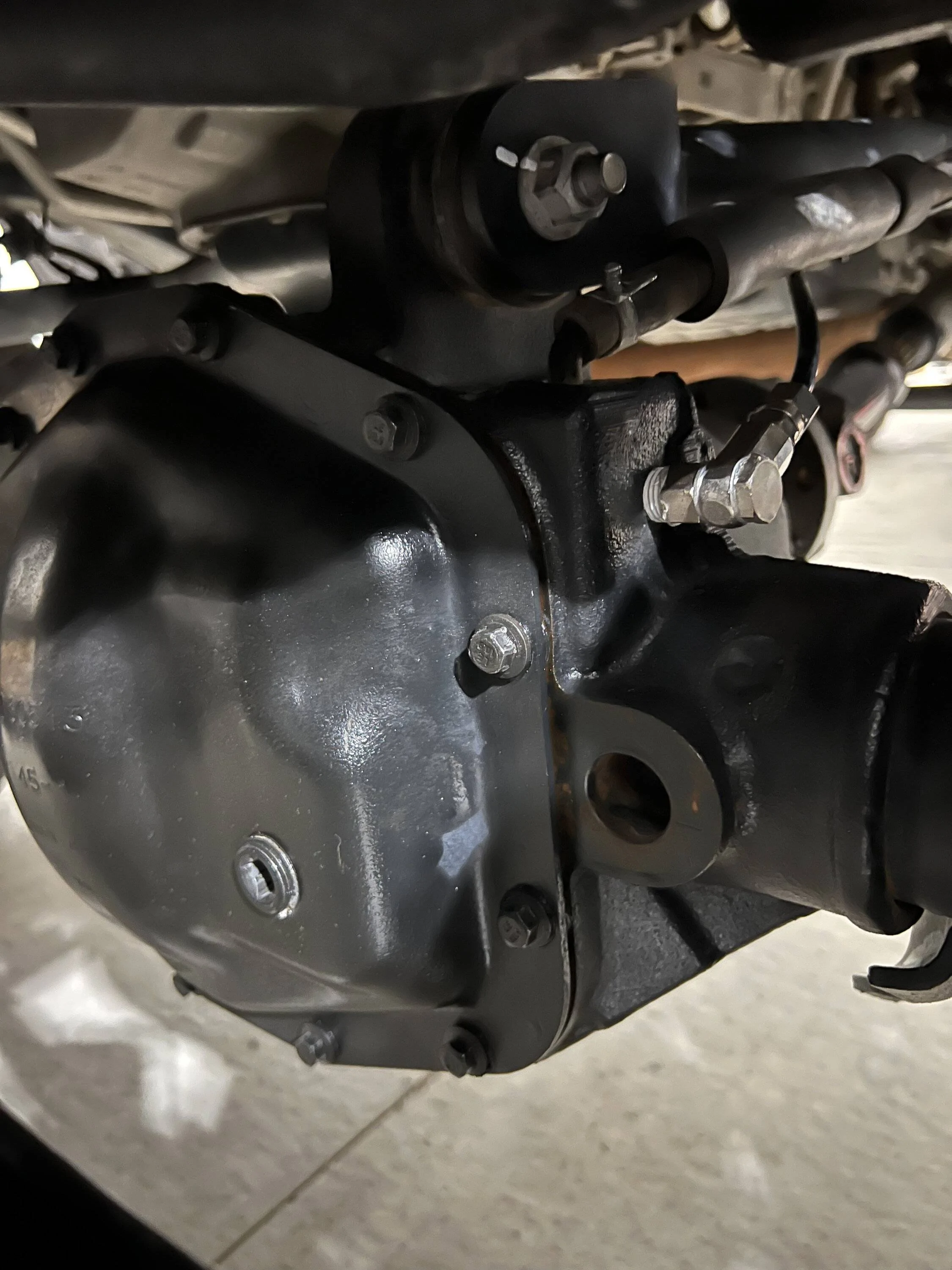

Air line coming out of the diff housing

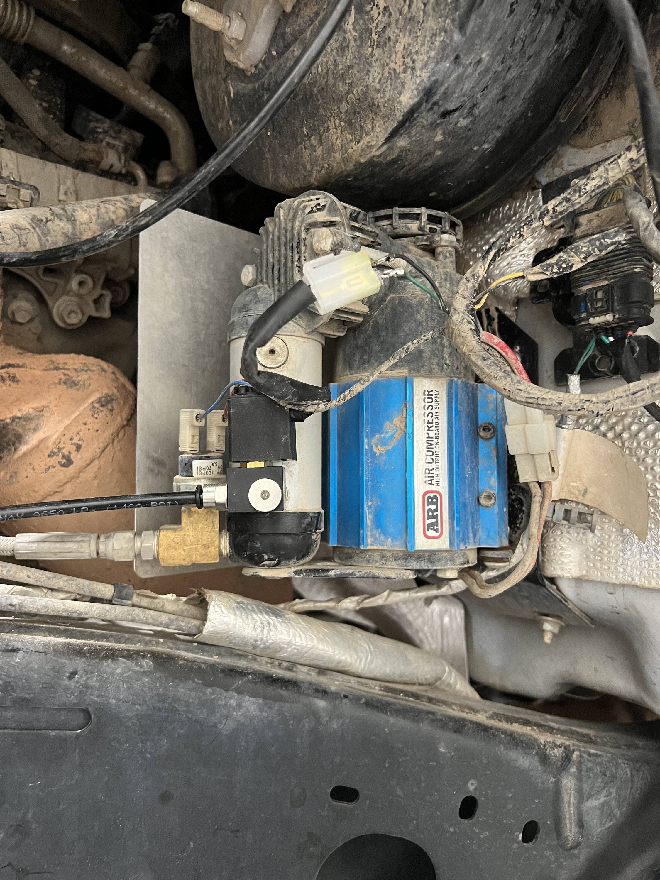

Existing compressor hooked up to locker air line. On the right-hand side of this photo you can see the electrical plug where I've added the wiring to control the front locker using the OEM switch.

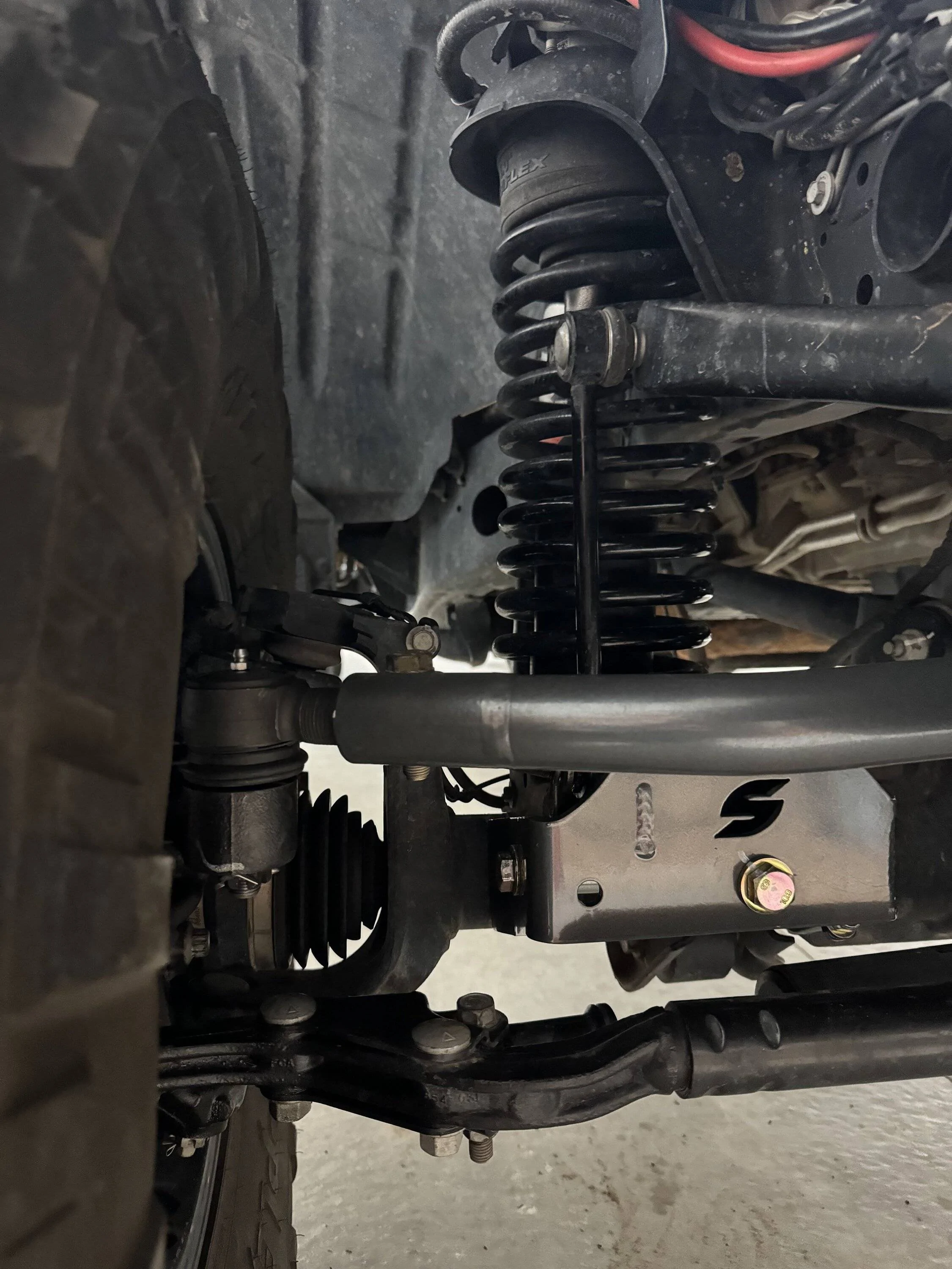

December 2023
High steer/drag link flip and track bar relocation - Synergy Mfg.

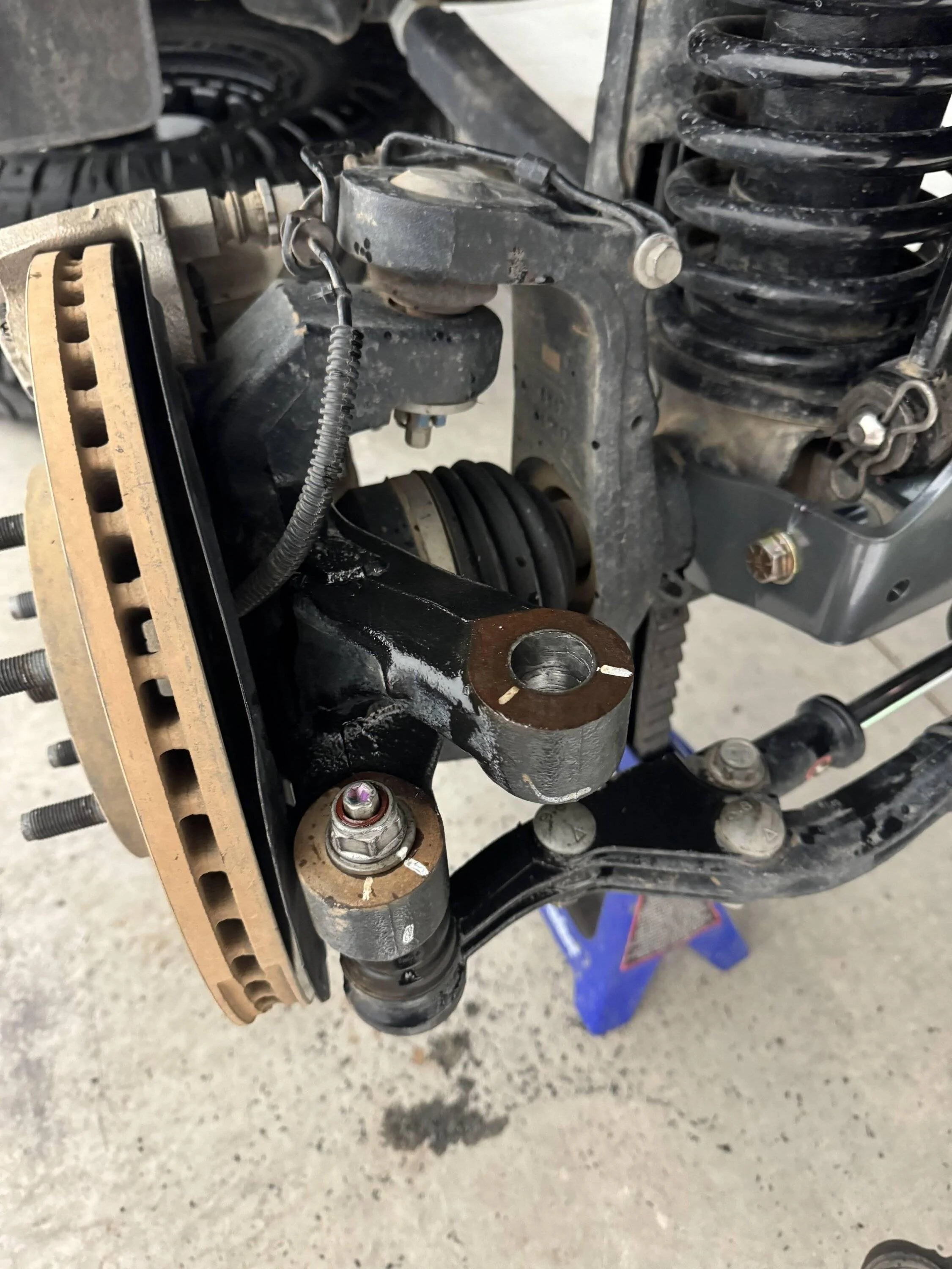

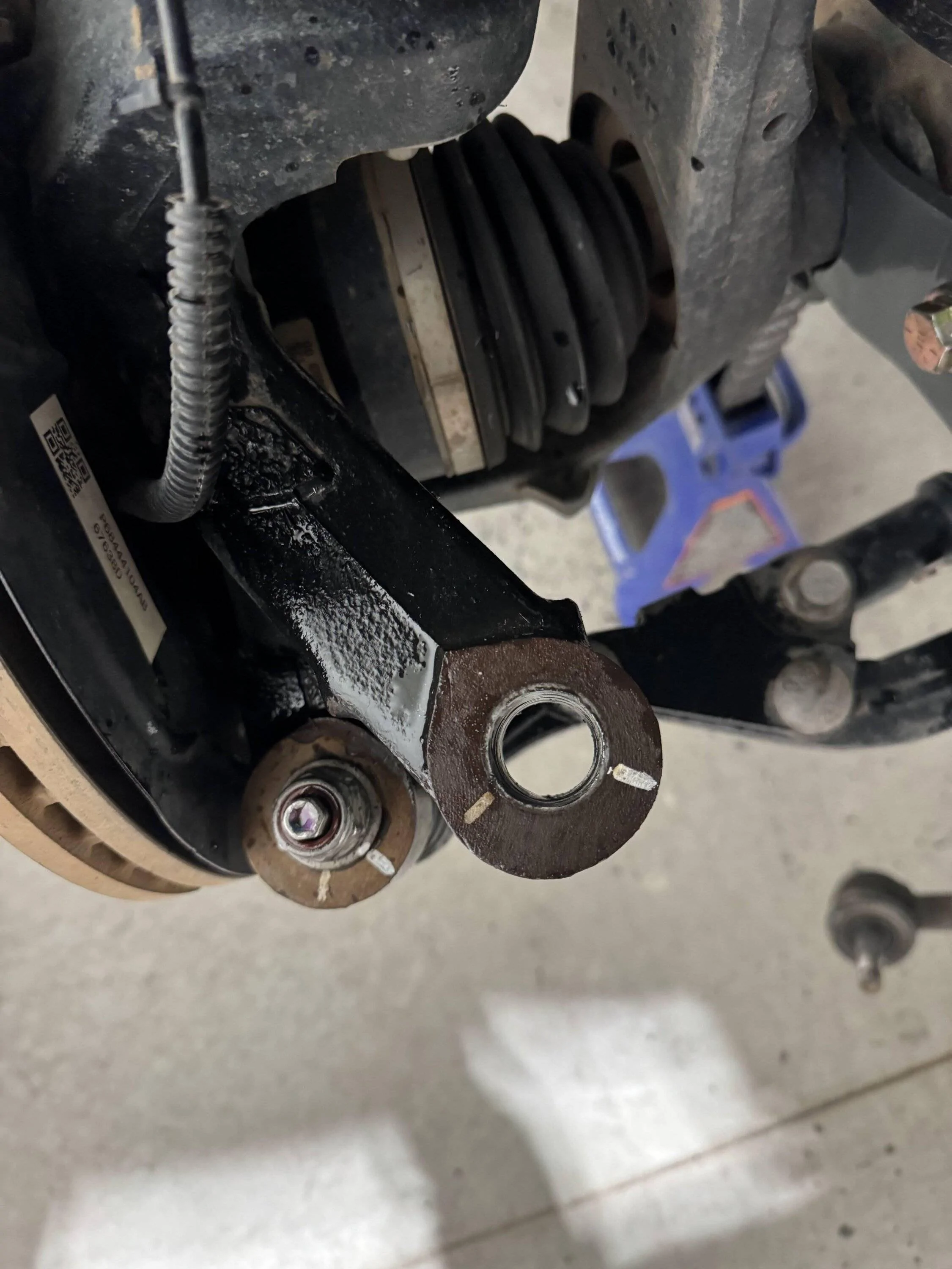

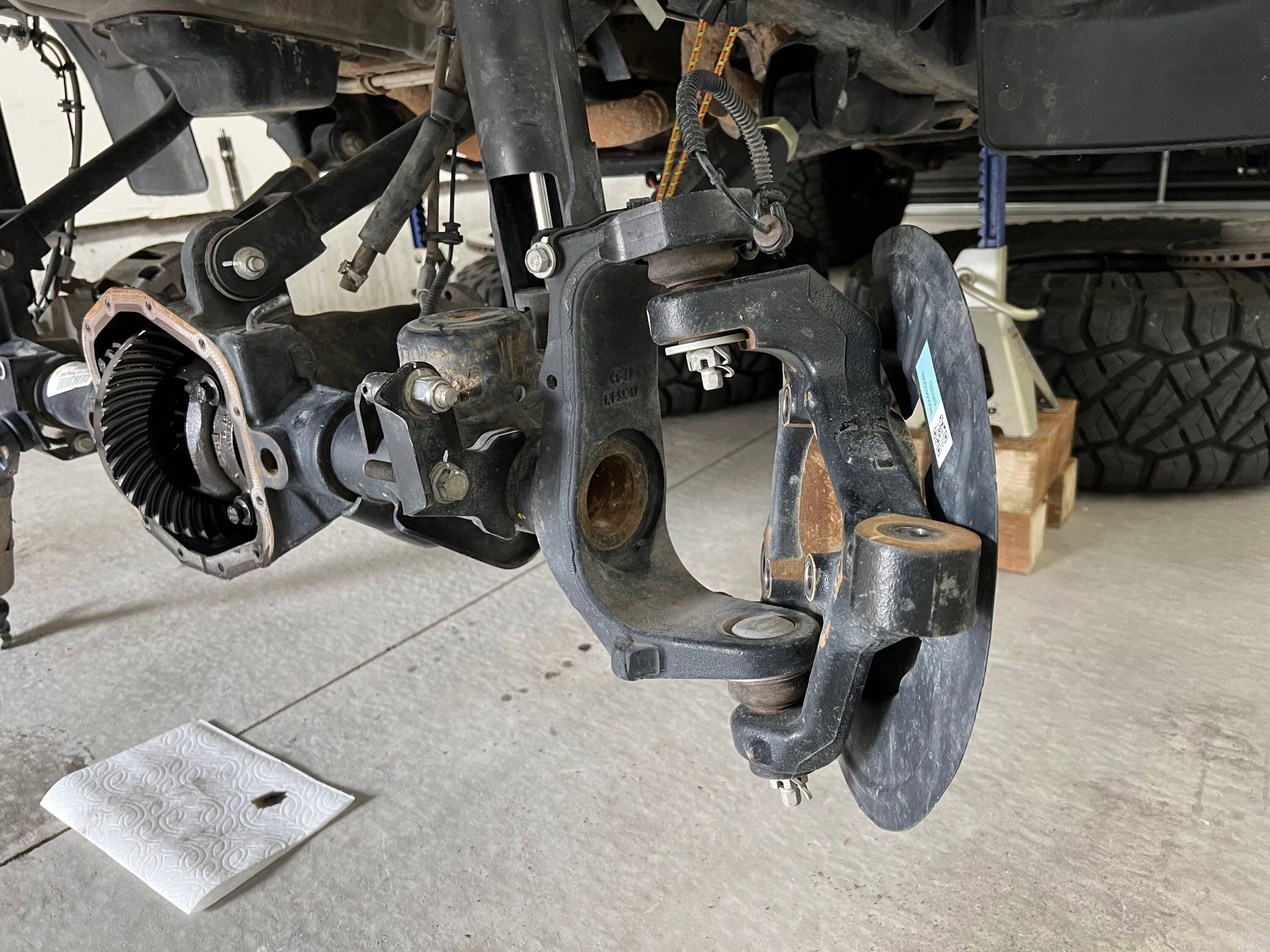

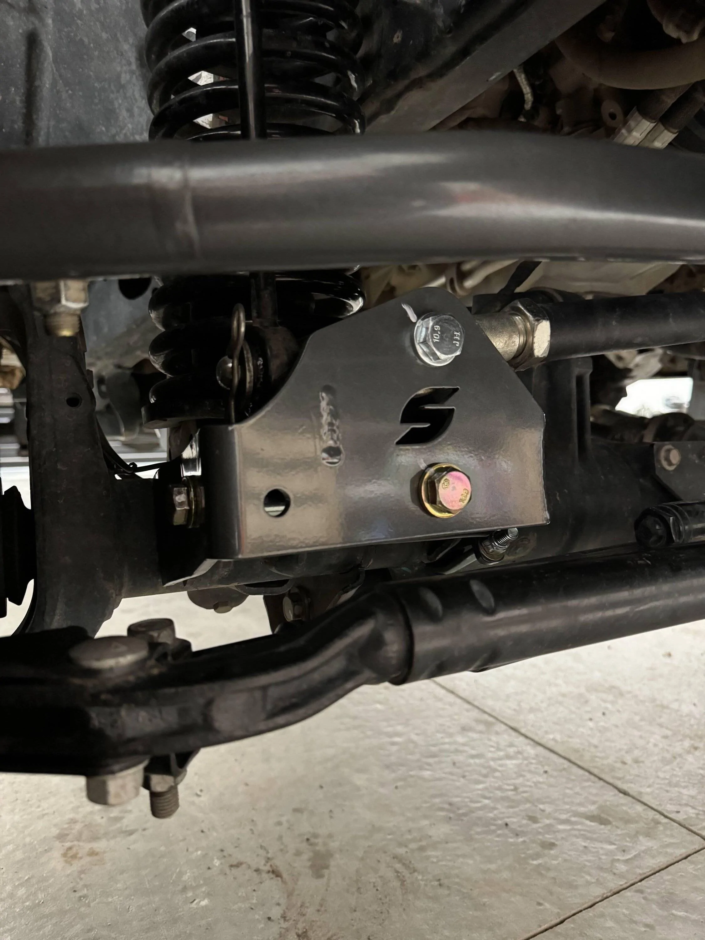

Although my Gladiator drives pretty well, it doesn't drive quite as well as stock. One way is when going over a diagonal crack, such as a driveway at an angle, or a bridge seam on the freeway. The Jeep "lurches" side to side or diagonally. I figured this was due to the steep track bar angle and horizontal left-to-right axle shift as the suspension compressed.
A few months ago I damaged my stock drag link on the trail and replaced it with a Synergy drag link. This month I purchased the Synergy Front Track Bar Relocation Bracket and installed it this week.
I have to say, the problems described in the first paragraph are remarkably minimized! If I had known how much of a difference it would make on the road, I would have done this months ago. I think anyone lifted 3.5+ inches in the front on their daily driver should do this.
The install instructions from Synergy were thorough, and it took me about 90 minutes to do. I supported the passenger side of the front axle with a jack stand, removed the front pass. wheel, and that gave me the access needed to complete the project. It would have taken longer had I needed to replace the drag link, but I already did that a few months ago as I mentioned.
Drilling out the knuckle for the drag link flip was the hardest part w/ the Mojave's cast iron knuckles, but it went well. I used a 7/8" drill bit from Amazon. The rest of the trackbar bracket installation is remarkably simple - it's a well-designed piece.
Jeep Gladiator The Mojave JT - Build Information & Journal IMG_9394
Jeep Gladiator The Mojave JT - Build Information & Journal IMG_9395
Jeep Gladiator The Mojave JT - Build Information & Journal IMG_9404
Jeep Gladiator The Mojave JT - Build Information & Journal IMG_9405

We ran the synergy setup on our 2019 JLUR. When we decided it was time to flip the drag link on our 2022 JLUR I went with the yeti no drill flip kit from steersmarts. Much easier install obviously. Ride seems pretty much the same between the 2. We still had a bit of steering feedback over bumps that I wanted to get rid of. Decided to try drop brackets up front from metal cloak. Between the 2 the thing rides better and handles better than it did stock. Considering the drop brackets on my mojave even though ot only has a 2" AEV spacer kit they made such an improvement.
Nice. I actually ordered the MetalCloak drop brackets on Black Friday and they finally arrived today. Good to hear they worked great for you - I’ll be installing soon!
