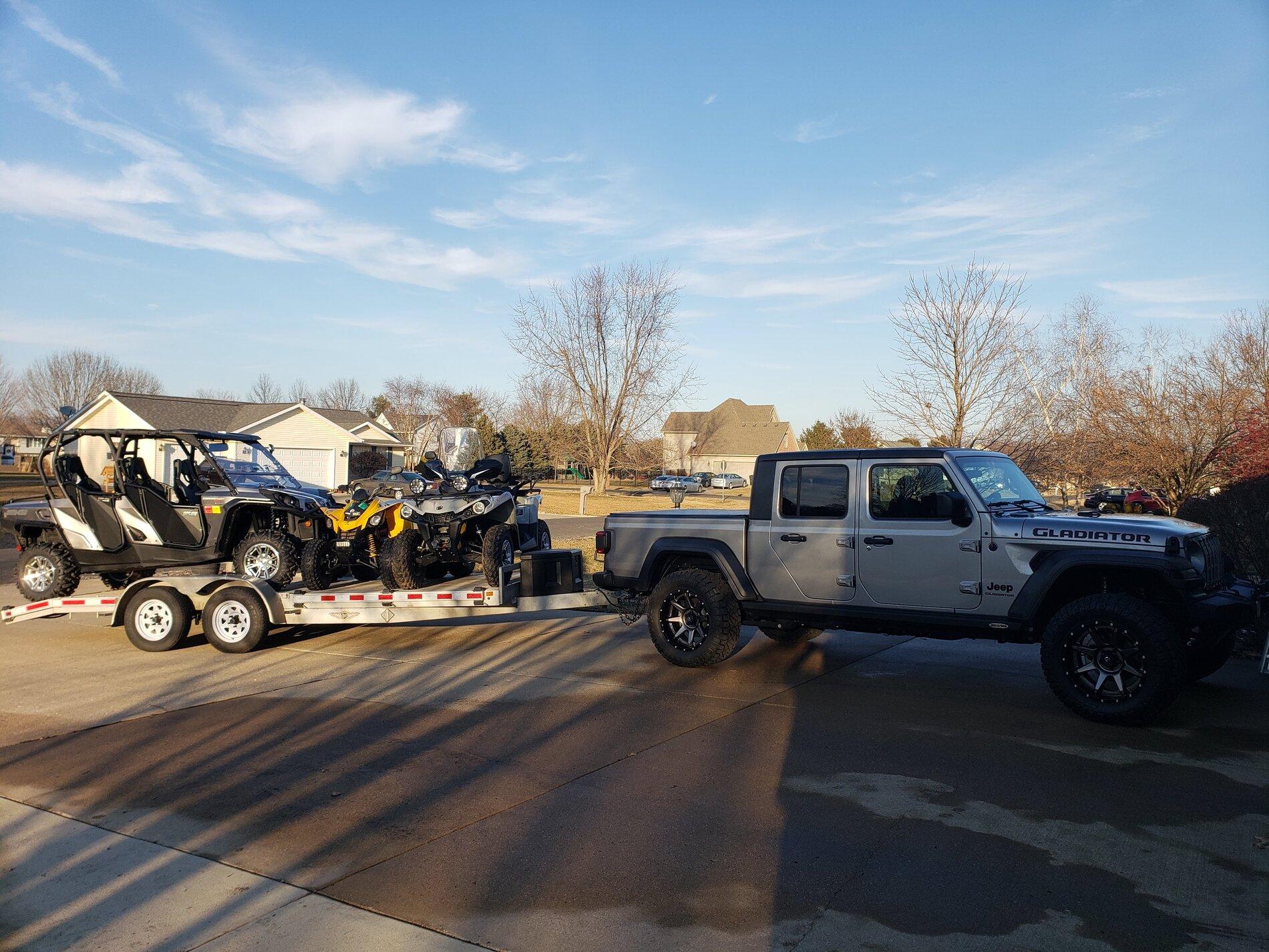

Are these 35s on 20s?
Fuel Rampages with 35x12.5x 20 Nitto Ridge Grapplers. Not my first choice as I am a bit more on the military/off road side of things,but I got a swinging deal on the combo and cannot complain about a two piece forged wheels.
