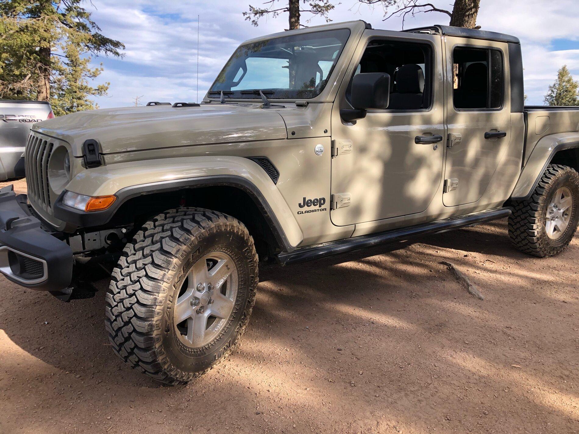

My Sport S on 33s looks great. I am a giant manual trans snob, but I will admit wheeling with the auto stick is pretty easy and gives you lots of flexibility.
Jeep Gladiator They had the capability, they made it better, stronger, faster... E82F0B14-5B5D-4963-BFAE-928D81097437
