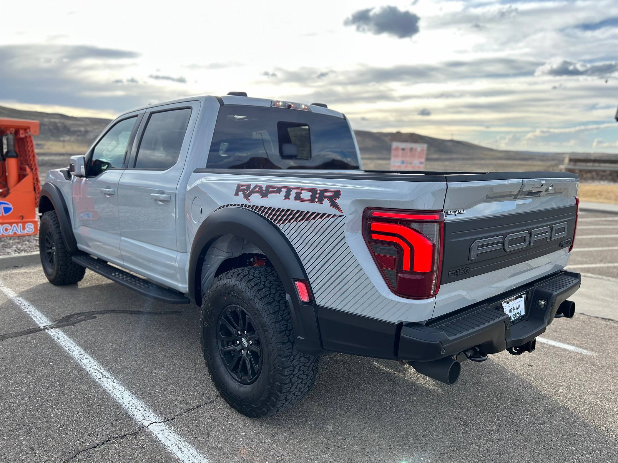

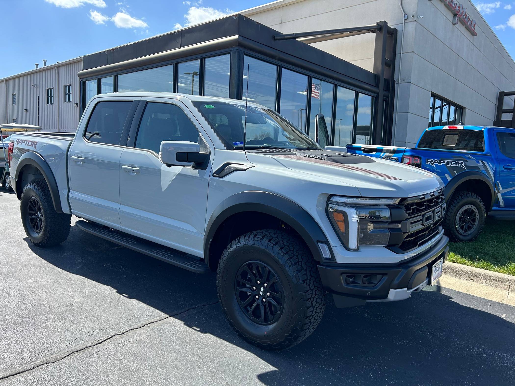

I was at a similar point of frustration, not turbo related, but dealer experience along with so many issues with the truck that drove me crazy. They had my truck a total of 7 months in 2 years... Had to take a rental van on a Moab trip, 2 transmission seals, 1 transmission, back glass ((which they busted into my truck leaving glass everywhere and said it was normal.) I pulled up a small shop vac full of glass and was still finding glass a year later), upper oil pan oil leak (very sloppy RTV job), then lower oil pan leak (another very sloppy RTV job). Thankfully I had the Mopar premium care warranty, it covered a rental where the dealer refused, I had total rental car bills of $9k while they had my truck for weeks and months at a time, Mopar premium care reimbursed me for all of it. My issues started at 1700 miles.
That was my 6th Jeep and my last for quite a while. Will likely pickup a JK in 10 years to work on with my son, to teach him and to run the Rubicon.
Lemon'd the JTRD, went through quick and easy. Got this & couldn't be happier. Its a bit bigger, but its an incredible machine. I'm sure it will have its own issues, time will tell.

I would love to do this but Raptor is a little out of my Price range lol
