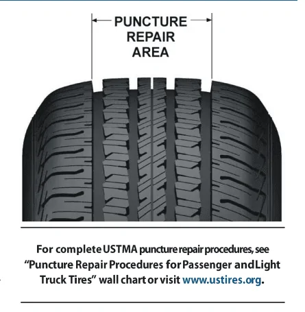

According to the US Tire Manufacturers Association guidelines, the OP's puncture is not in the repairable tread area of the tire. That is why most tire retailers won't plug / patch it.
https://www.ustires.org/sites/default/files/2021-10/Puncture_repair_handout_17_2.pdf
