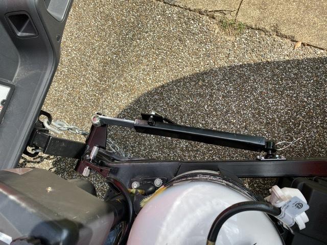

I use the Curt Echo brake controller (freaking LOVE it), the mirror extensions from the member on here (superbly made, BTW), and an anti-sway bar (just for peace of mind). I don’t use a WDH for my TT as it’s just barely at or under 3.5K# fully loaded and has a tongue weight of <300#. I’ve towed it about 5K miles thus far with no problems at all…pulls like a champ.

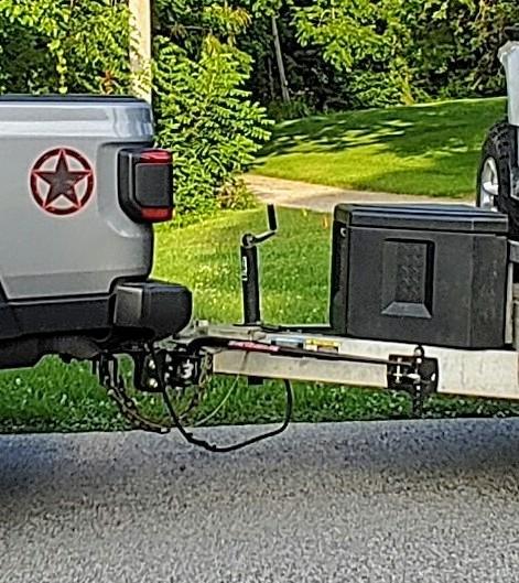

Here is my WDH. I need to look at exactly the spring weight. I got it from my local RV truck shop. They selected the spring weights. It does great truck rides even and smooth even with a lift.

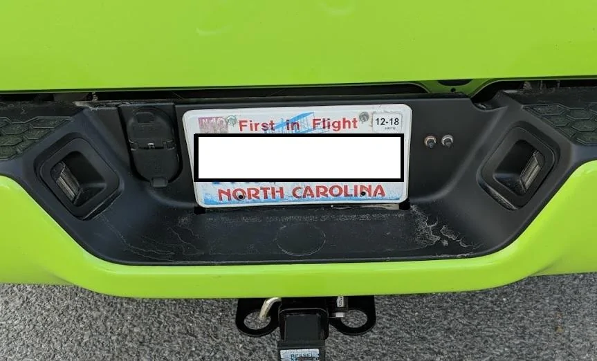

No compressor needed. They come with schrader valves that you can mount wherever. On my Ram I have them mounted next to the license plate in the back. I use a bicycle tire pump air them up. You only put 25-35 PSI in them. Takes a couple pumps per bag.

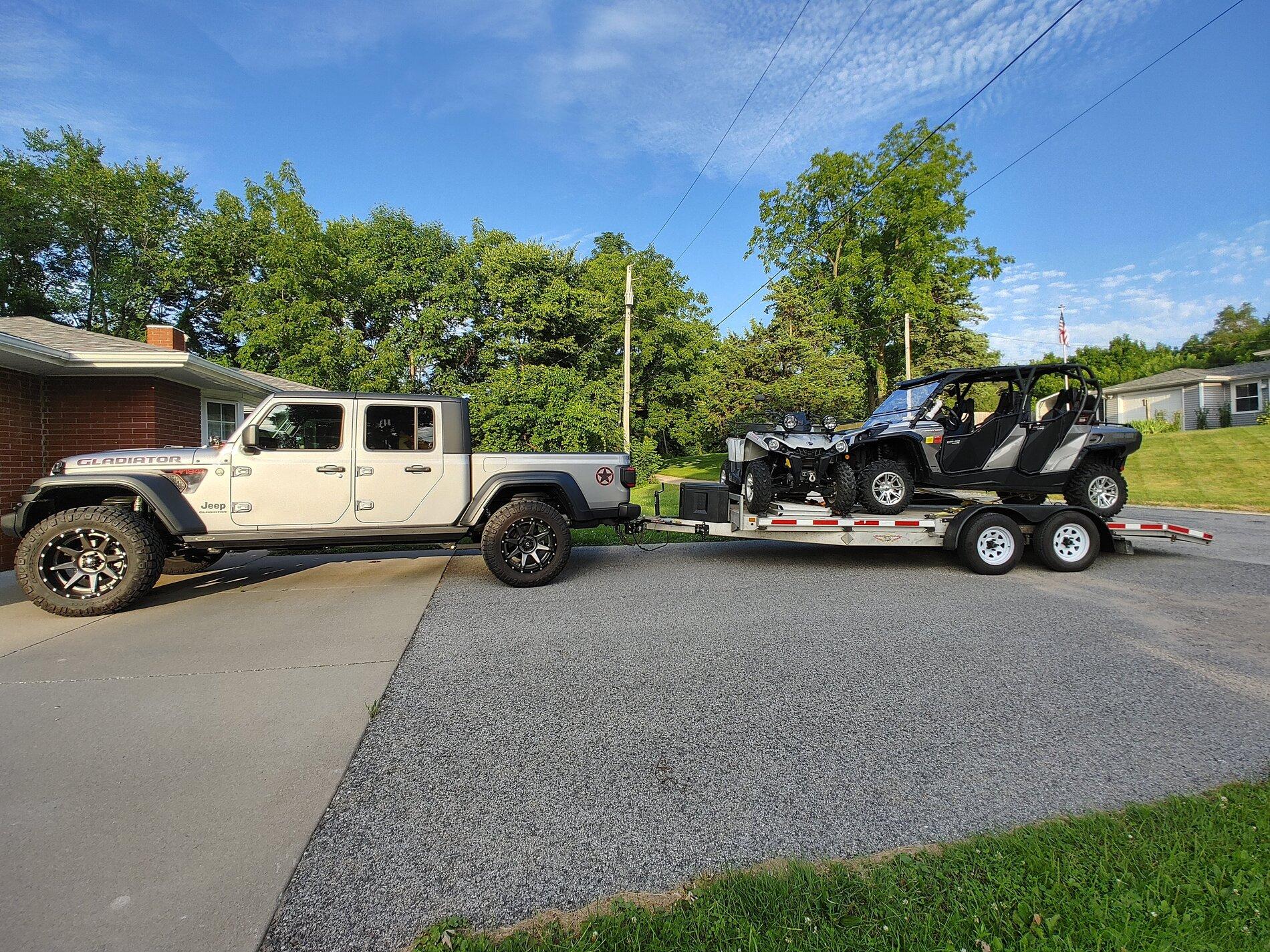

Hopkins Insight Brake Controller. Magnuson Supercharger, EAZ Lift Recurve G3 WDH. Diode Dynamics reverse lights in the bumper. 4awg rear battery connection for winch. Thing yanks cars, quads and side by sides beautifully on or off road

Supercharger works out great. I have quads and a side by side I take offroading with my friends and family. With my whole family aboard and a full trailer. I am keeping or setting pace with two full size chevys and an F150 pulling similar cargo.
The 4awg actually has a connector at the hitch and I plug my trailer winch into it when a dead car or machine needs help getting on. It is just a small 4500 lb winch to get things up on to the trailer without using my back.
