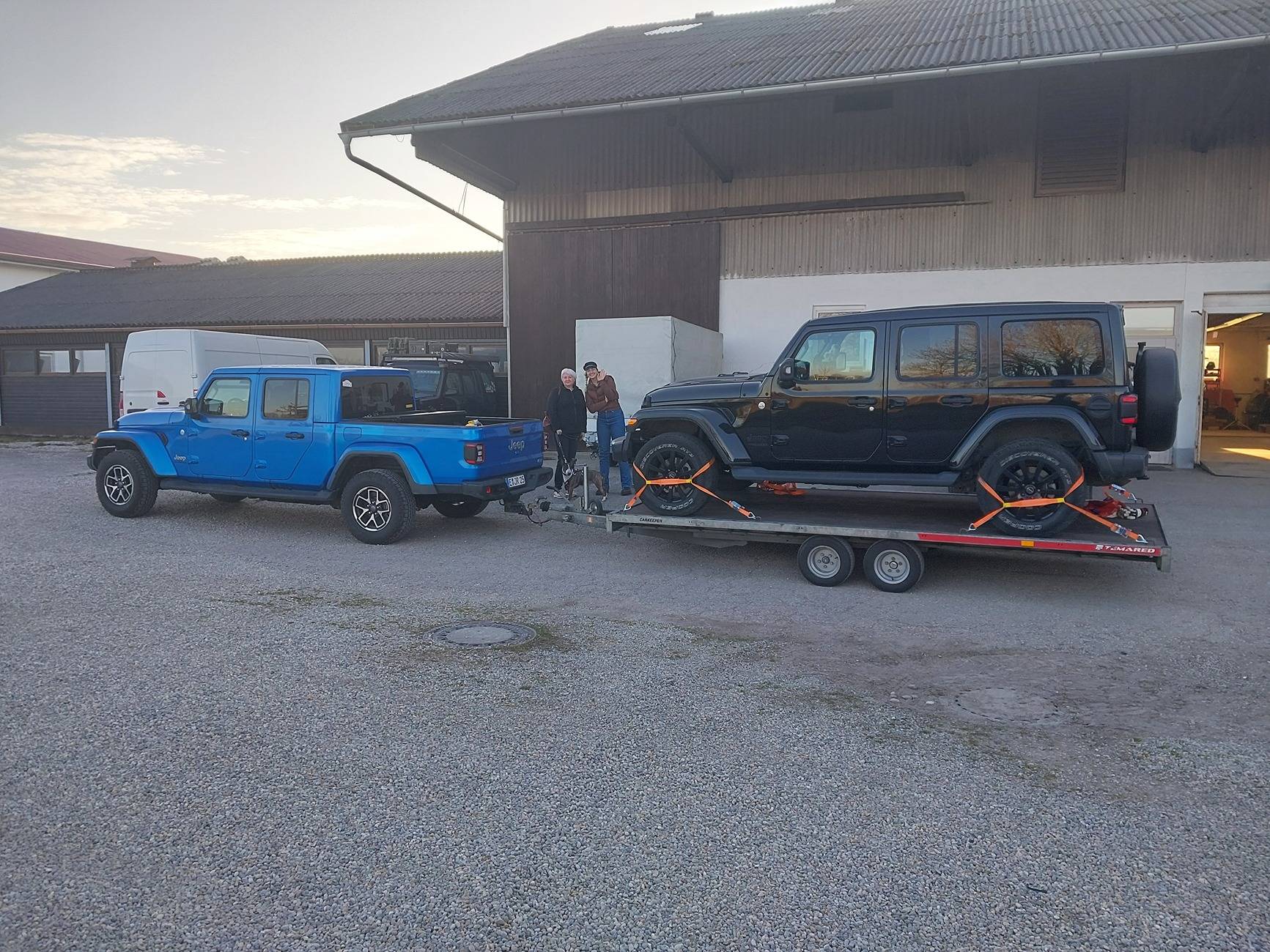

Just recently towed a JLU from my place to Bavaria, only 600 kilometers (375 miles).
Mostly flat but with some steep parts.
Was absolutely easy, towed with 60 mph and the milage was 20 mpg.
Jeep Gladiator Towing TJ 600 miles 20250320_173544
