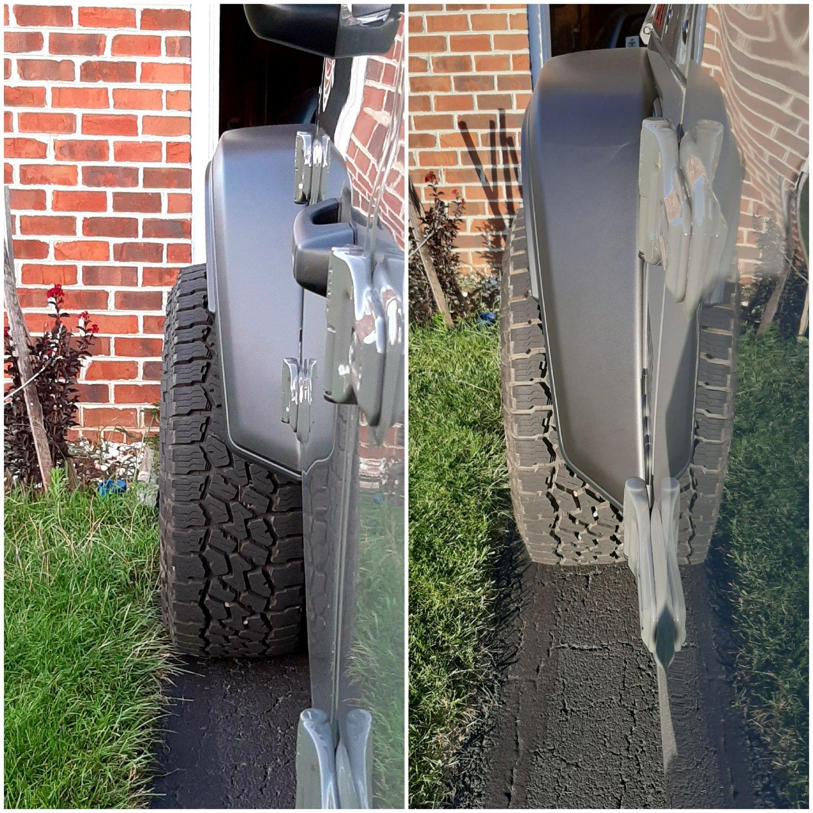

I went to a diesel shop. They adjusted my track bar and its perfect now. $50. The other guys charged me $225. Should have asked for my money back.

Yea lol. I should have gone to the 2nd place to begin with. It was only 20 minutes away. They said they install lift kits all the time and if I need any accessories in the future they'll do it. First lifted Gladiator they'd seen. Said it changed their minds on Gladiators looking goofy. I'm going to the dealer on Monday about my steering so I'm waiting on installing the brace in case they give me crap.
