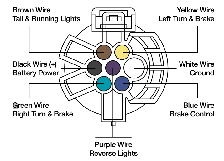

IS there a wiring schematic for the plugs on the JTR? I want to rewire (rotted and missing pieces) my trailer and need to know what wire goes where LOL

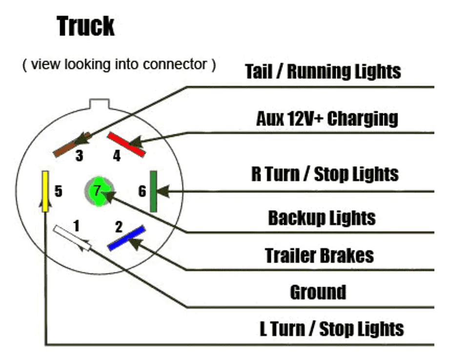

My bit with the PDF is that is shows the clocking different. It shows power on the left vs. upper right. That's my only thing with it.
This -
Jeep Gladiator Trailer Elect Plugs Question 1717692428538-a7

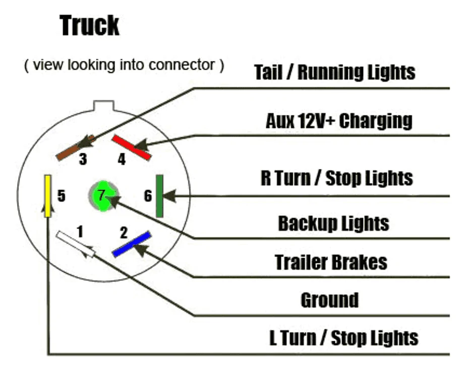

Vs - (note it says truck right on it) IMO, this is a ton easier to follow for all of the novices out there trying to figure out what wire is what - because it's an exact match, including clocking of the pins.
Jeep Gladiator Trailer Elect Plugs Question 1717692493260-hr
which matches this exactly - so if he's under the truck, trying to figure out what that top let spade is for - the pic I posted matches this connectors exactly ->
Jeep Gladiator Trailer Elect Plugs Question 1717692772654-ru

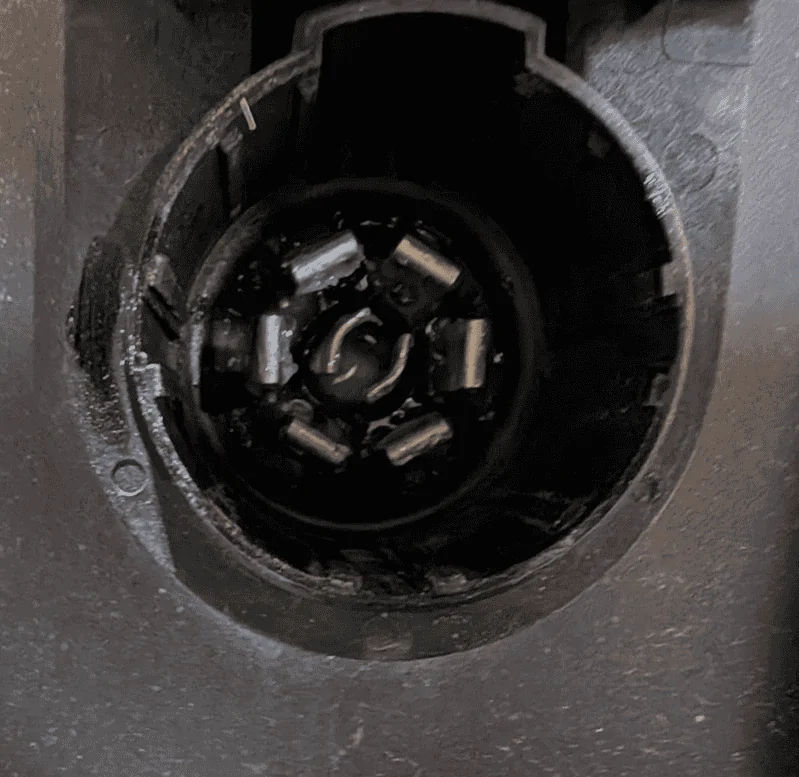

Semantics, maybe - but this is the actual truck with the exact pinout in the same orientation as looking at the truck's plug.
Screw this. I bloody well know the differences in plugs and trailer vs. truck and made it very clear in my first post - it was the TRUCK side. I was trying to make it EASY for a novice, with the exact orientation, a perfectly lined up picture of the truck side.

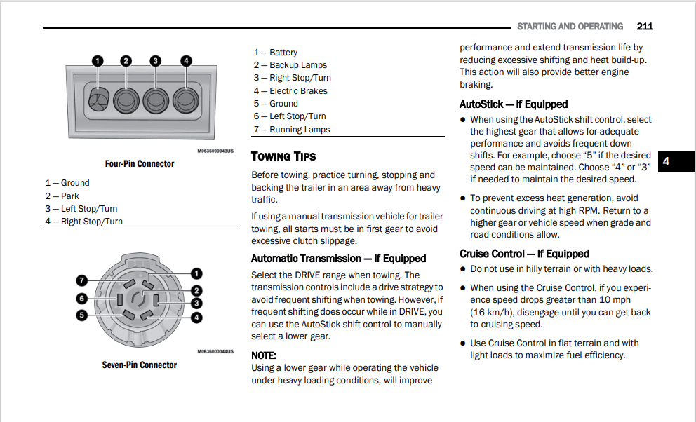

From my 21 Owners Book:

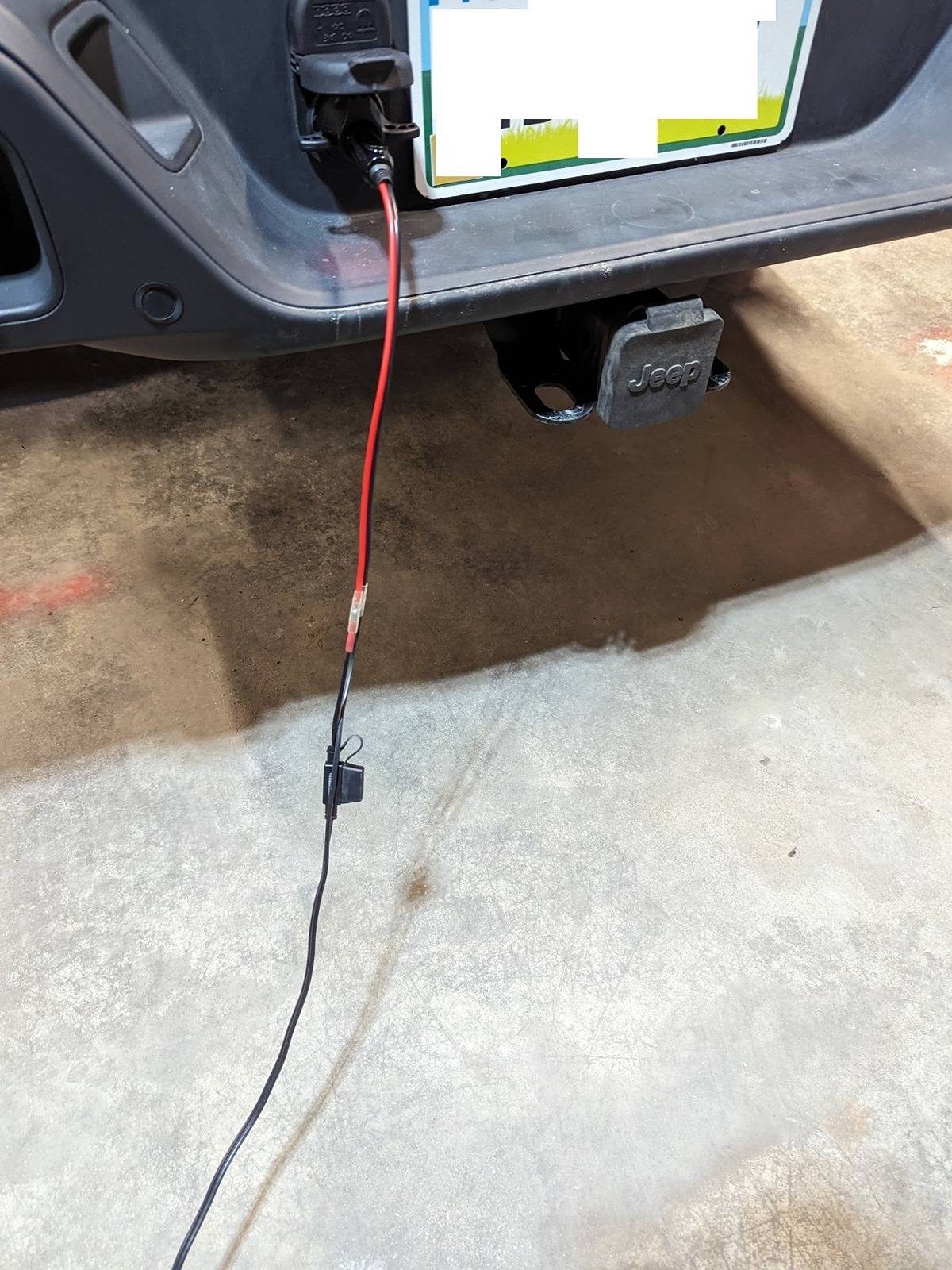

So you can charge through the hitch or you are charging a battery from the hitch? I used a 7-pin connector to make a pigtail to run an auxiliary backup lamp or a 12v water pump as needed.
For the time an expense (minimal) it’s a really handy accessory. I’m pretty sure the plug assembly I bought (nice metal body with good water ingress protection) came with a reference diagram. This is a standard connector type, the schematics are widely published.

You can use the 12v line in the tow wiring, up to the limits of the fuse, to pull from the truck batteries and to charge them. You can buy an adapter with a 12v power port that plugs into the 7 pin connector for around $18.
