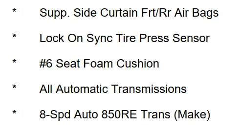

From my wife's 2021 WK -
Jeep Gladiator Transmission needs to be replaced at 32k miles 1658202437562

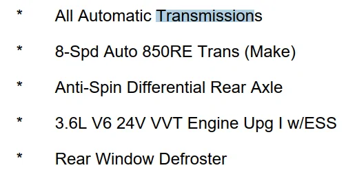

From my 2022 Gladiator -
Jeep Gladiator Transmission needs to be replaced at 32k miles 1658202484581

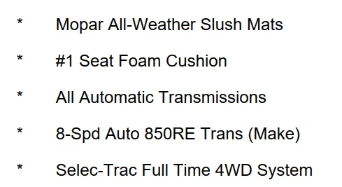

From my 2020 Gladiator -
Jeep Gladiator Transmission needs to be replaced at 32k miles 1658202569036
Jeep Gladiator Transmission needs to be replaced at 32k miles 1658202614640
