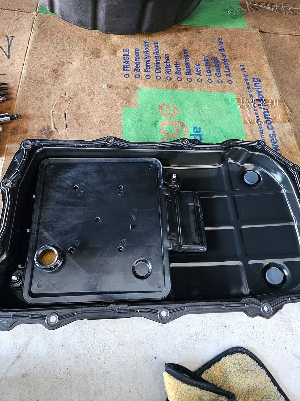

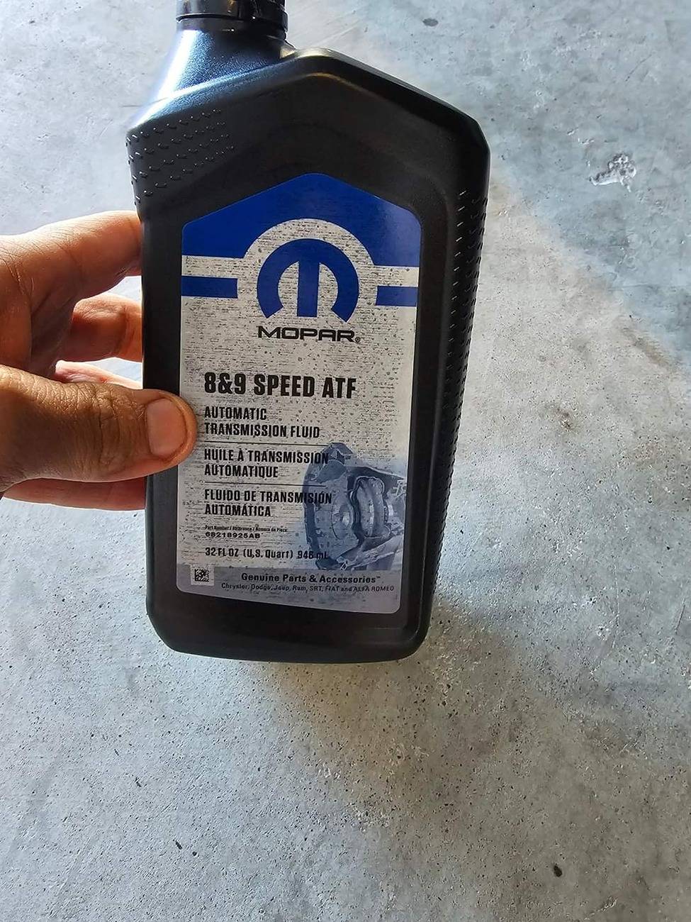

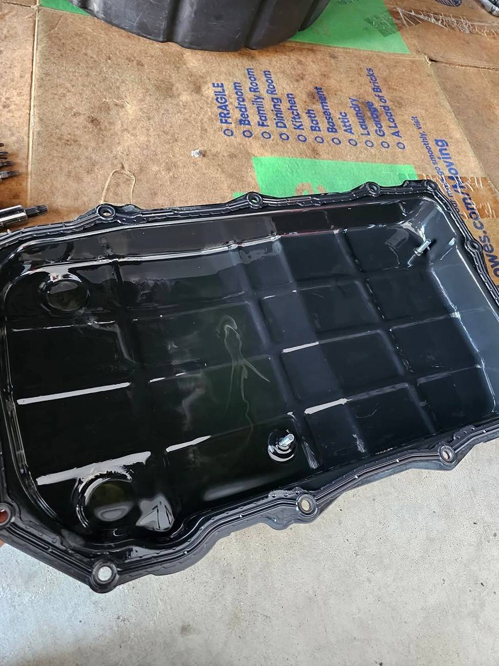

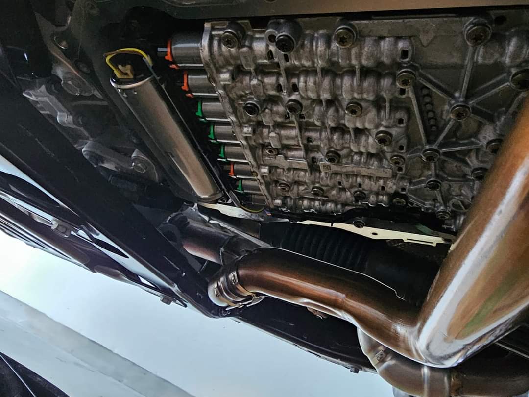

Picked up my filter, fasteners and oil. I’m at about 30k kms on this change. I figured it was time to swap out the oxygen sensors too @108k kms. I’ll have those next week! Christmas holidays coming up, is a good time to get things done.
