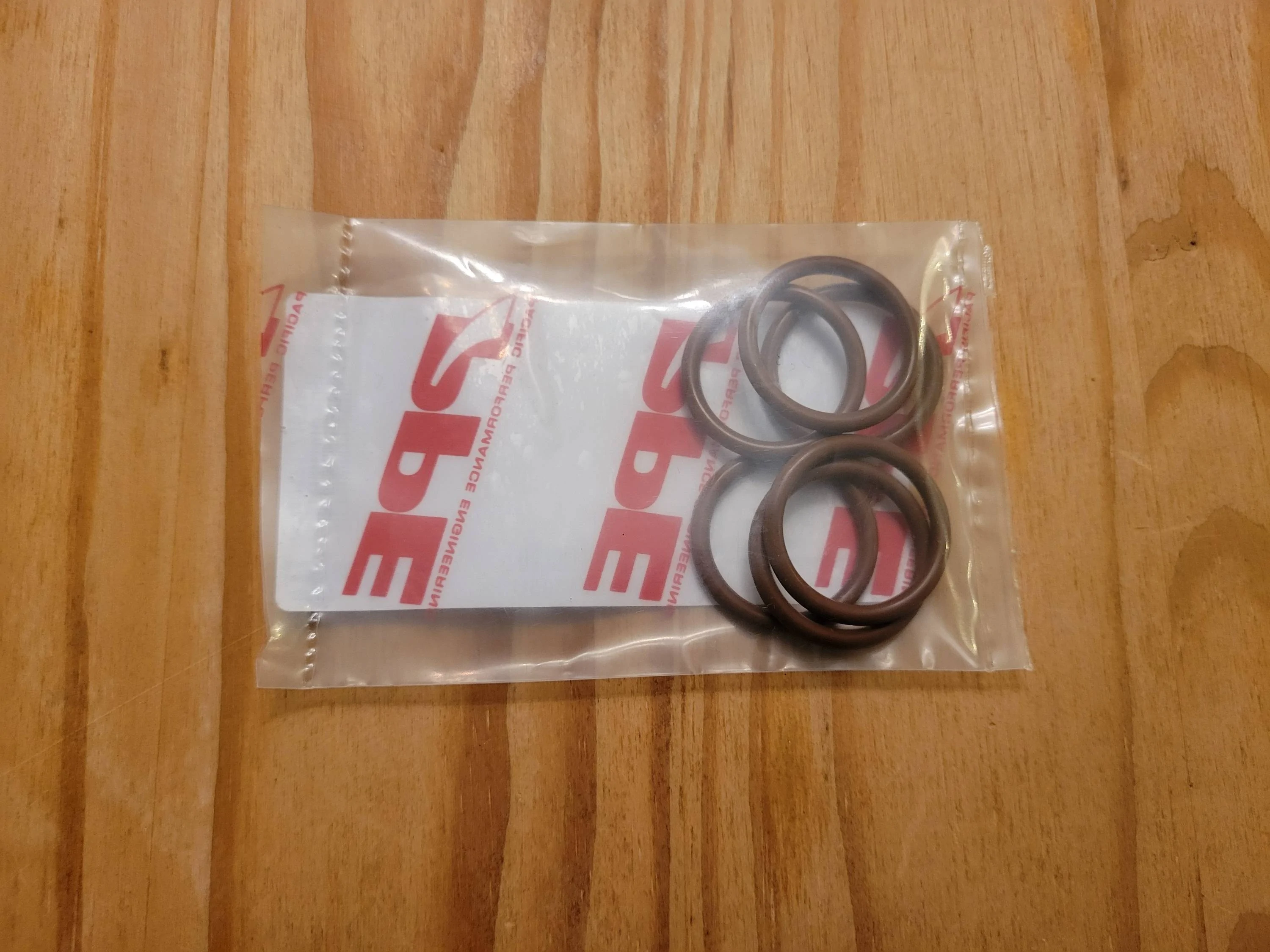

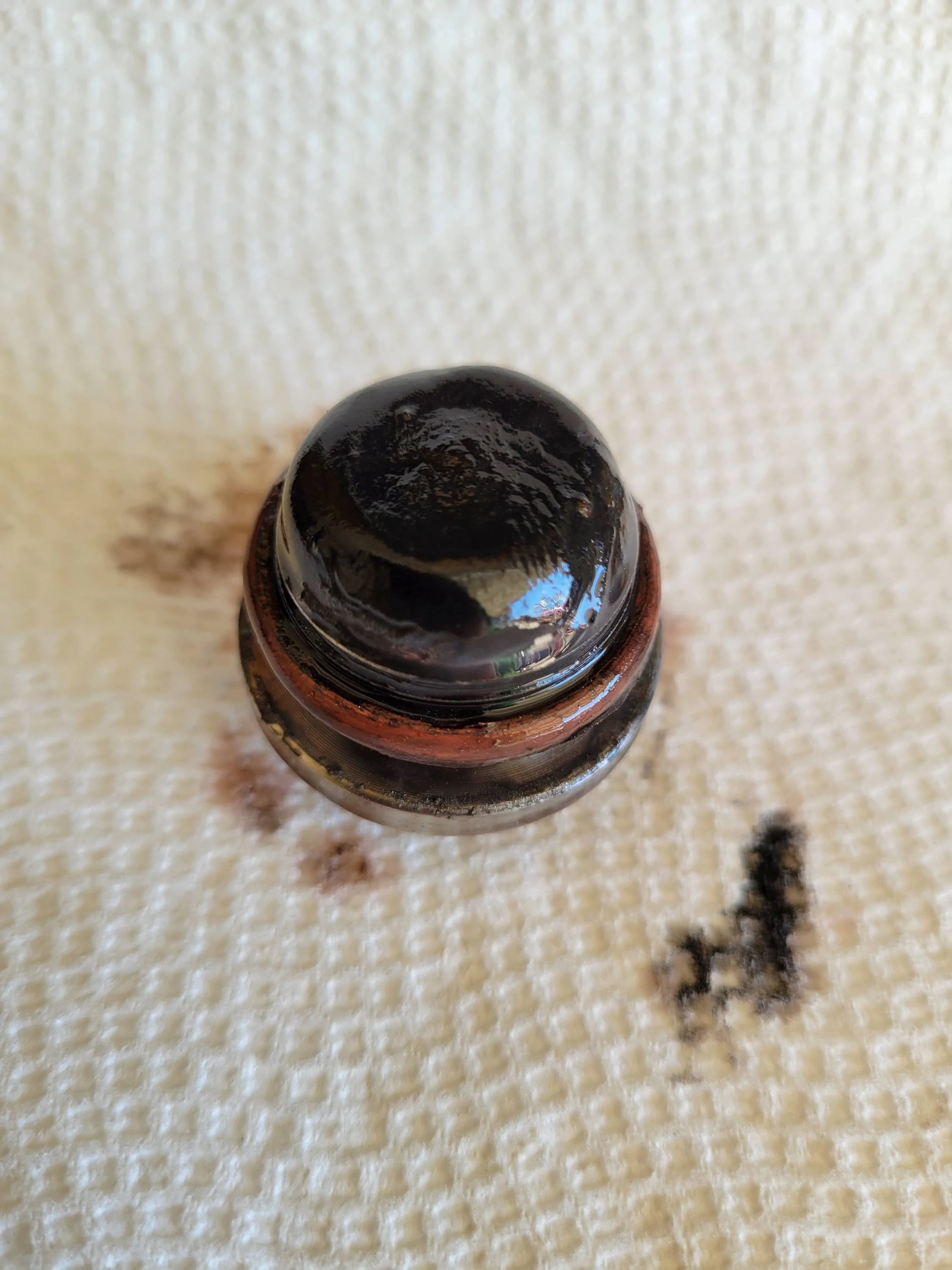

When I do my first fluid change, I switch to the PPE pan. The magnetic drain plug on the PPE allows for an easy drain and fill. However, I will drop the PPE pan and replace the filter every other drain and fill. I stick to 40,000 mile drain intervals.
I use Amsoil Signature Series. I noticed that my transmission shifted smoother just after one drain and fill. It might be overkill, but I also replace the O-ring with each drain and fill. I also pull a fluid sample at each interval just to monitor wear and the condition of the transmission.

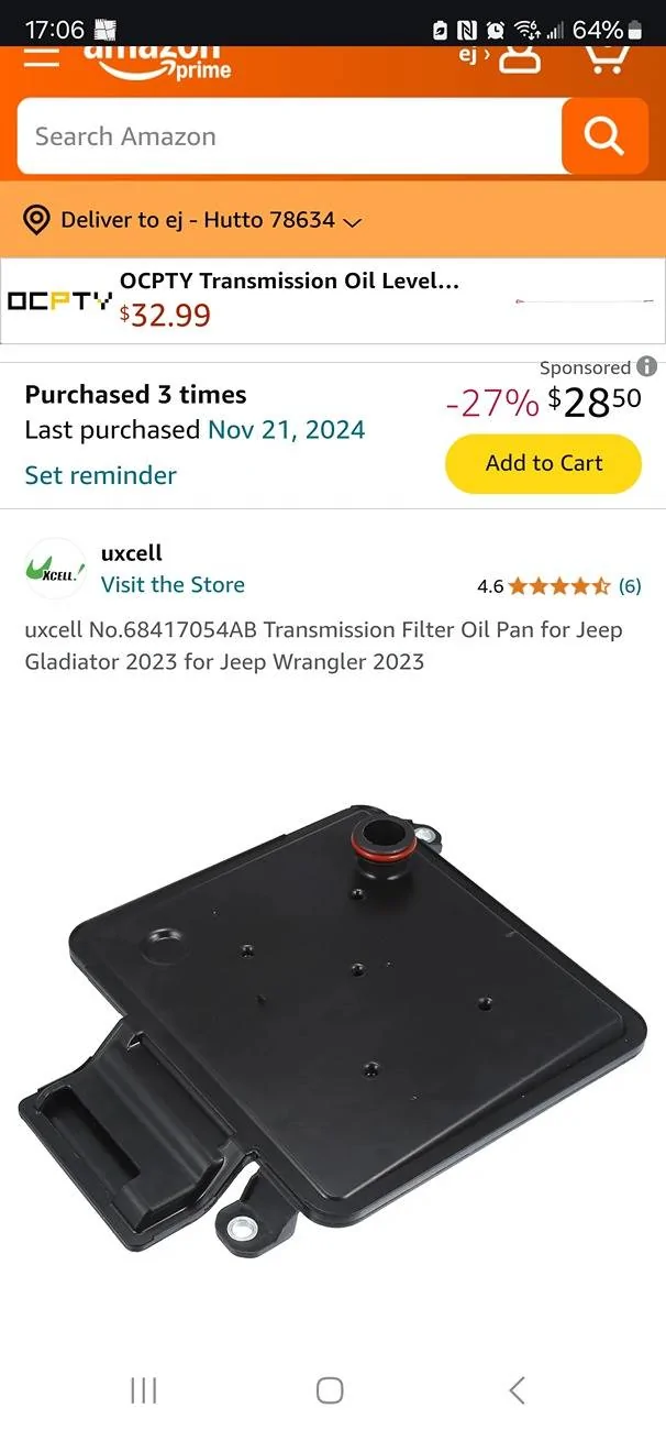

Do you happened to have part number for the filter and gasket?
also what did you used to run the fluid back into the pan?
Gasket is reusable with dowel pins to hold in place as long as you don't bend it. Filter I bought off Amazon. Standard quart hand pump works perfect as the fluid is low viscosity and easy to pump in.
