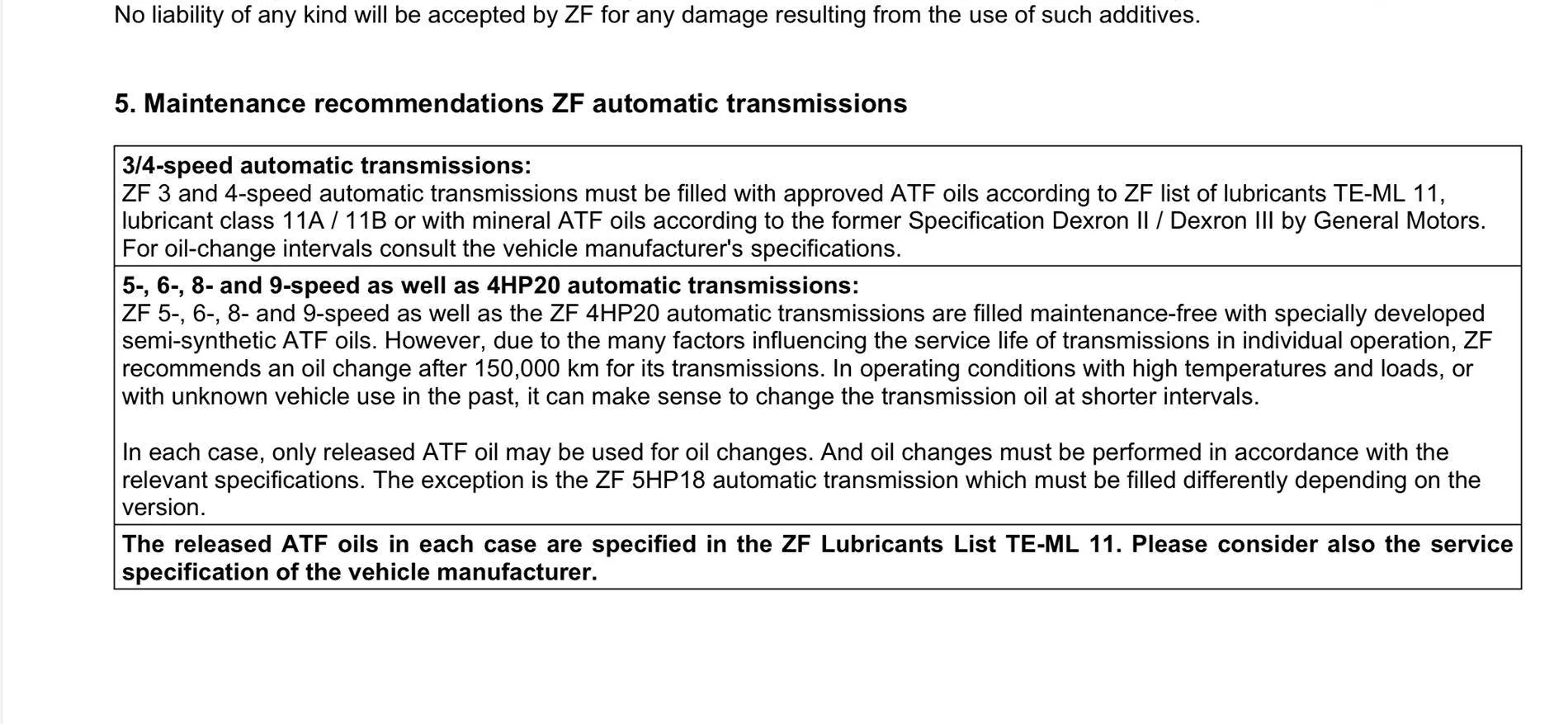

And another thing the horse said is:
“In operating conditions with high temperatures and loads, or
with unknown vehicle use in the past, it can make sense to change the transmission oil at shorter intervals.”
So if one wants to change the oil say ‘every couple of years or even yearly or any time earlier than at the end of life when it’s worn out and Chrysler doesn’t want it’, then so be it. Change it early! ZF says, “…it makes sense”.
ZF doesn’t provide what “higher temps or loads means” and says it makes sense to change the oil, then …do it!

But ZF isn’t saying “over heat”, it’s saying “higher temps and loads”. To me, higher temp means traveling during those crazy hot summer days and where the temp bar “normally” sits on the temp guage has now moved up one notch. “Load” to me means take your stock weight and now add on all the weight of your extra mods and stuff you throw in the back and that’s what you call a “load”.
Then as ZF says and anyone else that thinks being proactive on oil changes says “it makes sense” to change the oil.. the next question is how long do you keep that oil in there and does it make sense to just keep it in there or get it out of there?? Another thing that “makes sense” is to have that oil lab tested and watch the trends.

People should note that even ZF is saying it can be over 90,000 miles, so the term "lifetime" isn't that far off. When people think of "lifetime" they get literal. In the automotive world, to many, lifetime still means roughly 100,000 miles.
But no, people get hung up on that word.
150,000 km is roughly 93,000 miles. So, for many, that would be lifetime - meaning "as long as I'll own it".
Right from the horse's mouth:

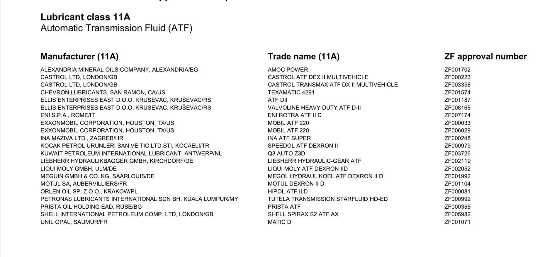

I had reached out to ZF last year asking about a certain ATF I was looking at using, (and no, it was most definitely not AMSOIL), specifically designed to “quiet” automatic tranny whines and noises and they sent me this PDF of “approved” lubricants for the 8/9 speed transmission.
This is in reference to Post # 28 in this thread, from Maximus Gladius (Nov 30, 2024).
Those are the wrong pages (pp. 6-7). Right document, wrong pages. Lubricant class 11A (shown above) does not apply to ZF 8HP50 / Chrysler 850RE 8-speed automatic transmissions.
ZF document: List of ZF-approved lubricants (also see attachment 1 in ZF reference docs)
The correct pages are pp. 4-5. Specifically, the last section on page 4 (see 8HP50) and the first section on page 5 (see Stellantis Oil No. 68218925AB). Stellantis Oil No. 68218925AB = MOPAR 68218925AB.
For easy reference, three (3) ZF-approved lubricants for the 850RE automatic transmission are listed in my post (below) covering this topic.
My post to this forum: Key Takeaways on Fluids & Filters for Jeep Gladiator 3.6L V6
Section: 3.6
Paragraph: "Summary of Lubricant Options for Chrysler 850RE Automatic Transmission in Jeep Gladiator"
Options: 1-3 (not option 4 if under warranty)
Also see: "Notes on claimed equivalents" at the end of section 3.6
