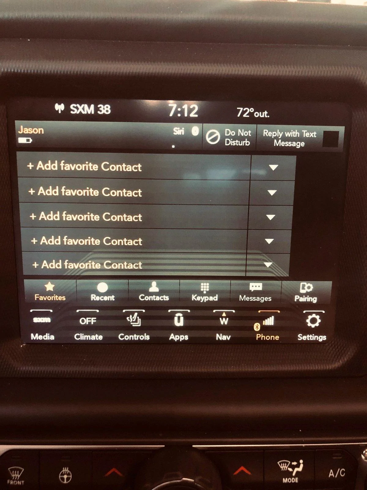

interesting. I just checked again this morning and the volume was the issue. No idea why that didn’t resolve it a few days ago.As mentioned before- check the volume on the uconnect before going to the dealership. I couldn't hear calls, text or nav directions after the update UNTIL I discovered it was just the volume reset to zero. Turn the volume up during texts and calls and when your nav is directing you. This fixed my issues.
I would think this repair will be done through the ODB port. Try the volume before you go to the dealer though. Mine didn’t seem to resolve at first but when I tried again the issue really was the volume."After the download of the software update on the radio, I no longer have phone calls (send or receive) come through the vehicle speakers. Everything was fine before."

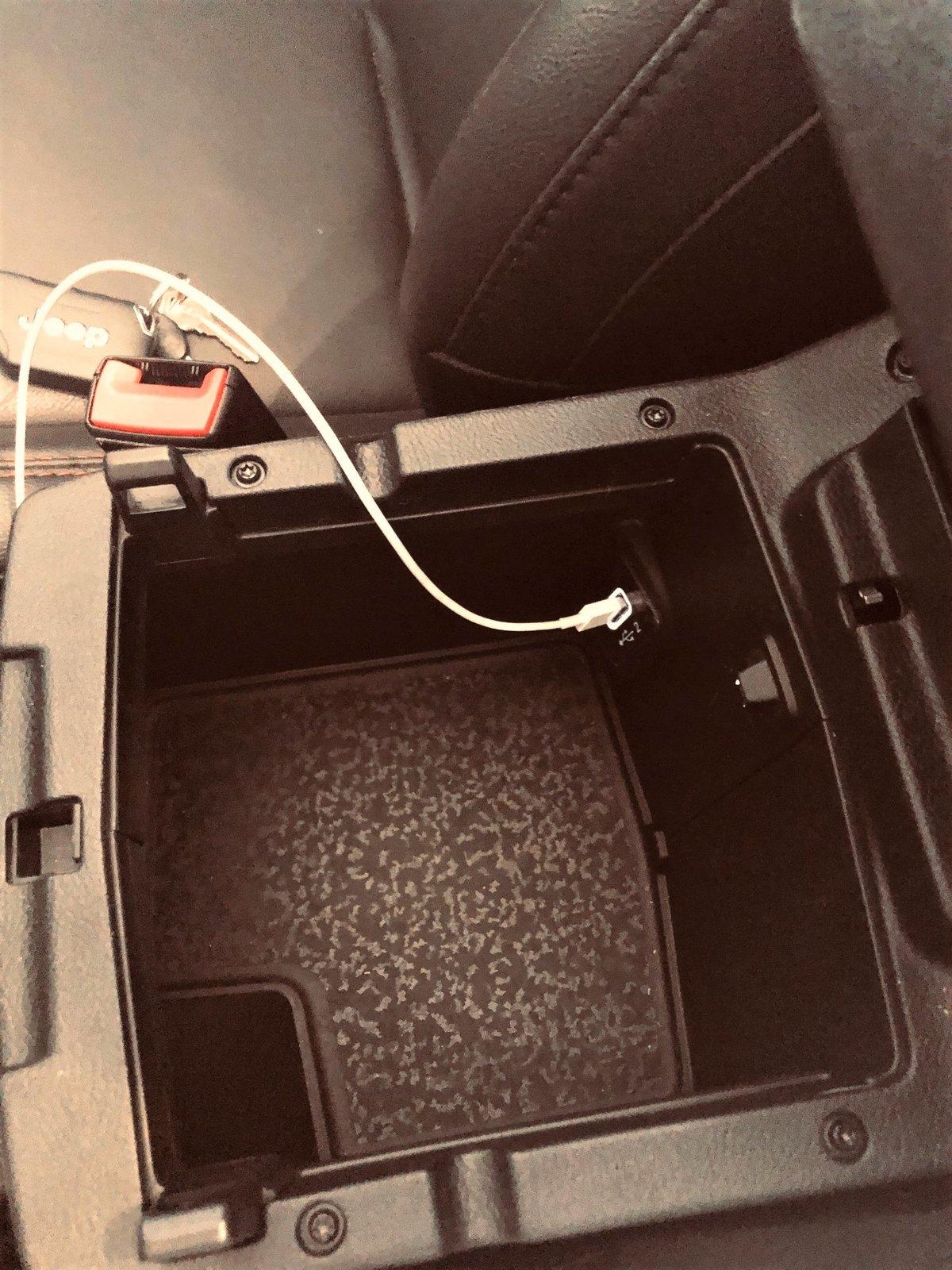

my issue was identical and I lost the option on my iPhone for CarPlay and just had iPhone and speaker which is different from what it was before the update. However once I placed a call and while on the call increased the volume it did start working.Phljeeper: I will play around with it some more, but, when my iPhone is connected via USB cable to the dash (or through the center arm rest console -- it does not make any difference), carplay does work in all respects except...when making a carplay phone call the carplay speaker option mostly does not appear as an option on the iPhone screen (no car speaker option) or, if it is there, the icon is only partly loaded and when selected on the iPhone the option does not work.

Hi, I'm sorry to hear this. Please let me know if you plan on visiting a dealership for this concern. I would be happy to open a case for you.I had the same problem. Thanks to the advice on here, I check and my volume was at zero. I haven't tried to make a phone call yet, so hopefully that fixed it but it definitely was not giving me my turn by turn volume for directions. I didn't even realize that was muted.
