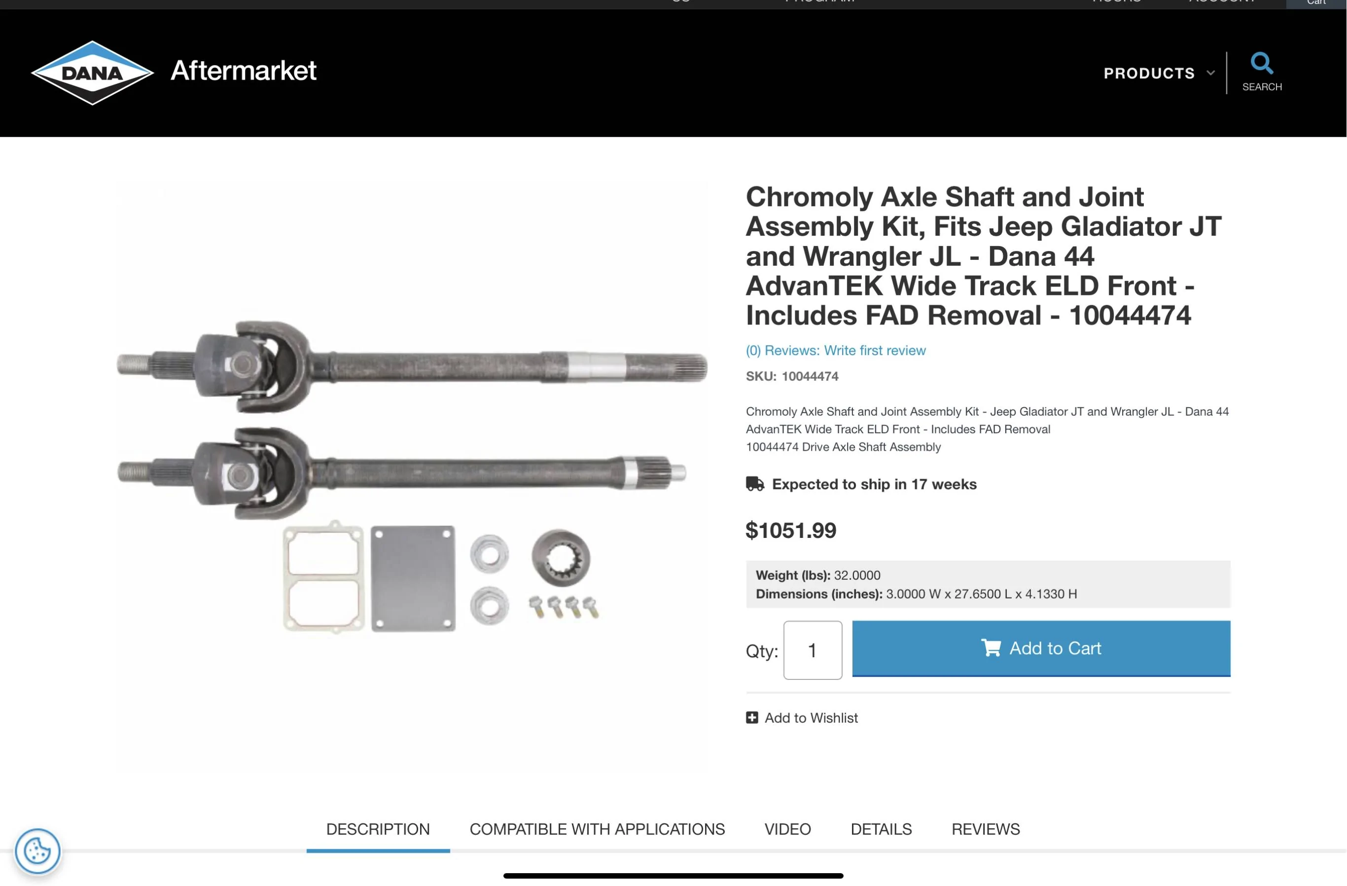

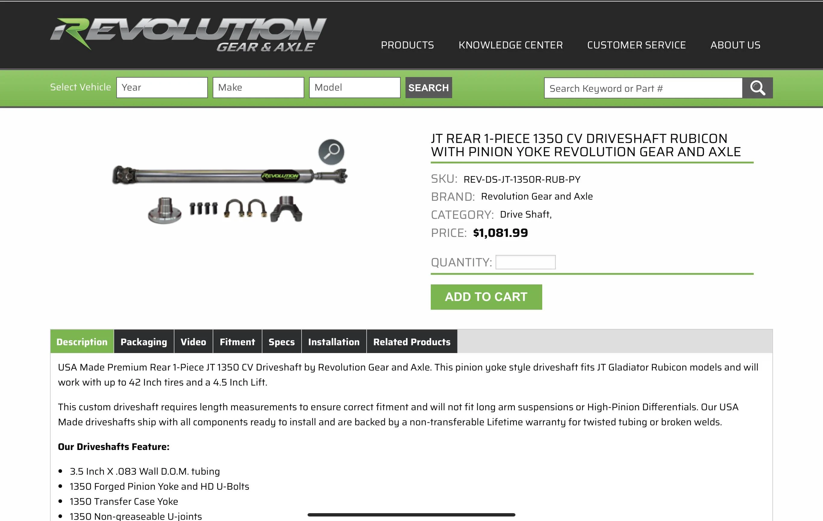

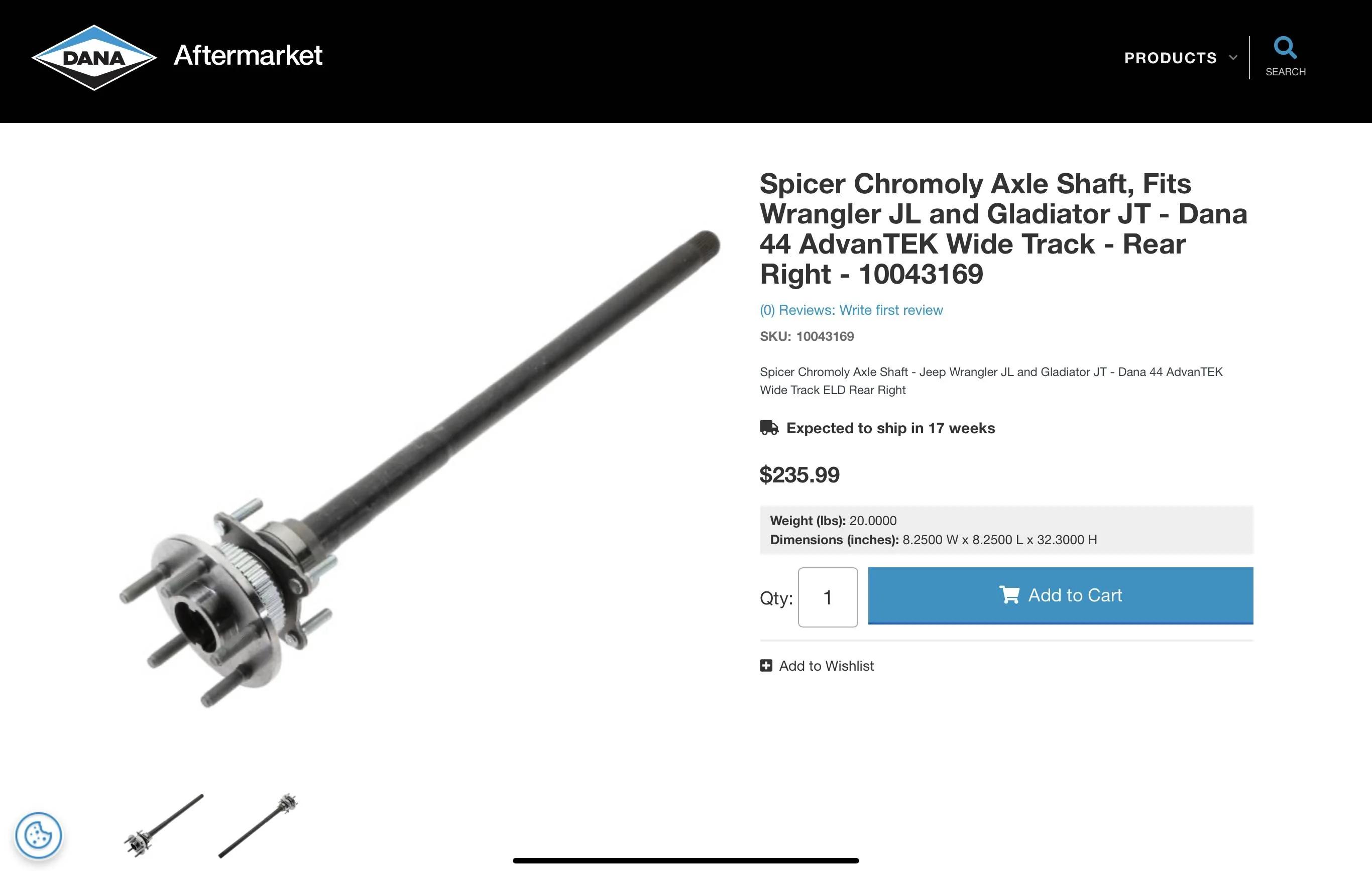

Good afternoon,
I‘m going to be rebuilding my Dana 44s for 38s. I want to install front/rear axle truss, Chromoly axles, Diff covers, driveshaft and 5.38 gears. I know there’s 2 main companies for gears Yukon/revolution, but I also see Dana aftermarket offers gears/ chromoly axles. Does anyone have a preference in what parts to go with ?Going to be my first time building the Dana 44 so I would appreciate any help !

Might consider 1310 joints on the drive shaft vs 1350s for the weak link.

Axles shafts. Front RCV's. Had them on my Power Wagon. Rear, Dana.
Driveshafts. Woods, Adams....

Spend a little extra and get RCV axle's for the front and Dana for the gears

I did RCV's with fad for the front and Revolution Chromoly axle shafts for the rear. Artec front axle truss and 4.88 Yukon gears (early install about all they had out at the time), but I have a 5.7 Hemi. With the V6, no less than 5.13, could probably get away with 5.38. At 75 mph that puts you at 2390 rpms with 5.38's.
