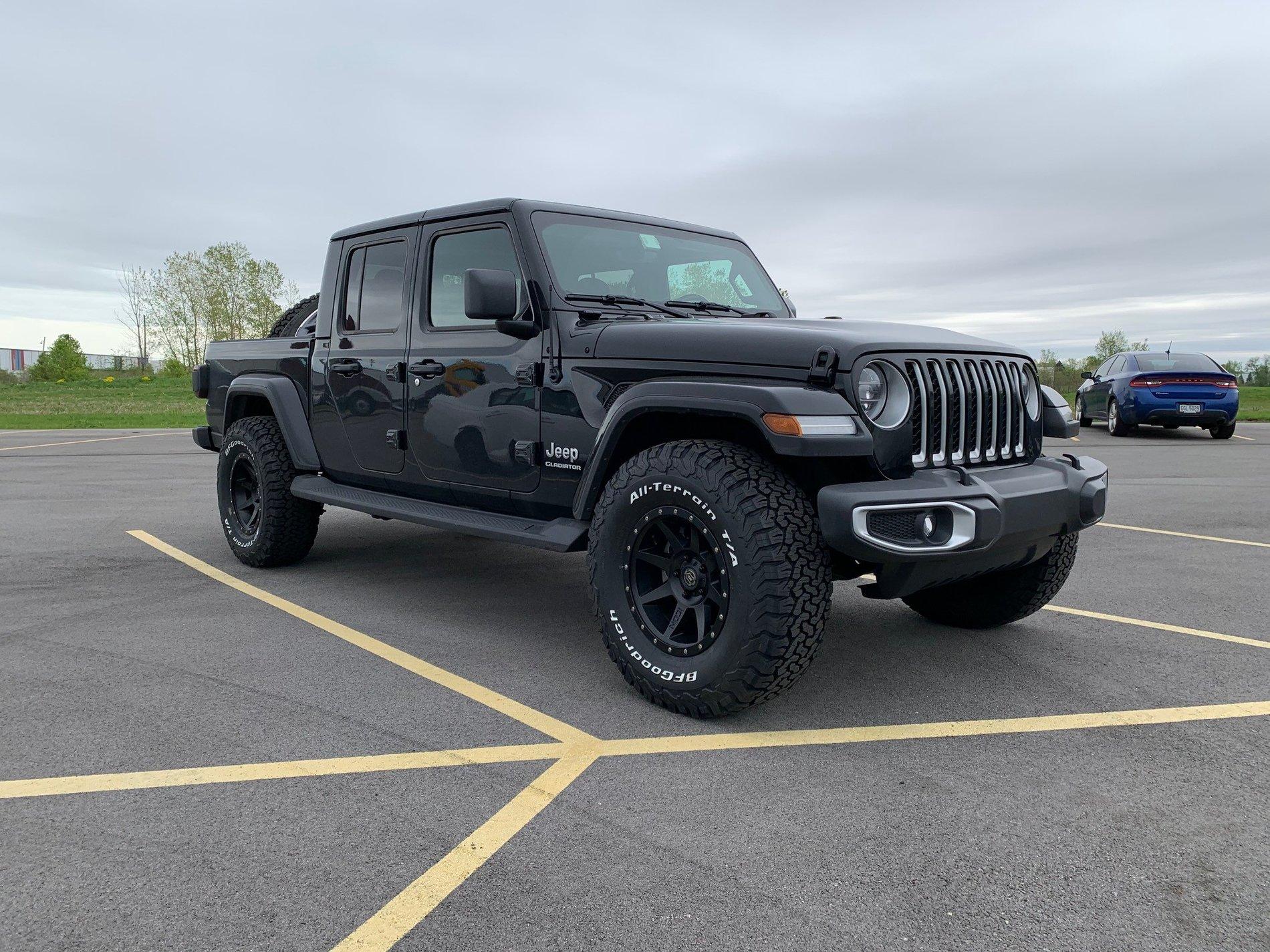

You can run with 35's on an Overland without a lift if you aren't looking to do some extreme off-roading. Below is with 35's and no lift. Note the stock wheels/tires are in the bed so it looks somewhat level.
Jeep Gladiator Upgrading Overland (Rubicon Takeoffs or MOPAR 2”) KO2s Installed

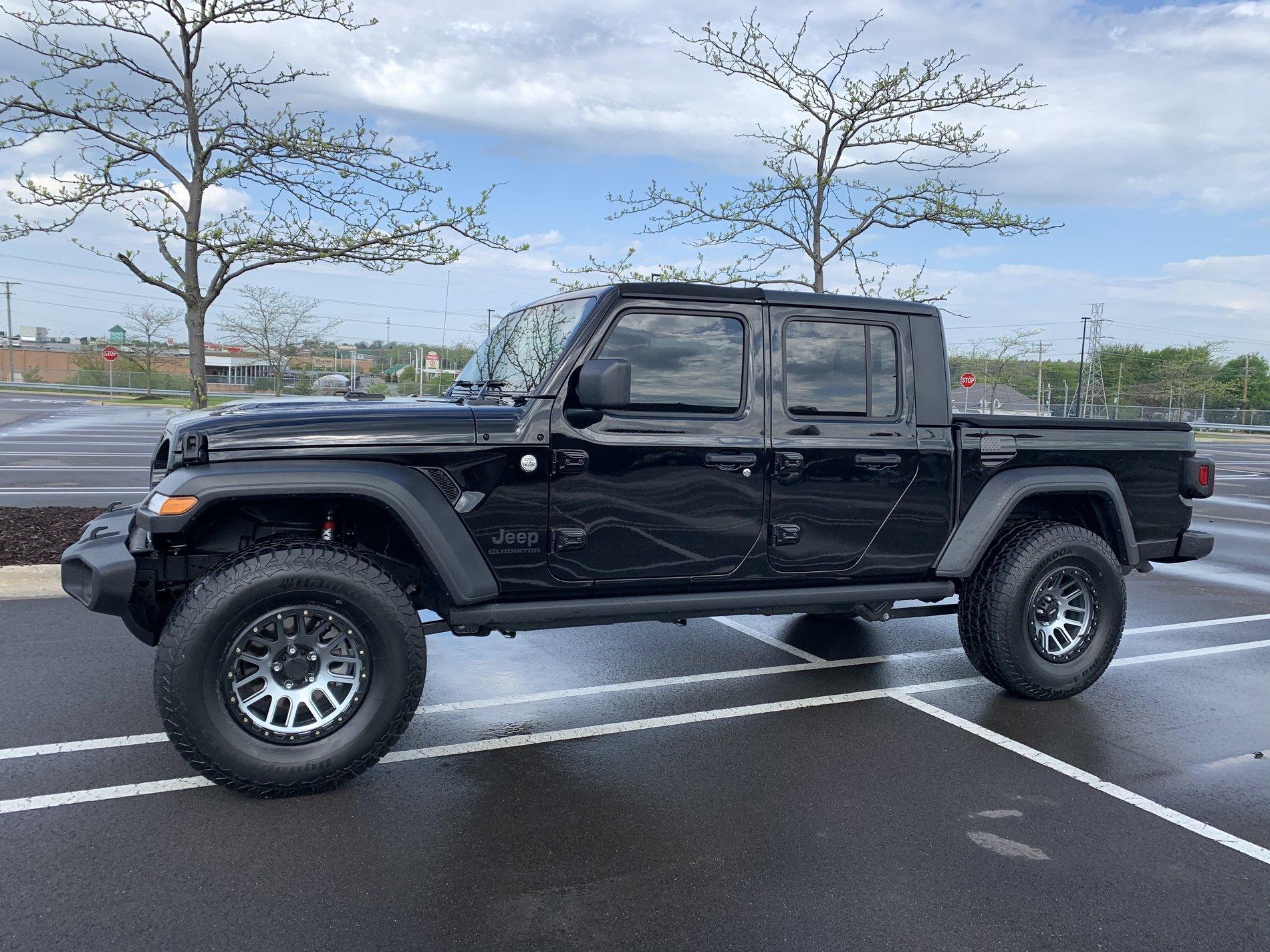

This is after I installed the Mopar 2" inch (fortunate enough to find it complete on this forum for sale). Still looks fairly level, although this was right after a put the lift on. There is probably a little settling at this point. I attribute the "fairly level" look to having a full size tire/wheel in the spare well instead of the spare that came with the Overland.
Jeep Gladiator Upgrading Overland (Rubicon Takeoffs or MOPAR 2”) KO2s & Lift
Good luck and remember to have a torque wrench that can go up to 200 lb/ft.

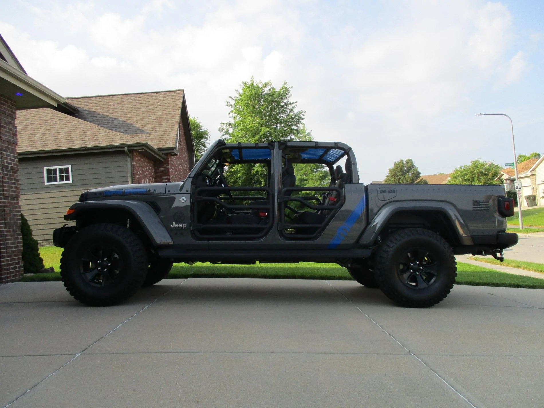

I went with the 2 inch Mopar lift and Mopar performance wheels with 37 inch tires and i like the raked look.

All stock with the Mopar lift but the Moper Performance rims do have a bit more offset than factory wheels. no rubbing or any issues at full lock.
Jeep Gladiator Upgrading Overland (Rubicon Takeoffs or MOPAR 2”) IMG_9044.JPG

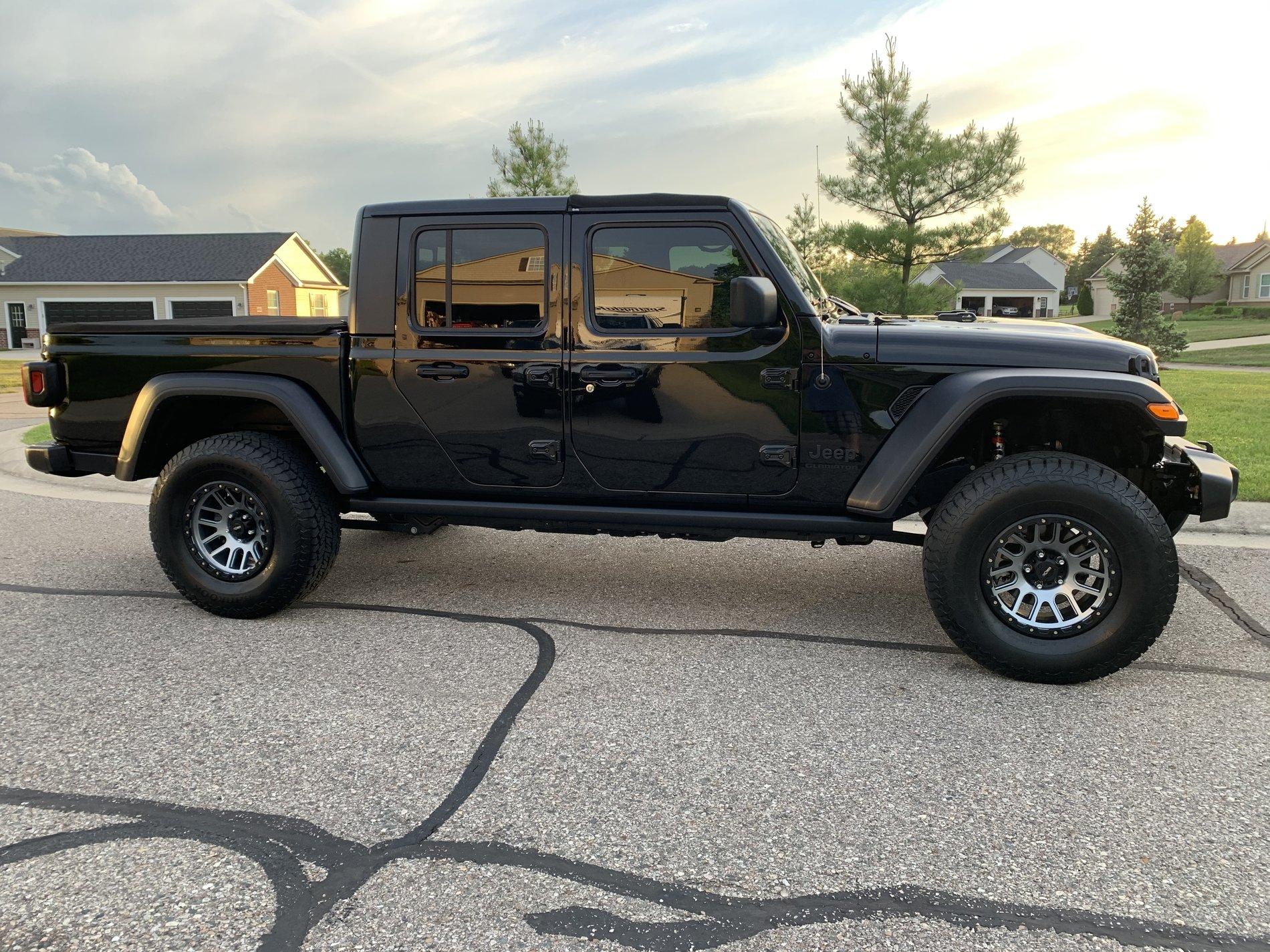

I took some flat stock from work and placed it on the highest portion of the truck. I got 76 7/16" from the highest point to the ground. Hope this helps.
I hear ya on the garage job. I cleaned out my garage last summer to fit the car I had at the time. Bought the Jeep in February and it doesn't fit, not because of height but because of length...Well now I have a space to put all the kid's toys haha.

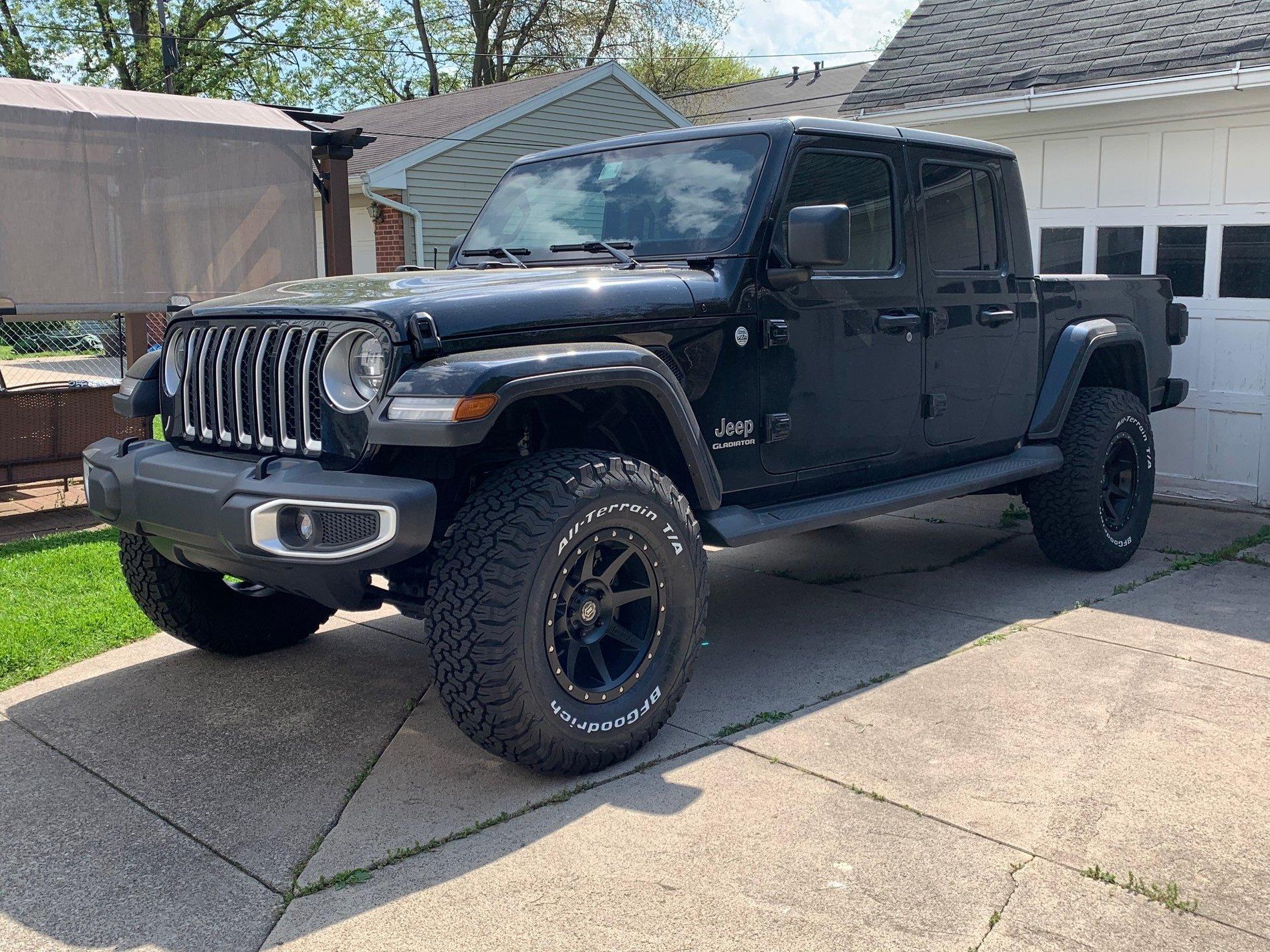

I put Rubicon take offs and 1.5” Teraflex spacers up front on my Sport, looks and works great. I then added 4 Rubicon fenders, keeps getting better.
Helps tremendously, only have 76" clear without making modifications to the garage door brackets.
