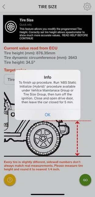

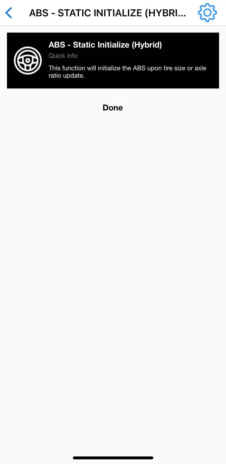

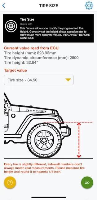

I went through this last year when I moved up to 35s. Dealer said they would make the change no charge since I had them put them on for me. Turns out, at some point Jeep changed their stance on this and now charge ~$150 to unlock your VIN so they can make the change. At that point I'd rather just buy the JScan license and cables myself, so that's what I did. Honestly, it's really easy to do yourself. Plugging in the security bypass cable is the hardest part - the in app prompts to adjust the tire size within JScan are easy to follow. Just need to know the right measurement to use for whatever tire you moved to, which you can get the spec from Tire Rack any other tire website. With a little research, you'd probably use a better setting than the dealer would.
Here is the cable and OBD2 tool I used with no issues:
12+8 Pin Connector to OBD2 Adapter Security Bypass Cable for SGW-Equipped FCA Vehicles for Diagnostics, Coding and Programming, Compatible with JScan App
Vgate vLinker MC+ Bluetooth OBD2 Car Diagnostic Scan Tool for iOS, Android & Windows
The in App procedures to change are below as well for reference - very easy to follow. Note this was from doing on a 4xe Wrangler.
Change tire size:
Jeep Gladiator URGENT dealer wants to charge me $145 for "recalibration to new tire size" JScan1
Save tire size:
Jeep Gladiator URGENT dealer wants to charge me $145 for "recalibration to new tire size" JScan2
Refresh ABS settings and you are done. Unplug cables, put back old ones and you are good.
