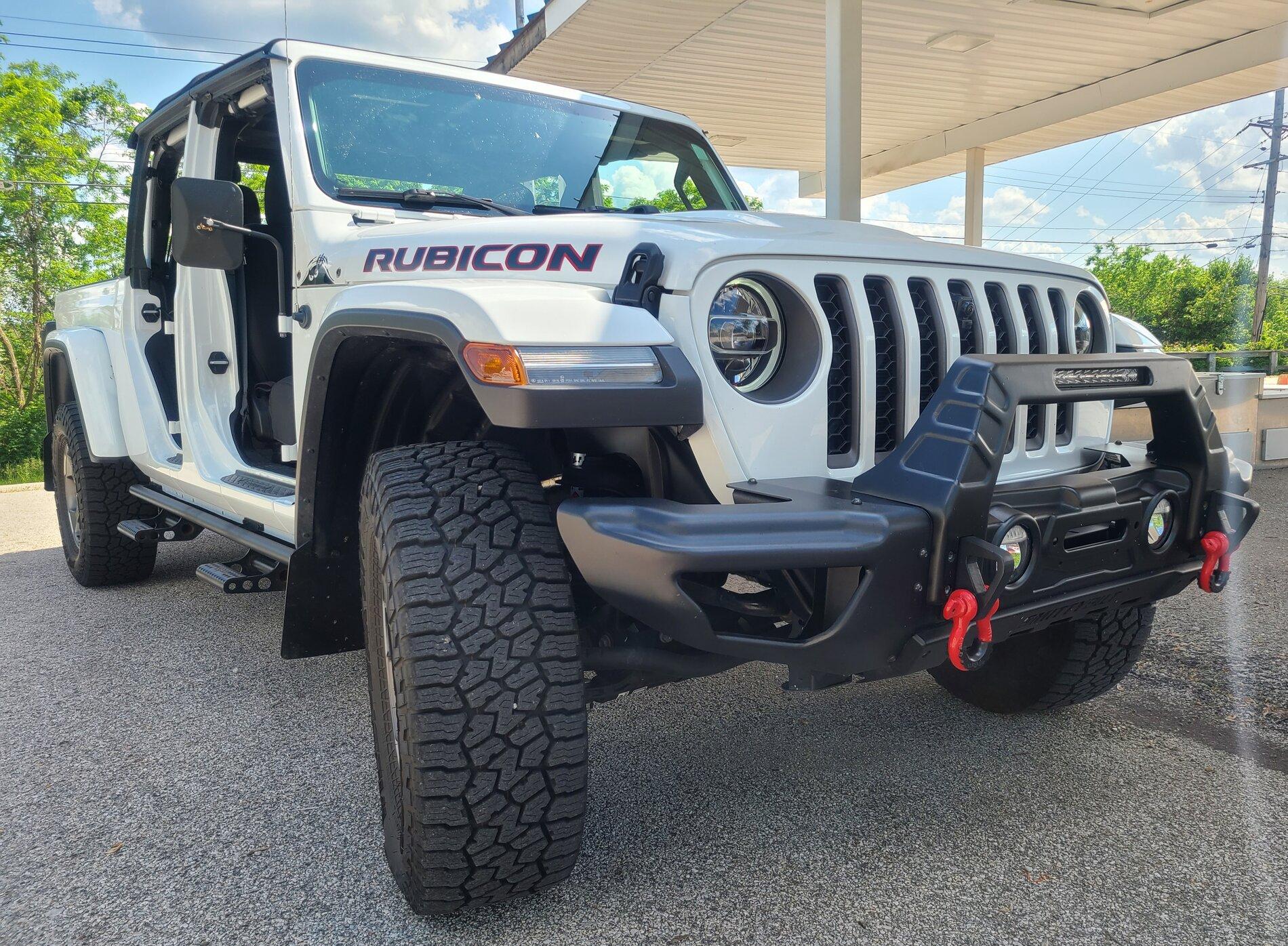

If you plan on doing some “serious” off road, go stubby. Ask me how I know.
37s and 3” lift I was rubbing the “wings” on my stock front bumper all the time in my most recent visit to Moab. 1 week later I switched both front and rear.

I wanted matching @RebelOffRoad rear bumper. i haven’t experienced any real issues with the rear other than the typical hitch drag. in addition to having added the “steps” on the side gives me something more substantial to ”slide” on if needed. Side steps are heavy heavy duty.
Front plastic bumper OEM “wings” on the other hand was rubbing like crazy on recent trip. Enough so that I was concerned I would lose a front tire or get stuck because of level of articulation rub.

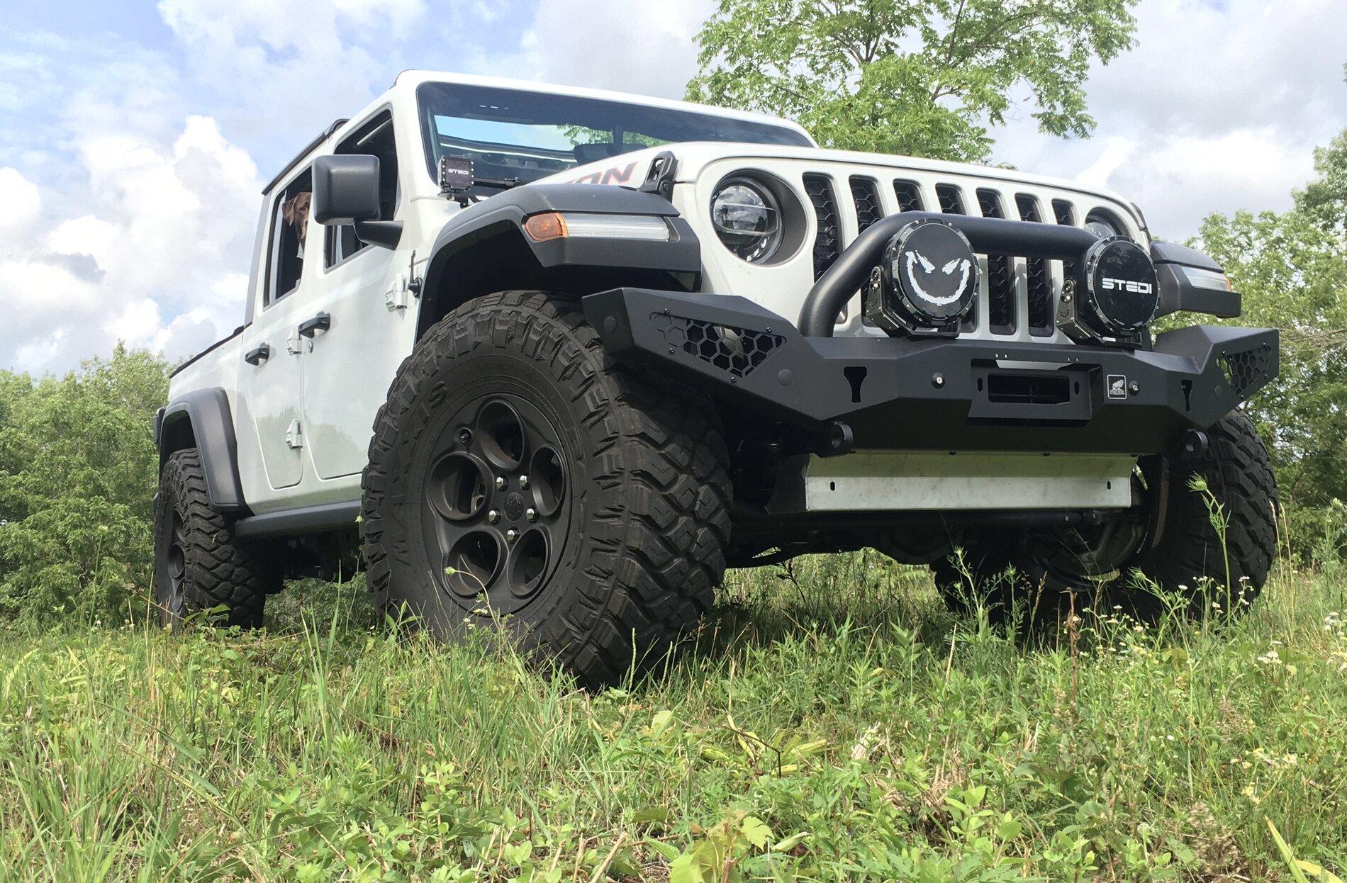

I wanted a bumper that has a welded In recessed winch plate, (waiting for backordered winch), works with factory fog lights, and one that wasn’t so popular where everyone has it.
