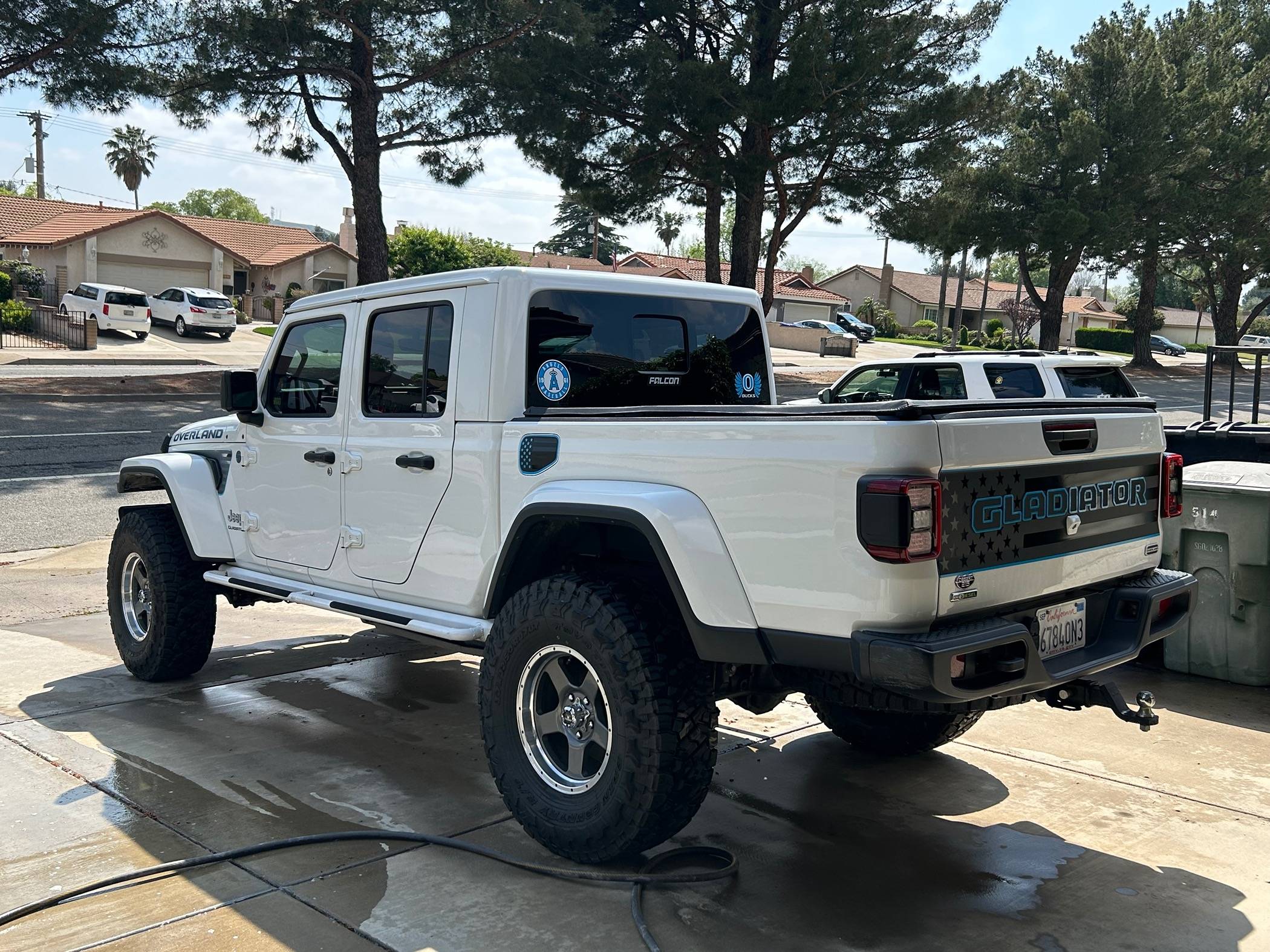

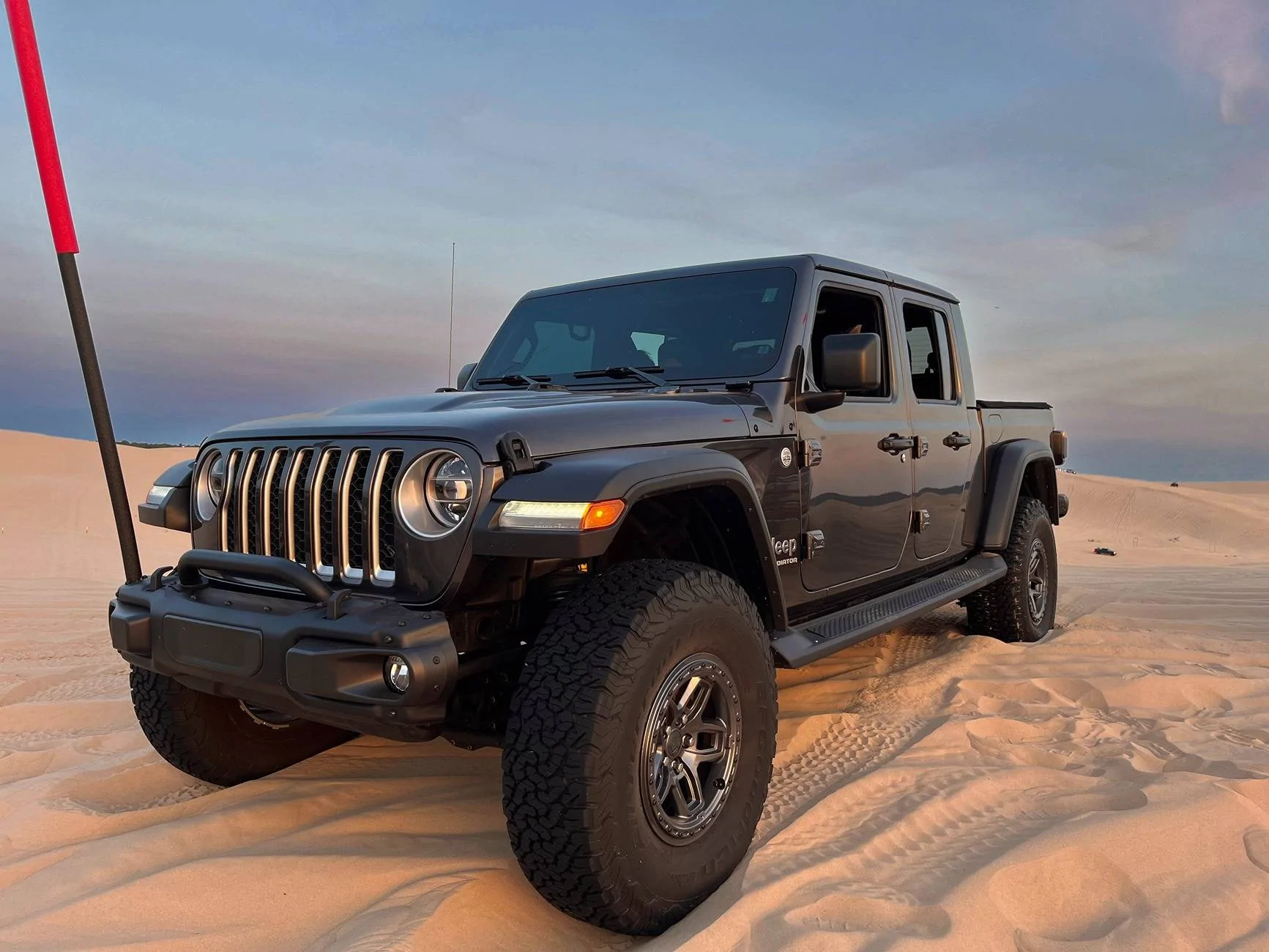

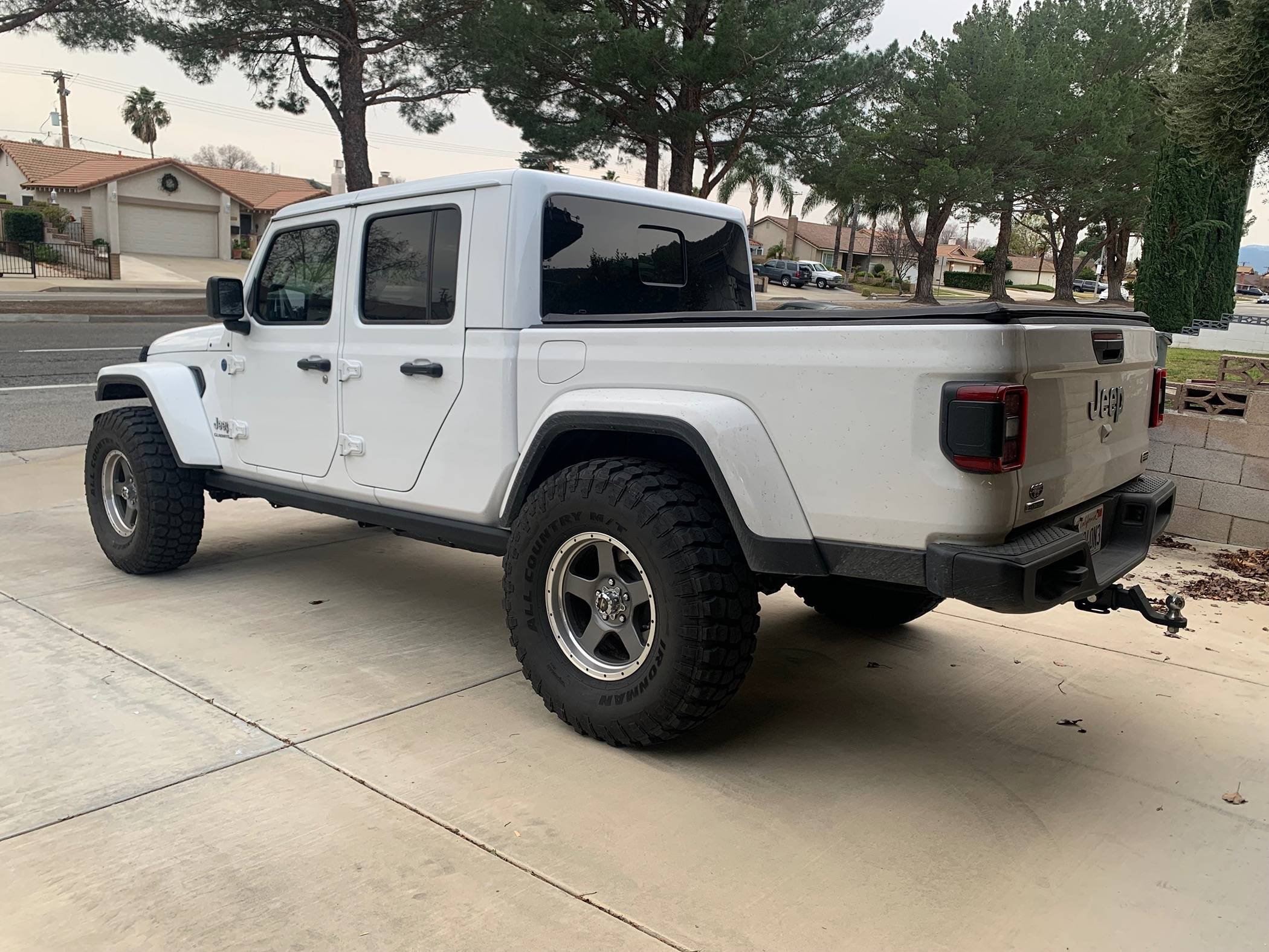

You’ll have to double check the spare, I can’t remember if it’s a 17 or 18ā€ diameter. Aside from that, you should be fine on clearance. What’s the specs on the AEV wheels as far as offset? I run 17x8.5 -6 offset on my overland and don’t rub anywhere. I did 2ā€ spacers up front on 37s with standard fenders but never wheeled it hard on that setup. Now I’m on 4.5ā€ lift front and 3ā€ rear on 37s and have miles of room to spare. I also don’t disconnect because I’m pretty sure I’ll lose the stock driveshaft if I do ?
2ā€ up front, stock rear on 37s
Jeep Gladiator Wanting to Lift 21 Gladiator Overland 69284155747__EF71939F-A26A-42FE-B039-2B192834400D
4.5ā€ up front, 3ā€ rear on 37s
