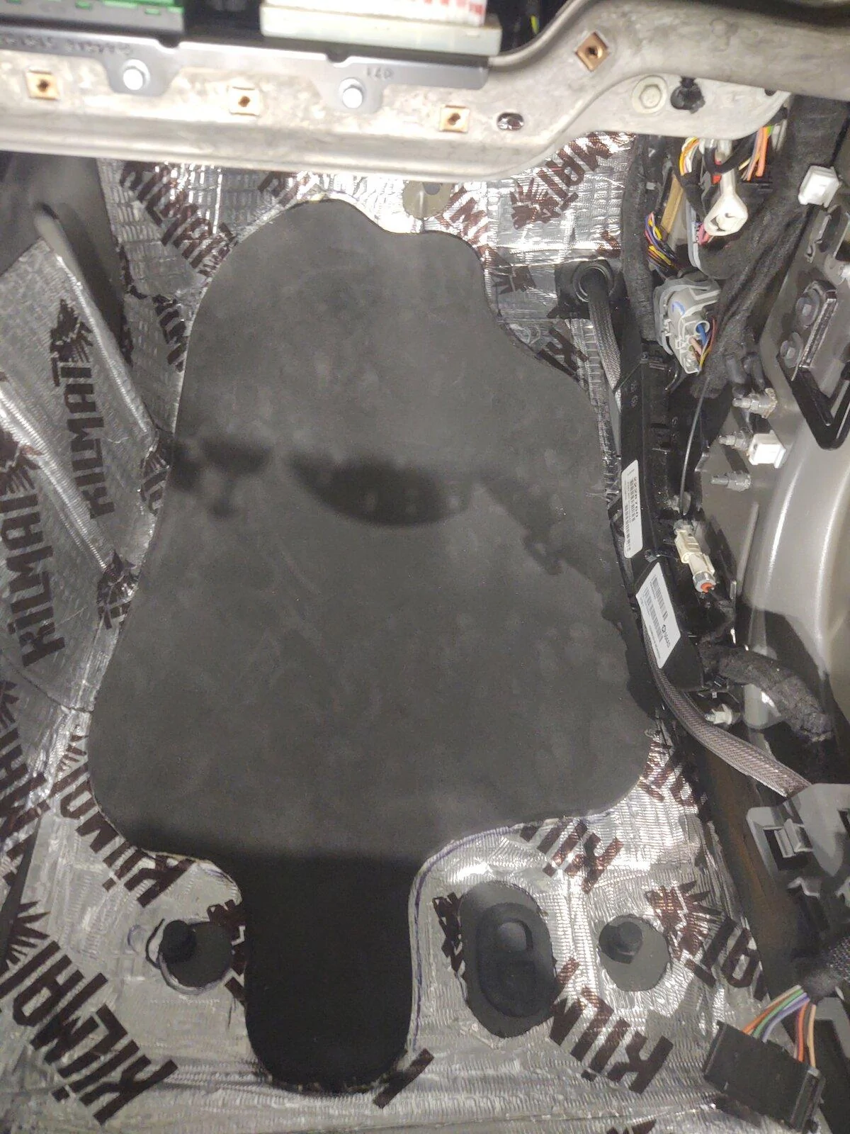

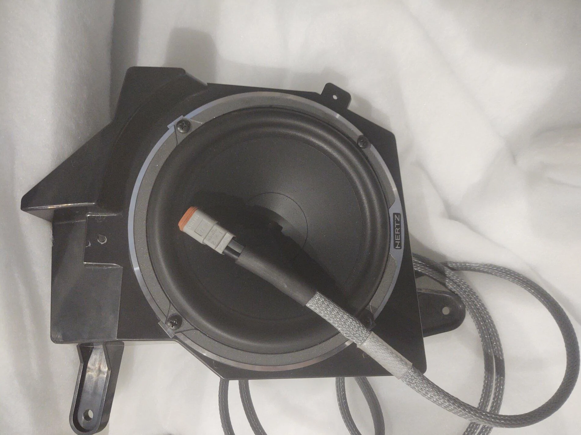

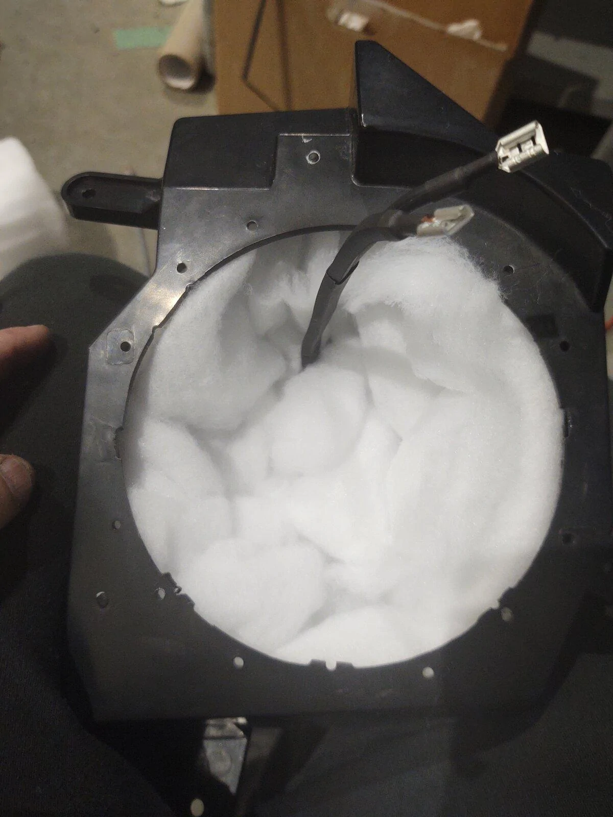

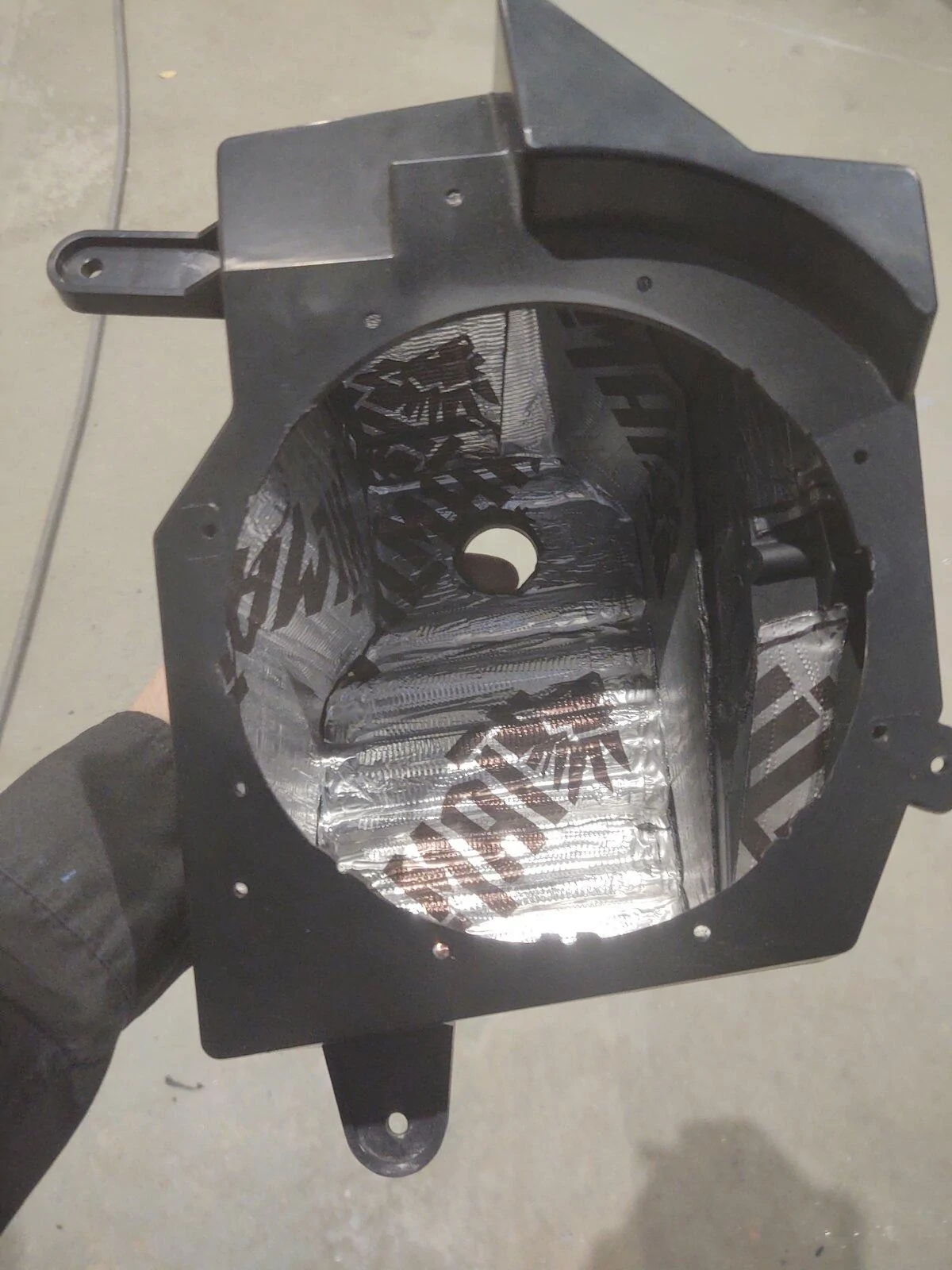

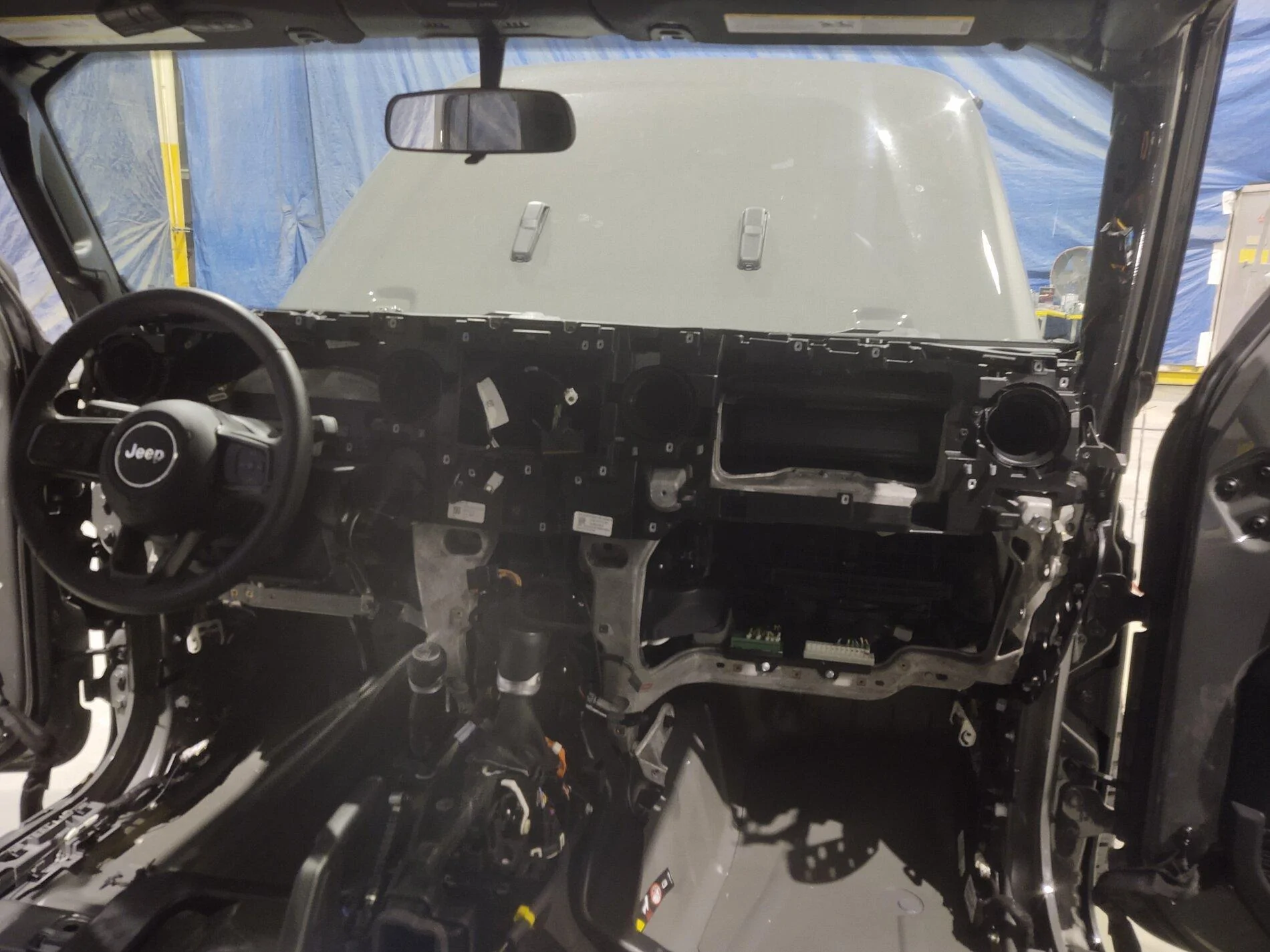

I haven't had an upgraded sound system since I was a teen. I am going for a Sound Quality system as opposed to Big Bass. I am in the process of upgrading all of the Driver's. I have started with a Hertz Mille Pro 3 Way Component up front for a center stage and I am adding a single 10 inch JL Subwoofer. The 6.5 Mid Bass will go in the Dash via Metra Enclosures. It was difficult to install. I had to remove the entire dash to install these. The 3 inch Mids will go on top of the dash in the Factory position. The Tweeters will go into the A Pillar. The Subwoofer will be enclosed in a down firing box placed under the back seat. I will also be adding some Hertz 6X9 in the Sound Bar up top for rear fill.

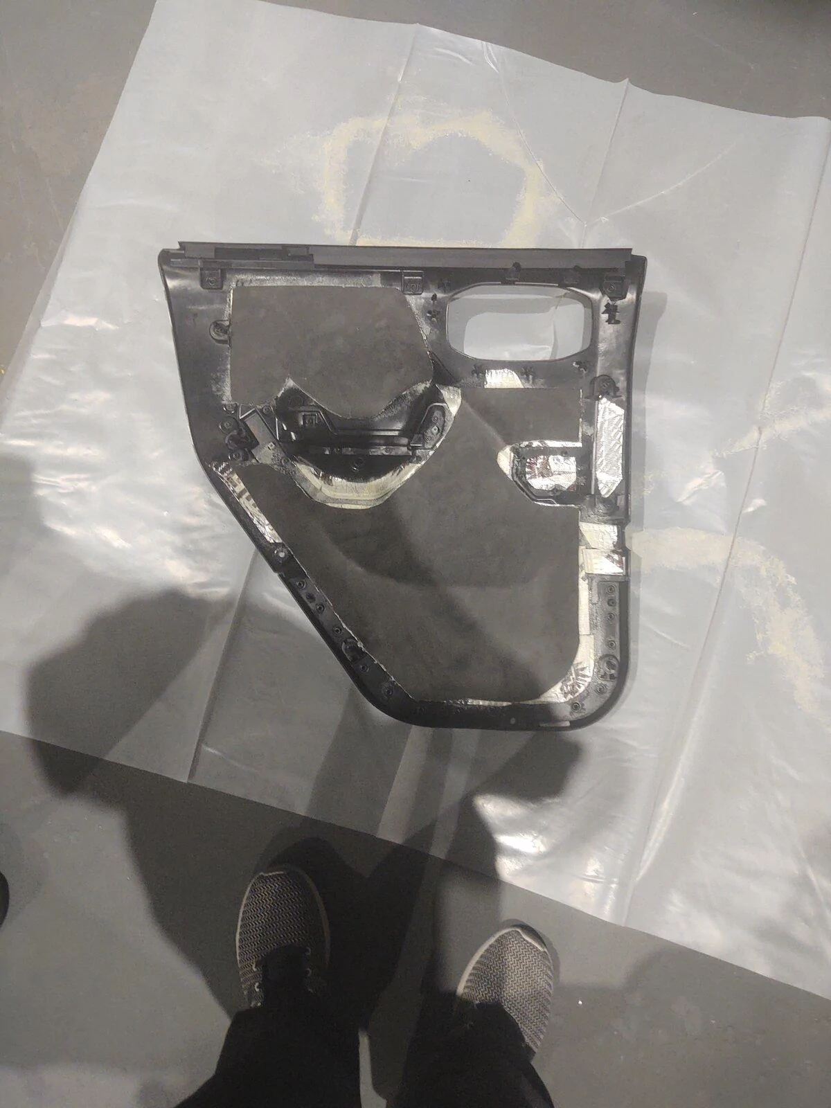

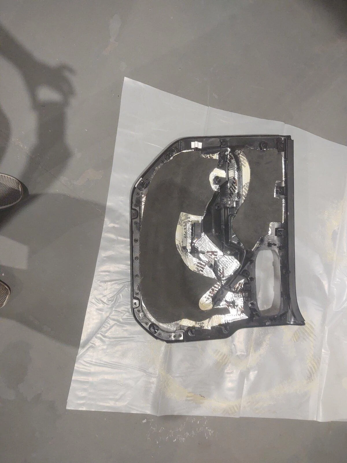

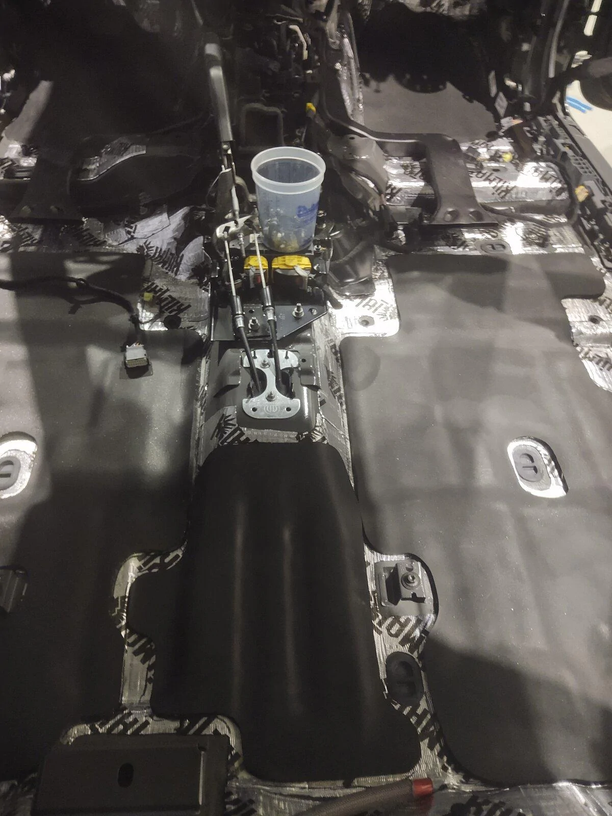

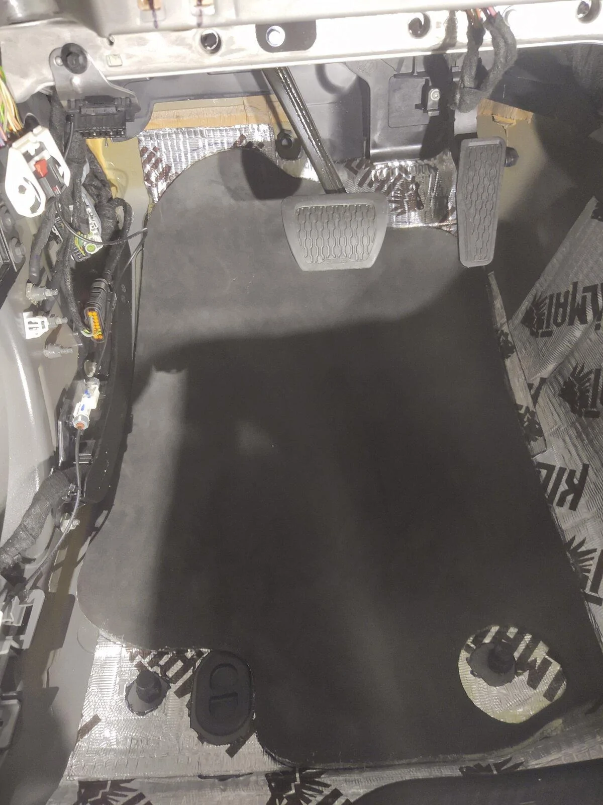

I just tore out the entire interior to put in sound dampening material, and Closed Cell Foam to decouple the interior plastic panels. I have plans on putting some additional Sound Dampening Material on the Roof as well as some DIY Foam Interior Panels on the roof. I am still waiting on the fabric for that. A Buddy of mine is laser cutting some Jeep Logos and Script to add to the roof panels. I may add some Mass Loaded Vinyl to the floor to get rid of any unwanted road noise. That really depends on how everything sounds once all of the components are added and I am able to determine if it is needed.
The amplifiers will be mounted in an enclosed Amp Rack that will be mounted on the back wall of the Cab that will be hidden by the back seat. I will include some fans to keep everything cool. I will also include a few LED lights for the Amp Rack only to be shown when I want to reveal the components to friends and Family.
