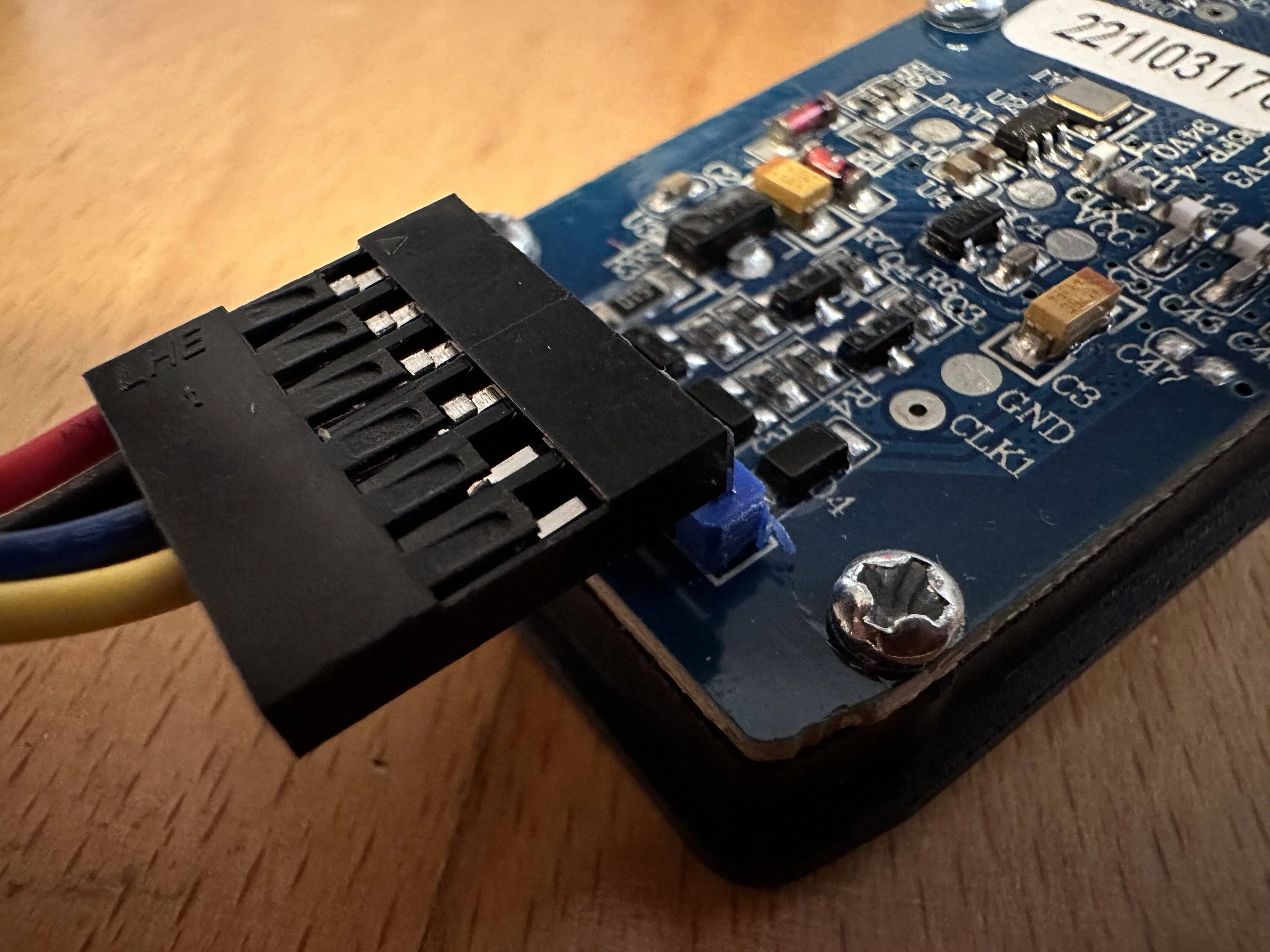

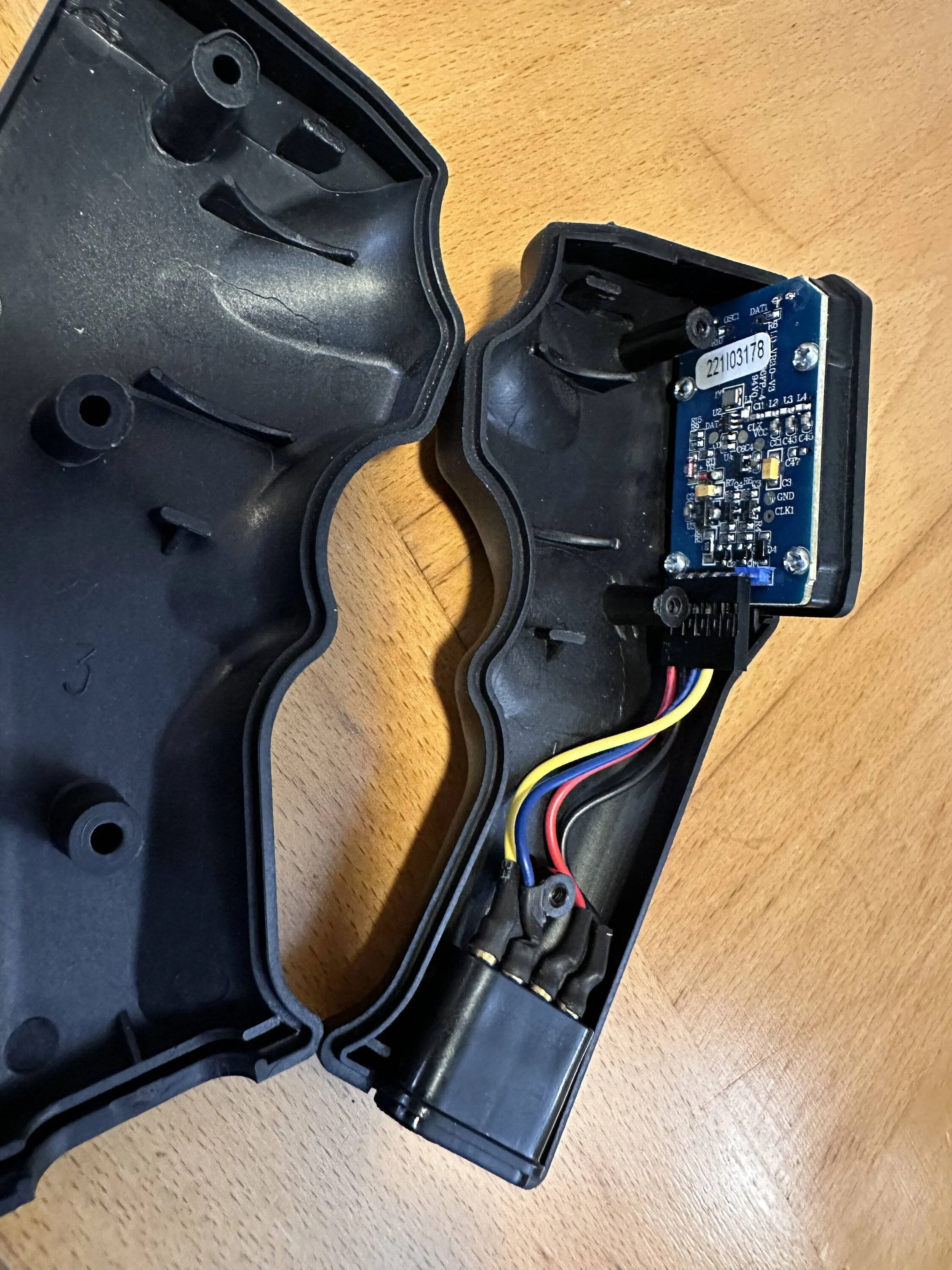

How about this: it’s a standard thin molex between the PCB and the battery & port. Use a pick to gently lift up the thin plastic spring lock, and de-pin the grey and white battery wires. Take a picture like this:
Jeep Gladiator Warn Winch Recall 483CA026-9081-4A46-B5D9-61A76713D09C
Jeep Gladiator Warn Winch Recall A6020F35-191A-4881-A7FE-140B408CE18F
Submit for claim. None of anyone’s business what happens after that

Can we all use your pictures?
