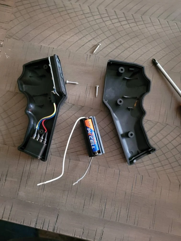

Submitted my recall request. I depinned the wires instead of cutting them.
Jeep Gladiator Warn Winch Recall Resized_20230210_153528
Cleaner job. I also informed them of corrosion inside the remote.
I also unhooked the power cable for the winch, need to get a power interrupt switch. Originally I routed the cables in a way that I wasn't worried about them rubbing through or getting pinched in a wreck. But, having a possible glitch in the remote power up the winch on its own has me second guessing no interrupt switch. Ran my last Warn winch for 30+ years with no interrupt and no issues.
I'll follow up as I hear from Warn.

I de-pinned mine as well, got approved no problem. Should have the gift card within this week as well.
It's actually a code that is e-mailed to you, good for $100 on Warn.com. Then again, there's not a lot of $100 items on there....
