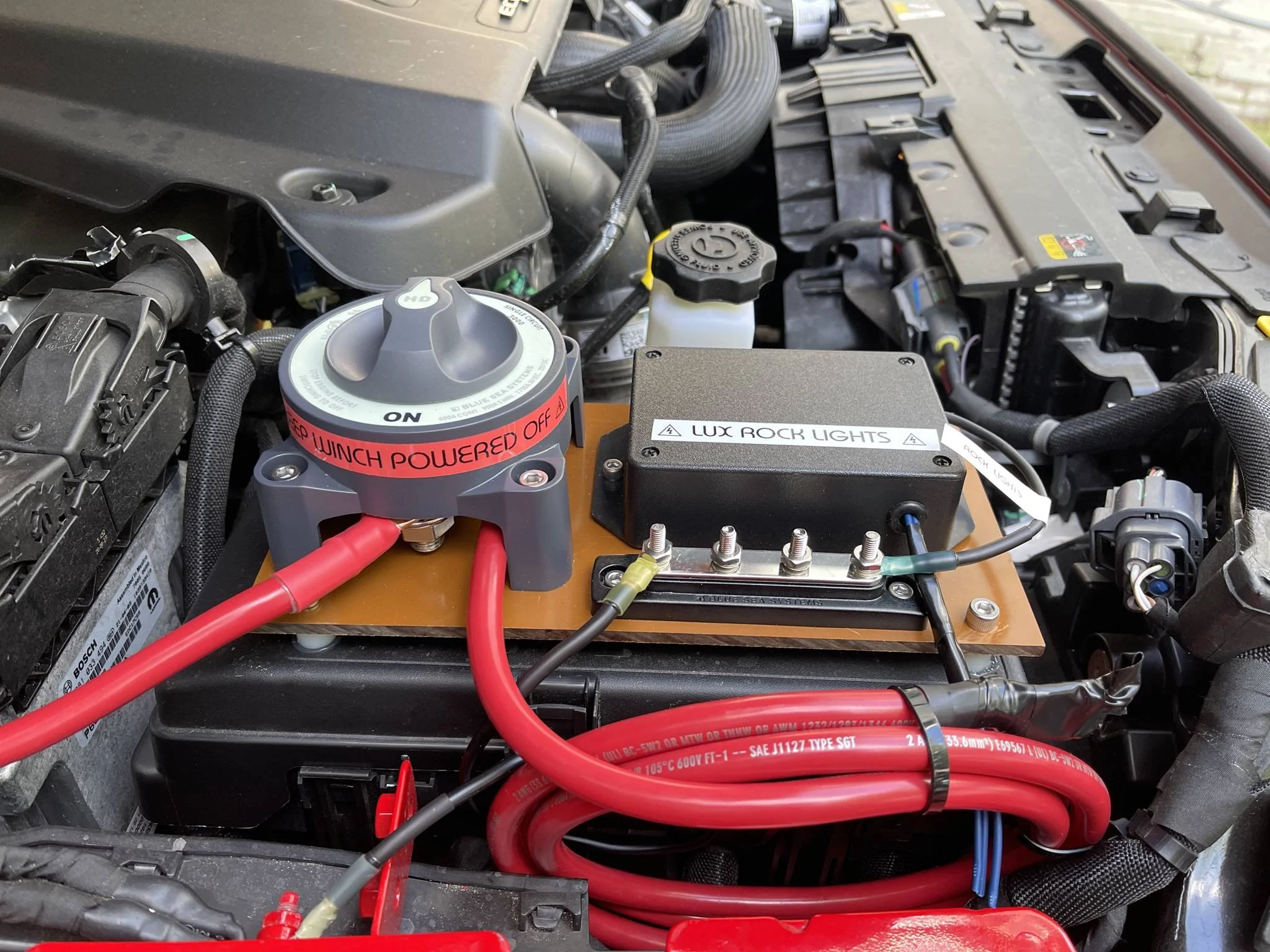

Upon learning that the VR Evo I had just bought had a wireless controller, my first thought was “cool”. My second was that it was a major safety issue. Concern over the remote is only half of it. Unless, that remote uses a rolling code, which I doubt it does, then the wireless receiver is just as much of a concern as the transmitter. And that receiver sits out in the elements all day everyday.
It’s good practice anyway to install a winch cutoff but I cannot imagine installing a wireless capable winch without one. I used an overkill BSS 3000 so it would take the current instead of that overpriced POS cookie cutter battery cutoff Warn and everyone else sells.
No, the fuse box isn’t compromised at all. Yes the hood clears fine. There’s not a lot of real estate under the hood of the diesel Jeep. That brown board is a slab of Micarta. The bolts are rtv’d, and I keep a picture of the fuse map on my phone. The switch is labeled for the idiots and to justify my Brother label maker’s existence.
