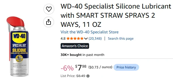

Check to make sure that one of your latch devices is not fully locked. Exact thing happened to me a month ago. I pull the panels and clean all contact surfaces, then wiped down with this silicone for seals to keep them in good shape.
Jeep Gladiator Water intrusion Freedom panel question 1781658162688-9a
