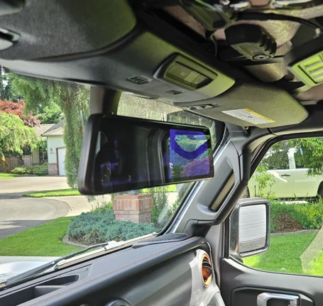

Mine leaked again the other day, right above the rearview mirror. All looks good as far as alignments and fasteners. The seals are in pristine condition. What gives?

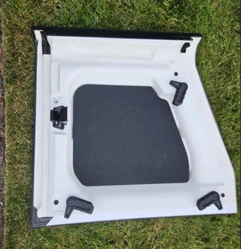

The vehicle is always garaged when parked at home and very well taken care of. All seals are in pristine condition. I did some research before removing, cleaning, and applying this product lightly. Then just careful alignment and securing. This was on a level surface the whole day and presented after hand washing the jeep with a garden hose in the driveway.

I would only add that the 2023 Gladiator (14k mi) and had the tops removed once when I first purchased to install an overhead molle panel right after I bought the vehicle, and now to address the water migration.

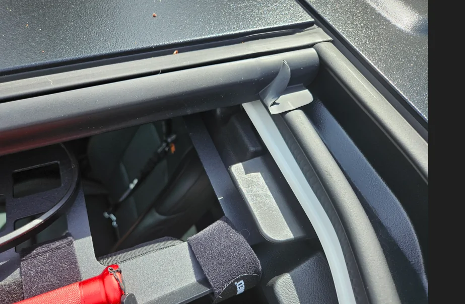

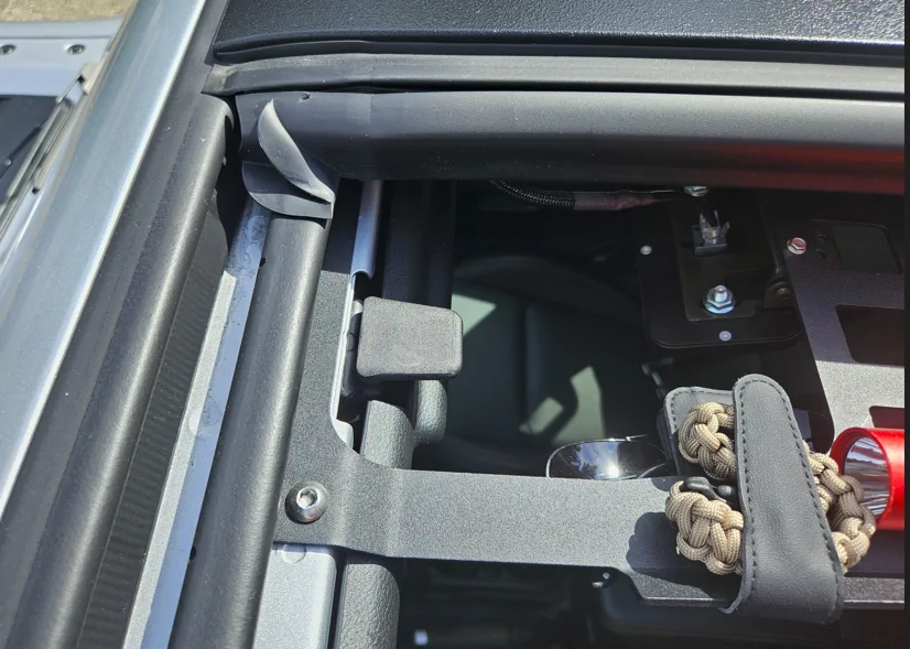

See attached. Checking all the latches was the first thing I did when I saw it leaking to make sure they were fully locked in. It is leaking from the rearview mirror cover and onto the center console. Seals all appear in great shape, and I see evidence of uniform pressure along the seal mating surfaces. The bolt head holding the molle panel in place appears to be too low-profile to be the culprit, or interfere with sealing, and I don't see any water path across this area. Let me know if you spot anything, or need more photo angles. Thanks.

I said this earlier in the thread, when I had water leaking through the vents in the rear view mirror cover, replacing the top of windshield gasket stopped the leak. Visually, I could not see a problem, I had cleaned and lubed gaskets, checked/adjusted latch adjustment, nothing worked. Dealer insisted that windshield gasket was the cause, they replaced that to no avail. Only at my insistence did they replace the top of windshield gasket and , problem solved.
