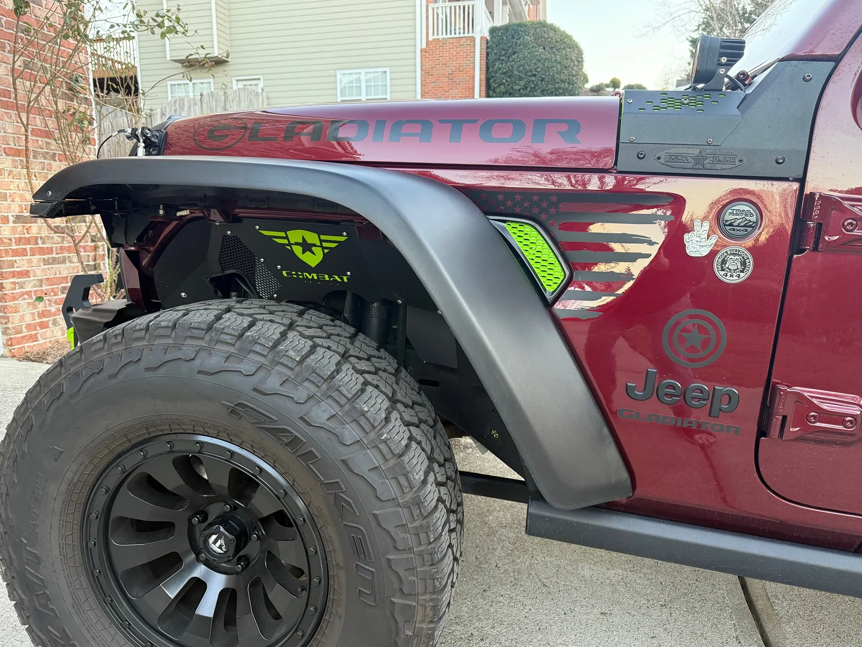

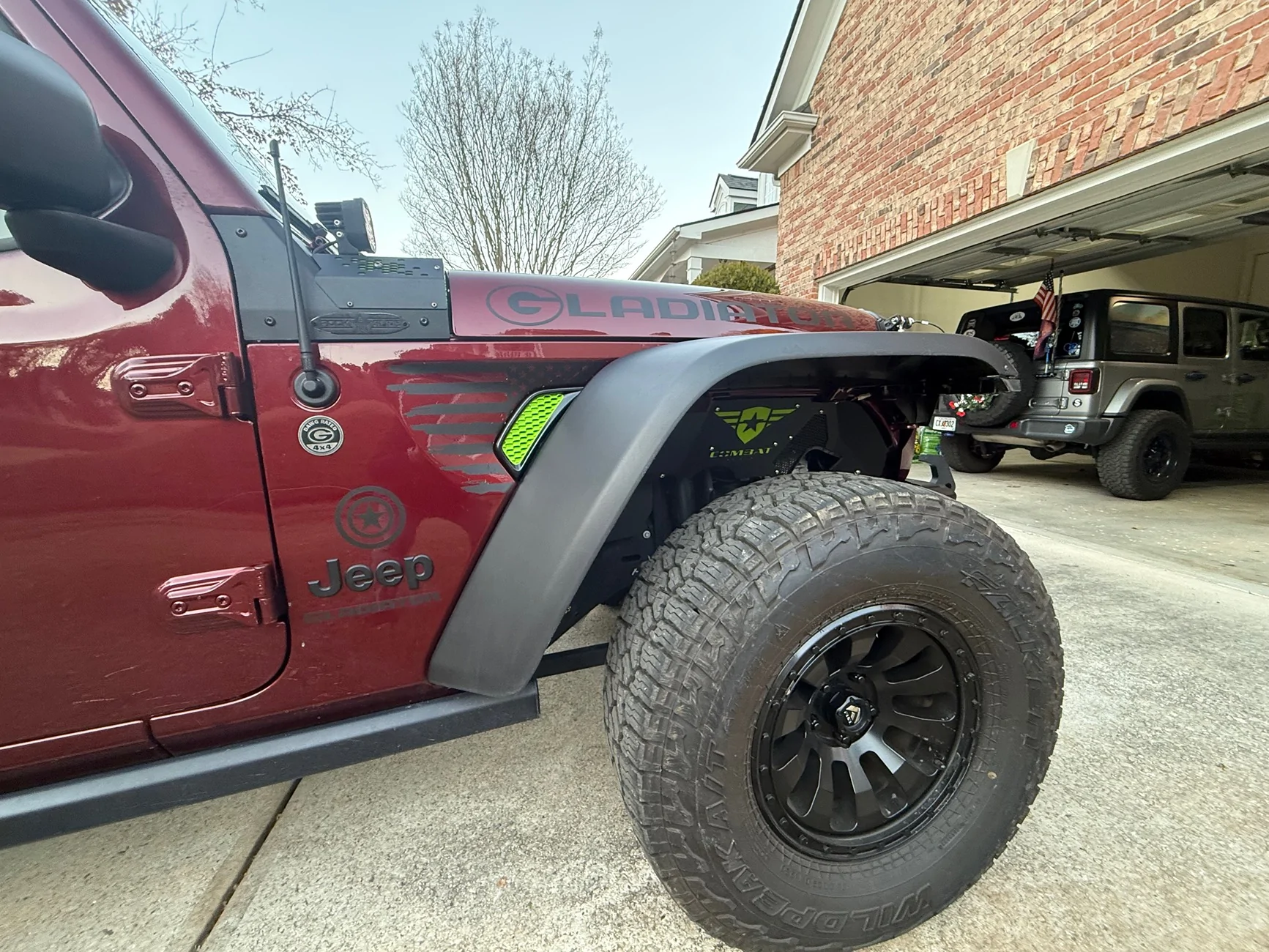

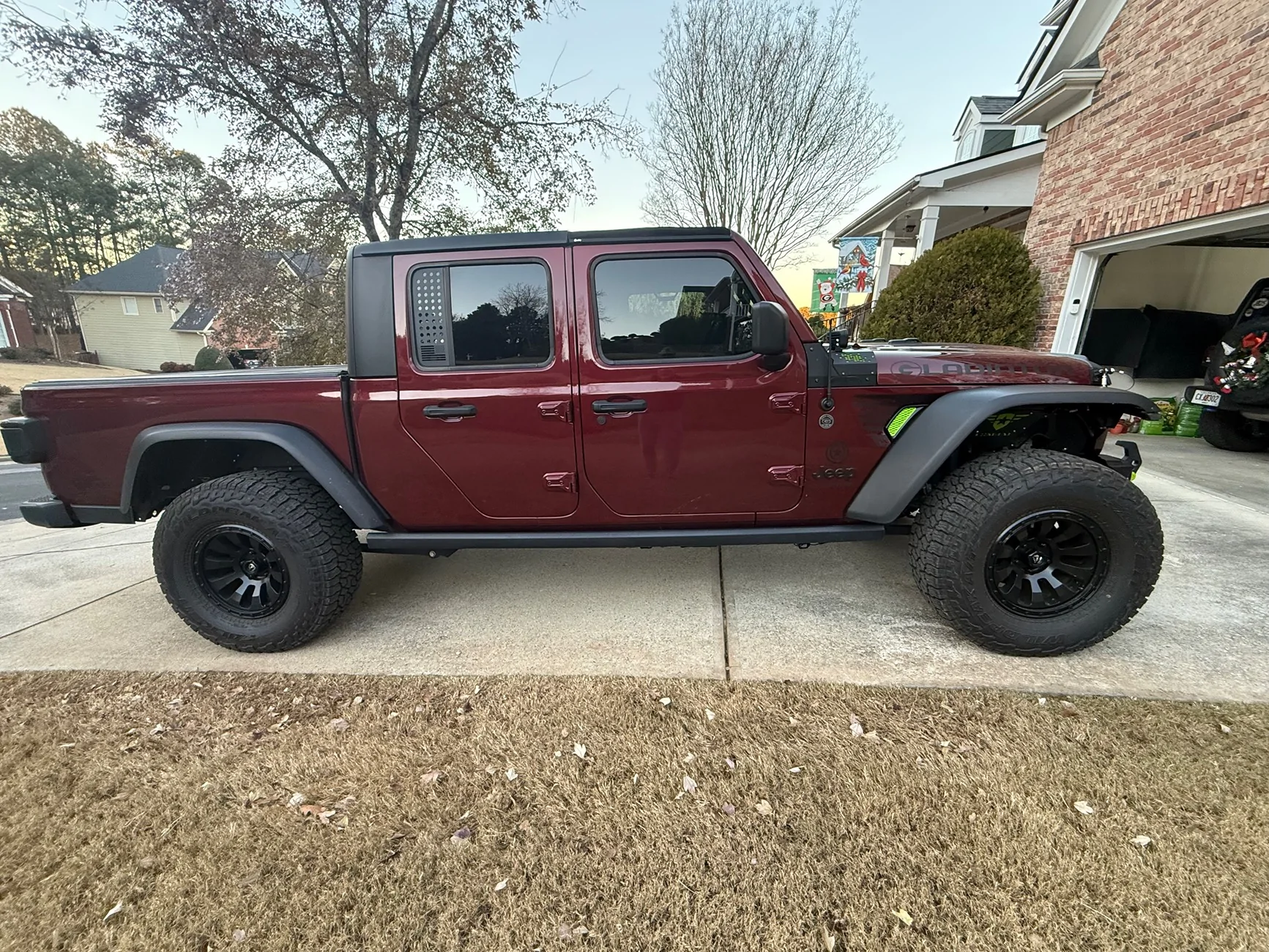

I went with the Infinite Offroad fender chop kit and I put in Combat Offroad Fender liners. I did have to trim the fender liners somewhat due to my Apex Autolynx disconnects.

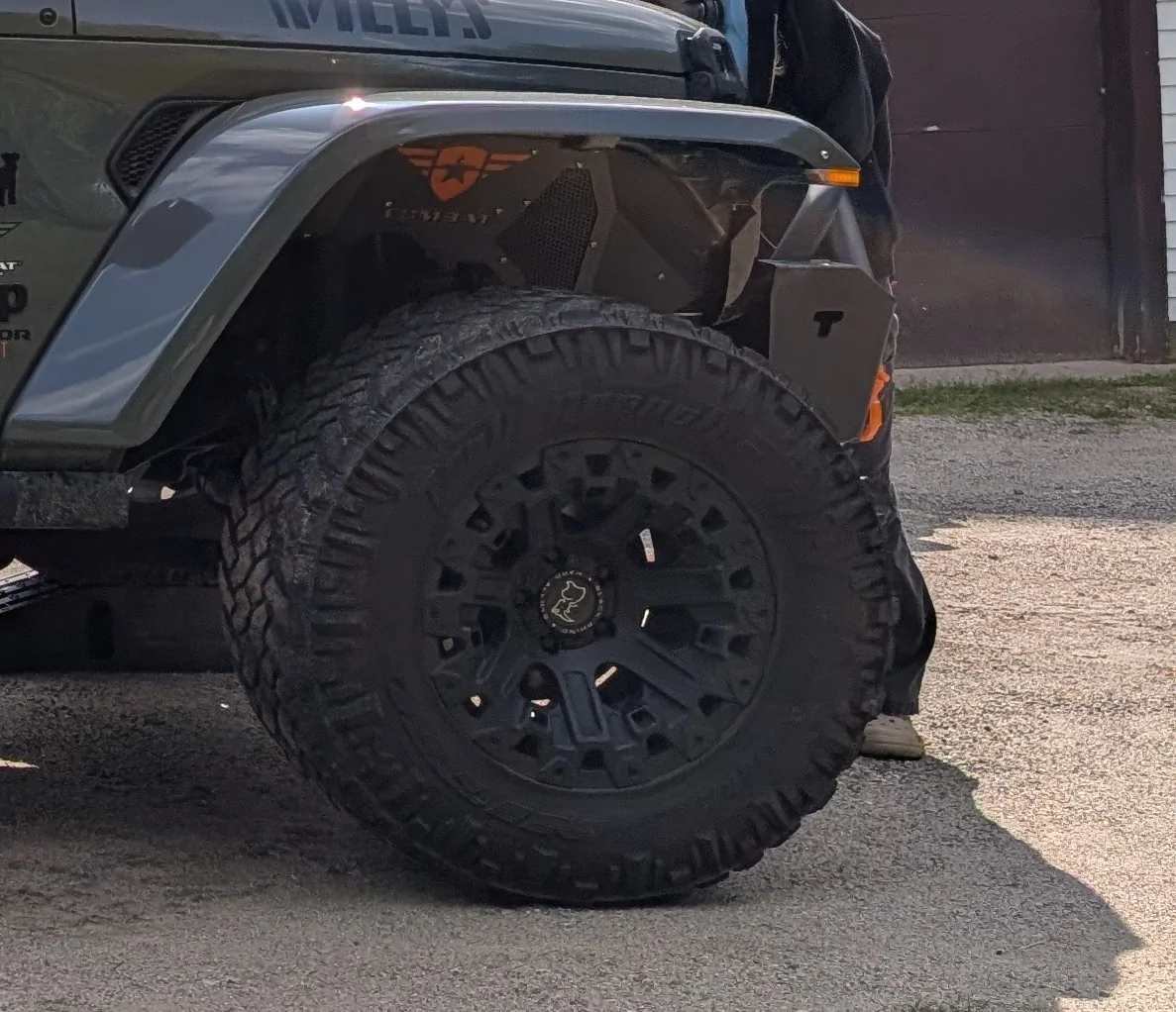

I really love my combat off-road ones. Not the cheapest but the fit and finish are top notch. I also love that they are aluminum under the black finish. All my others have rusted out before.

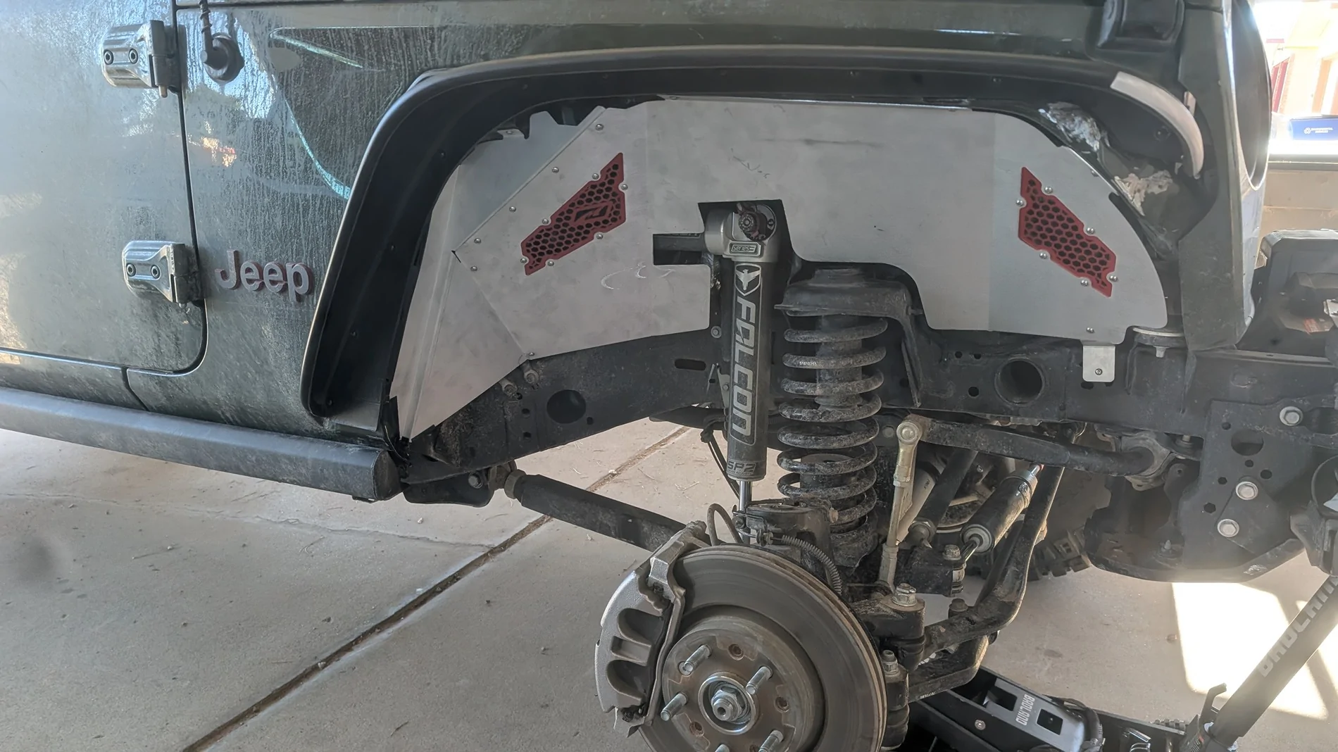

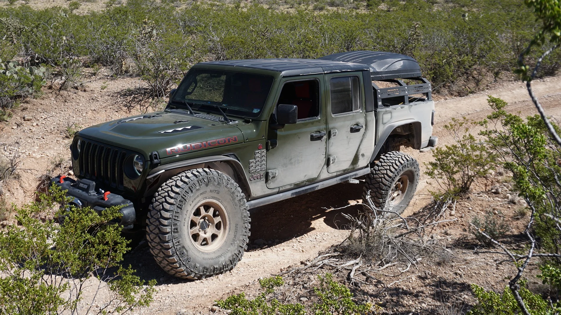

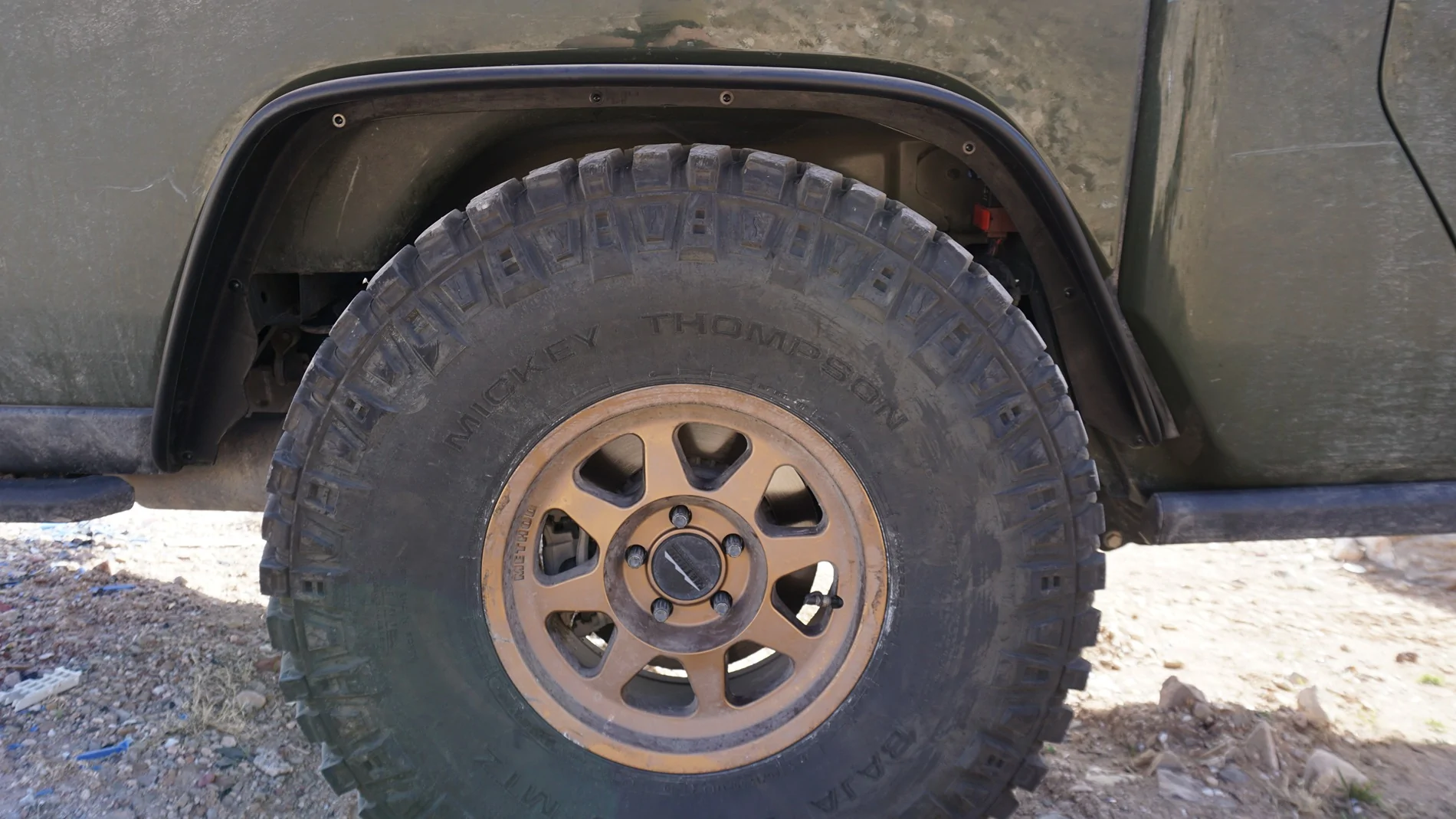

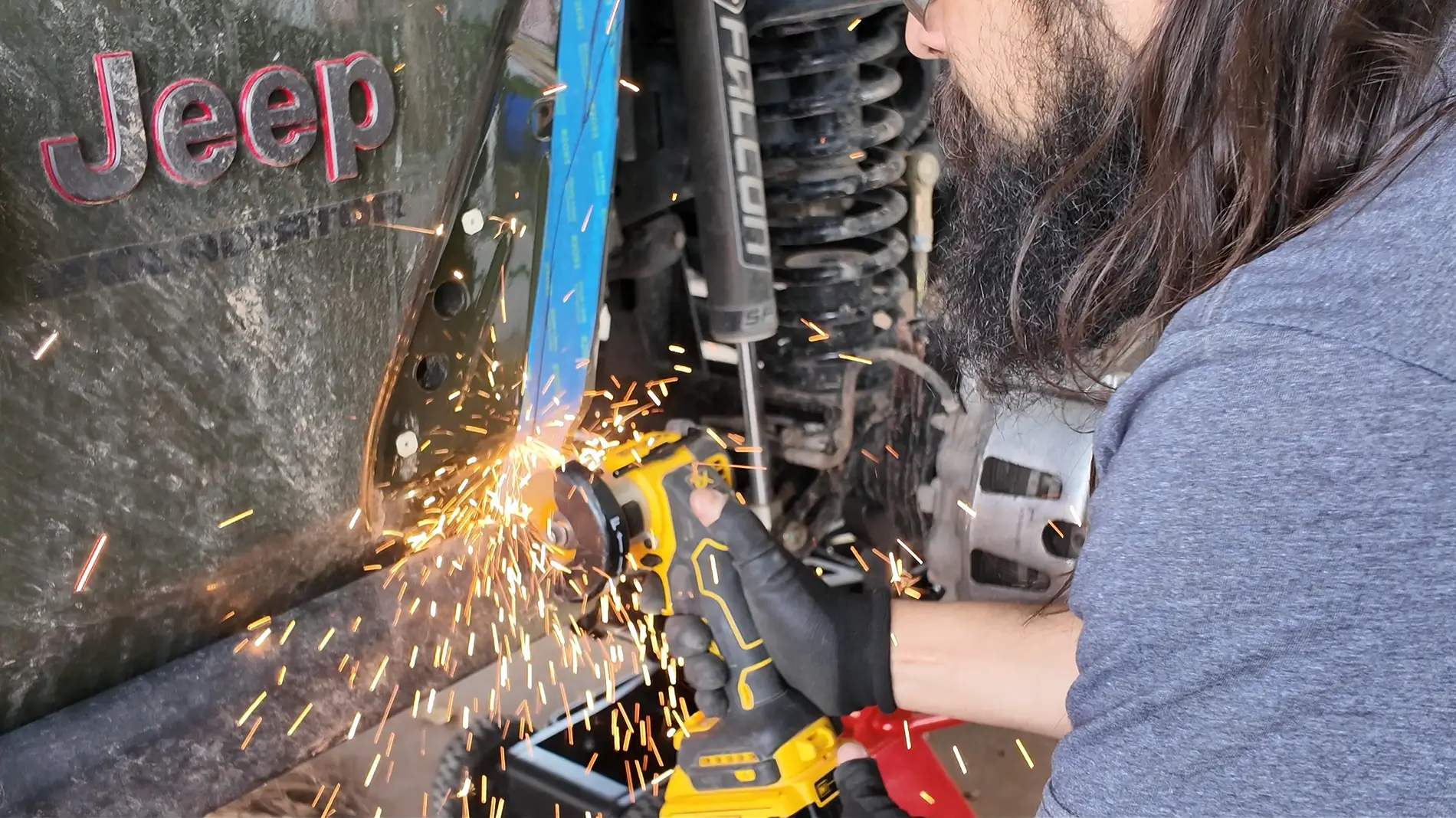

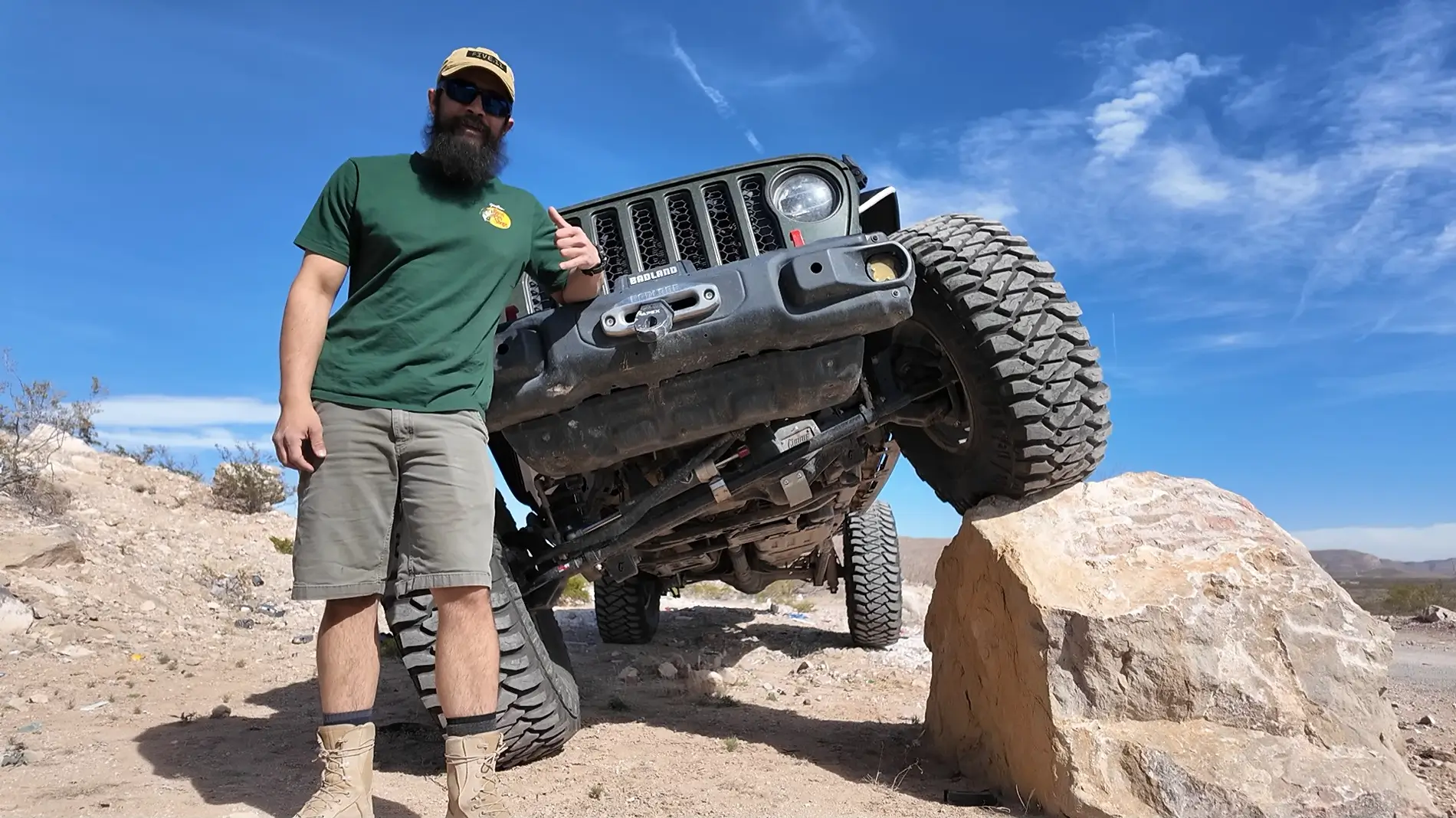

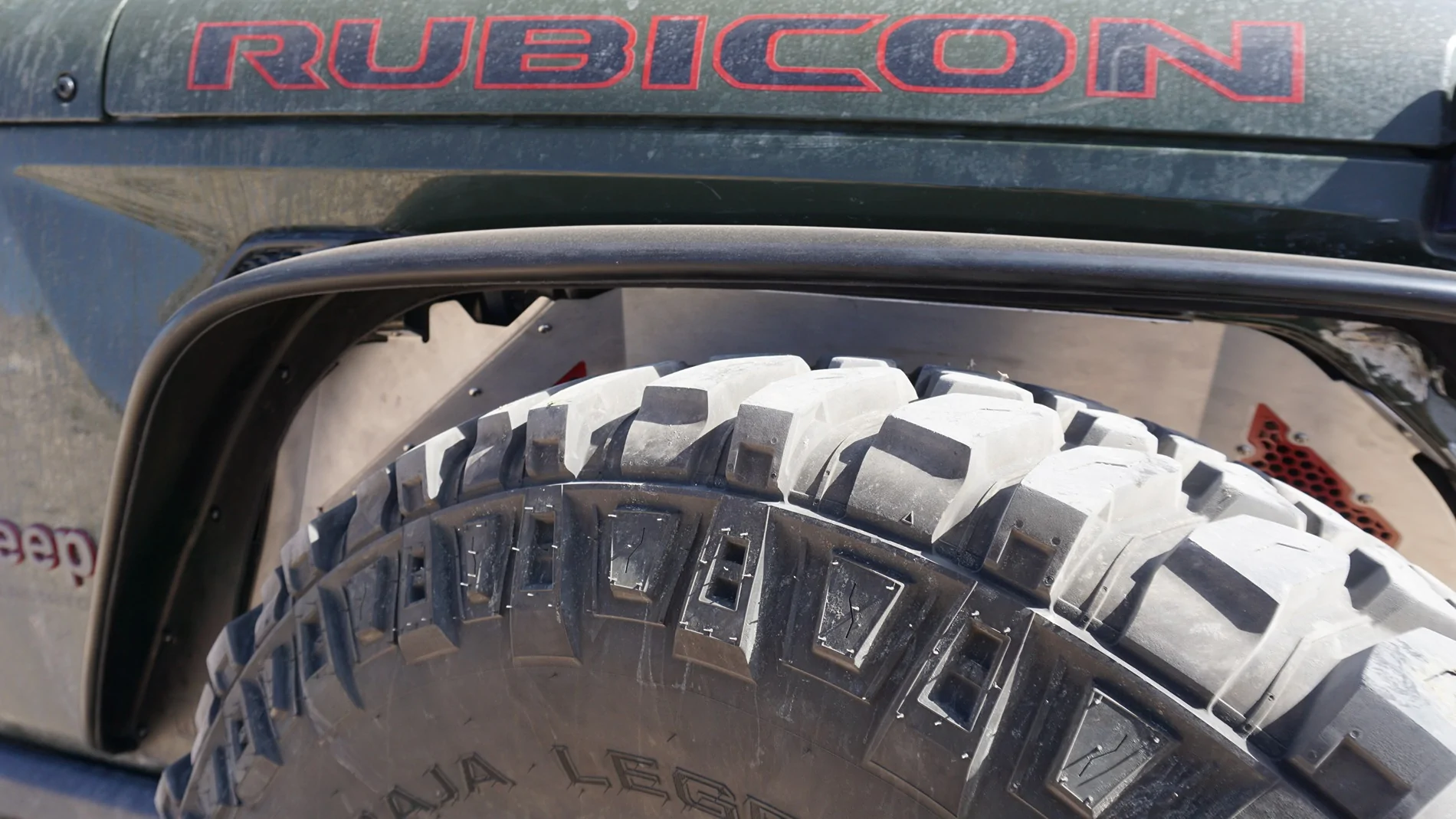

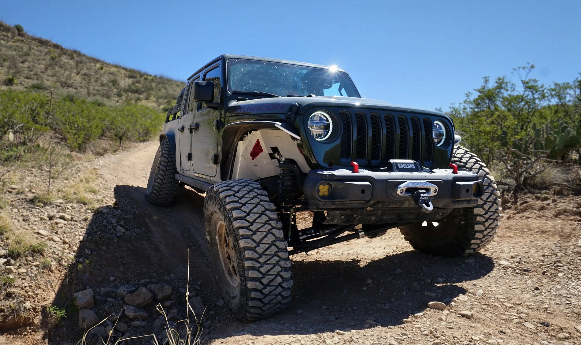

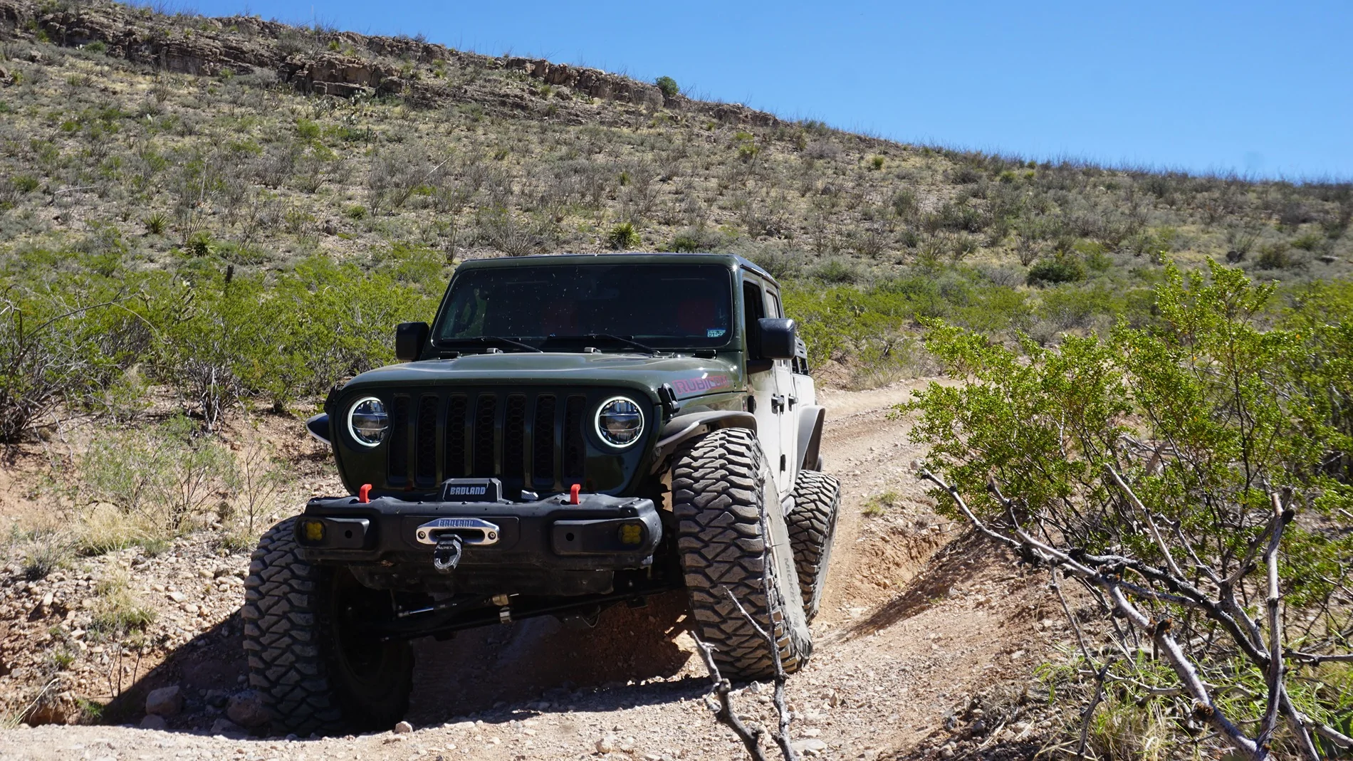

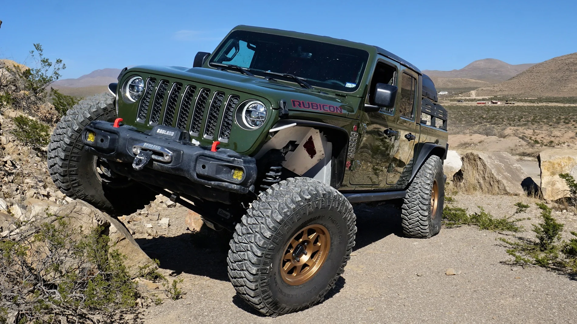

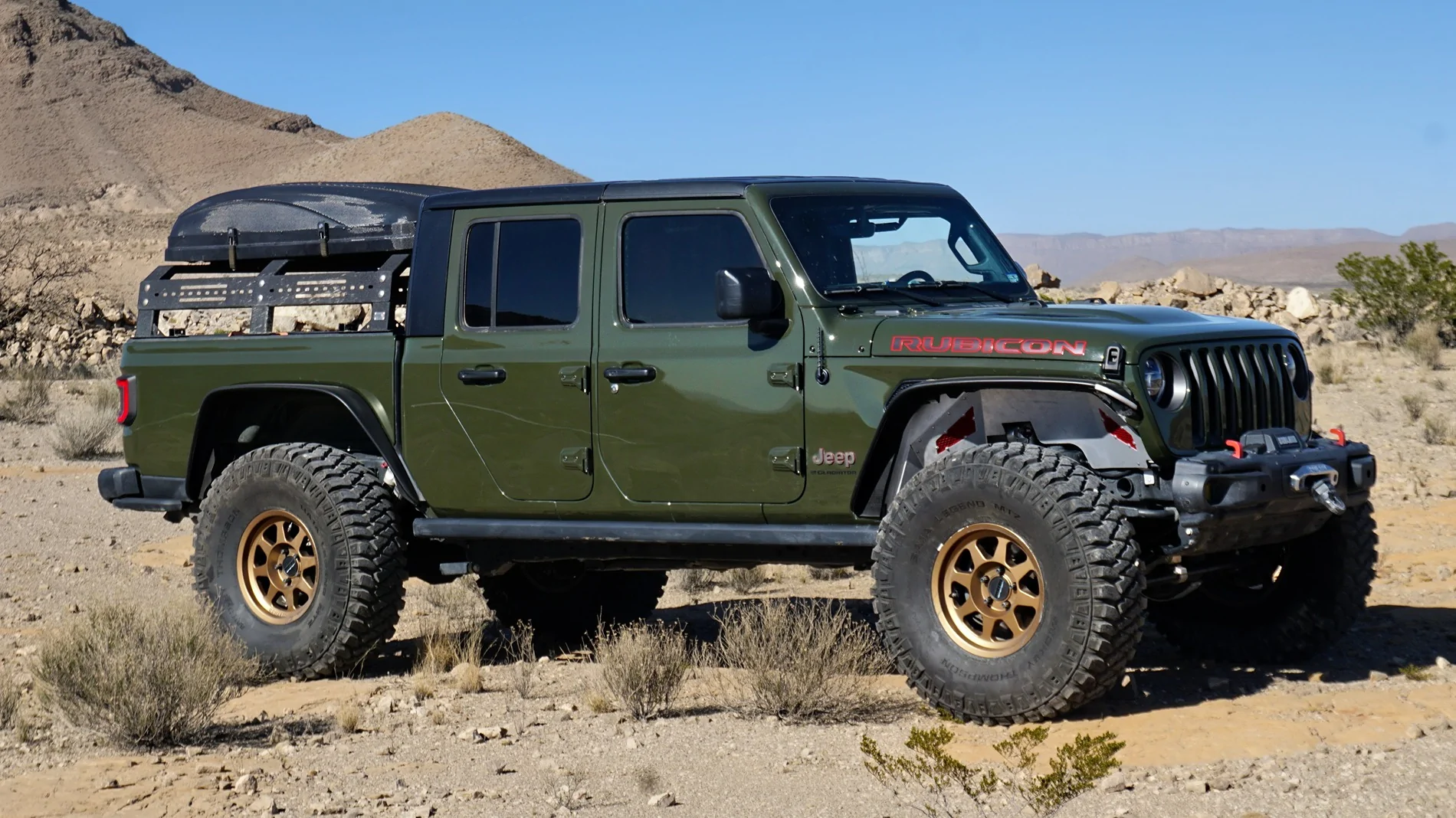

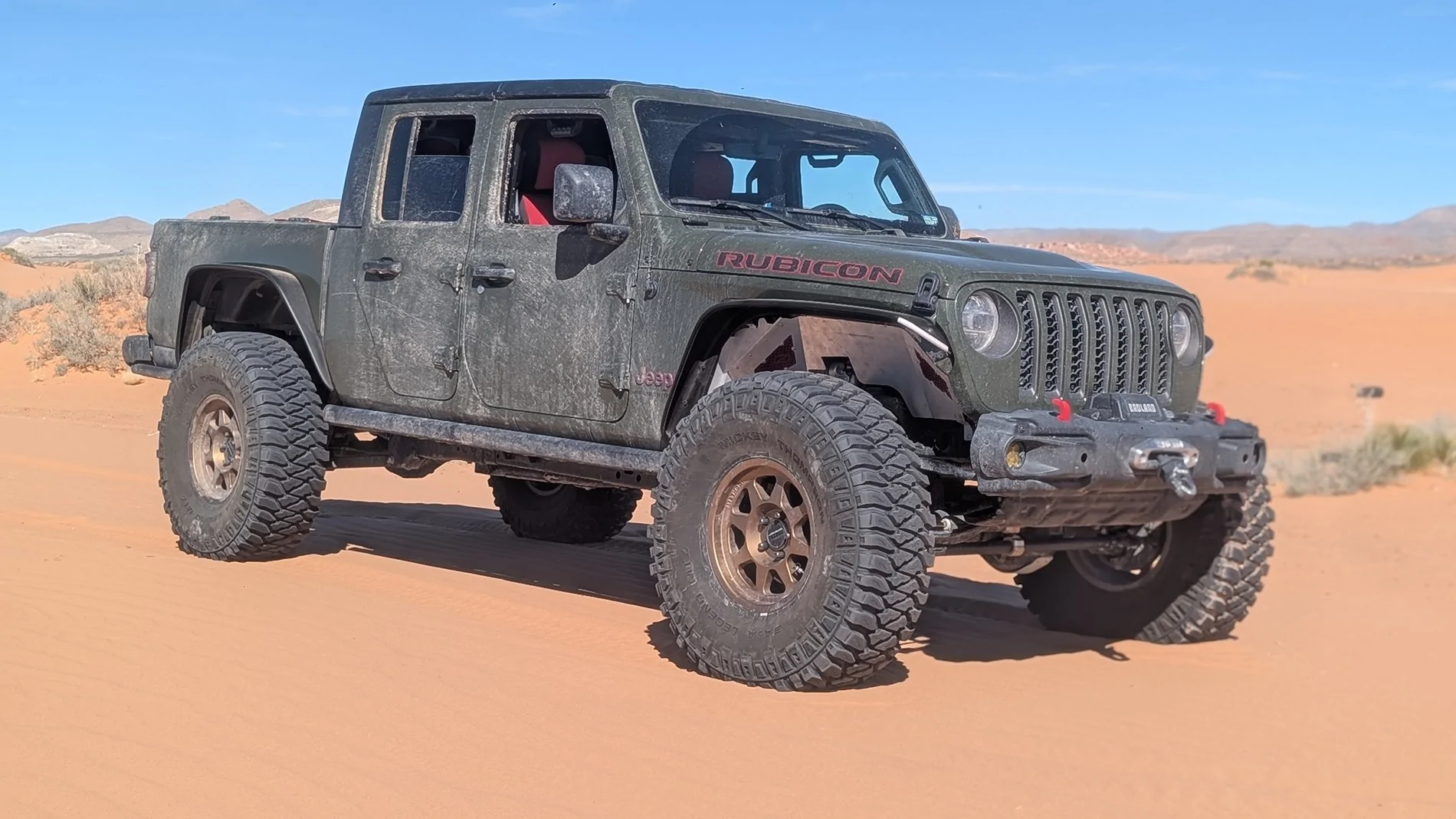

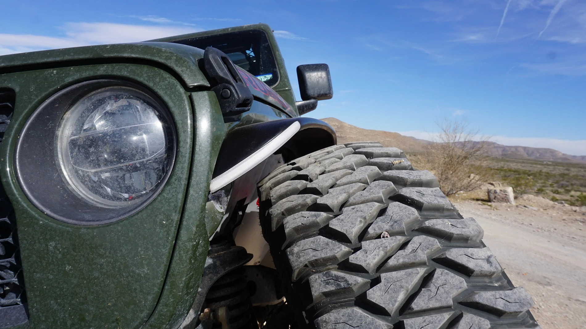

The motobilt inner fenders for 40s required trimming the body, but it was worth it to clear the 40s on a 2.5 in lift.

I don’t think I’ll be running 40’s anytime soon but I’ll definitely keep it in mind if I do. I think Motobilt had a pretty decent sale recently too.

40’s on 2.5” is the bee’s knees. How’s the flex with that setup? (Sorry for the thread jack)

These 40s measure 39.1" mounted on the jeep at 27psi which is pretty nice for ground clearance.

I like their normal inner fenders as well. The bolts they included are 3/4" but they were too long IMHO. I cut them down with my grinder so they didn't rub.

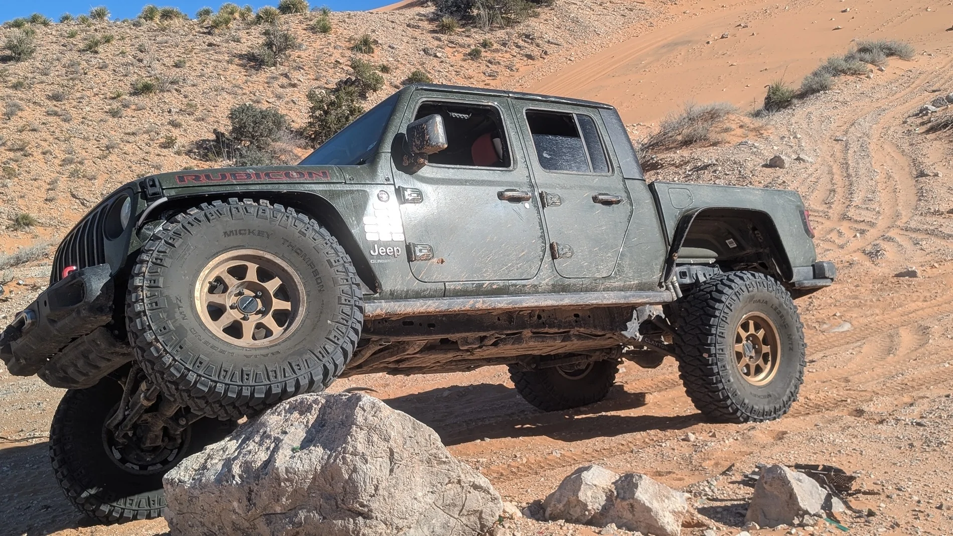

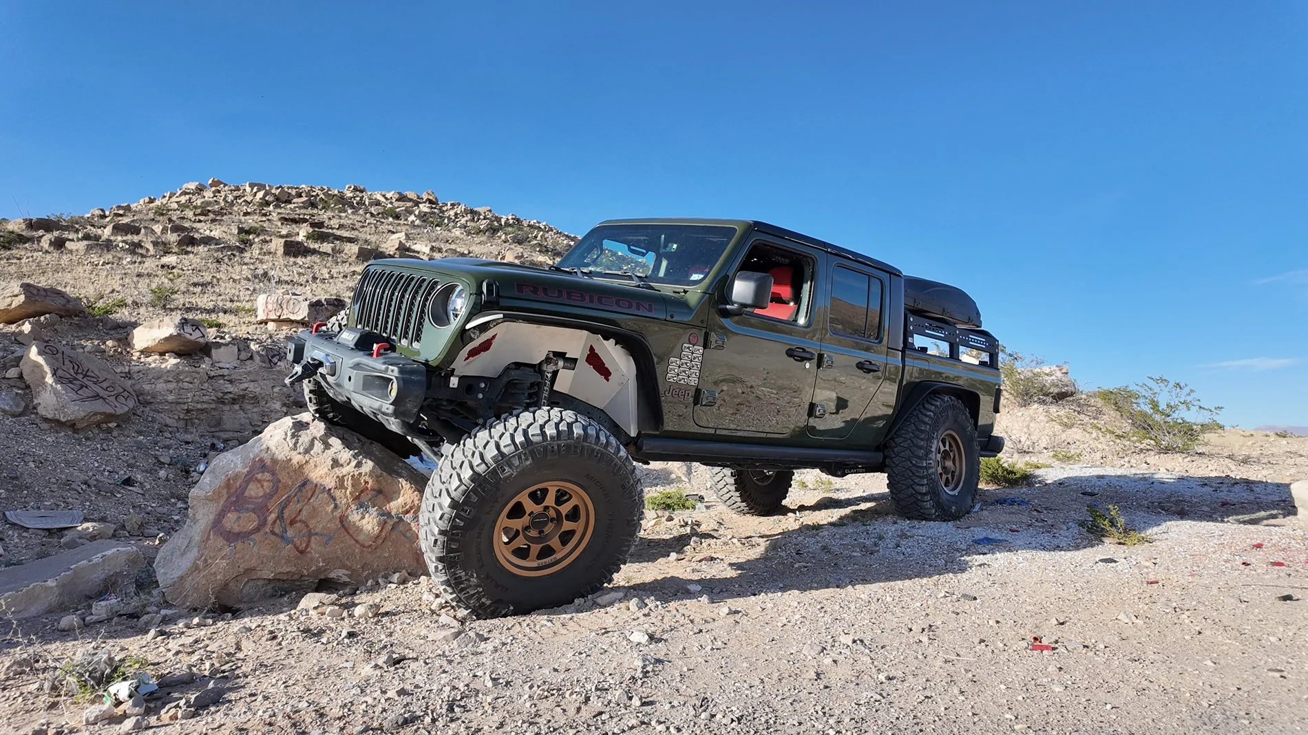

I have not managed to hit up an RTI ramp yet, but the clearance with the inner fenders and kbd plastic fenders might allow me to take half an inch or more off my front and rear bump stops.
