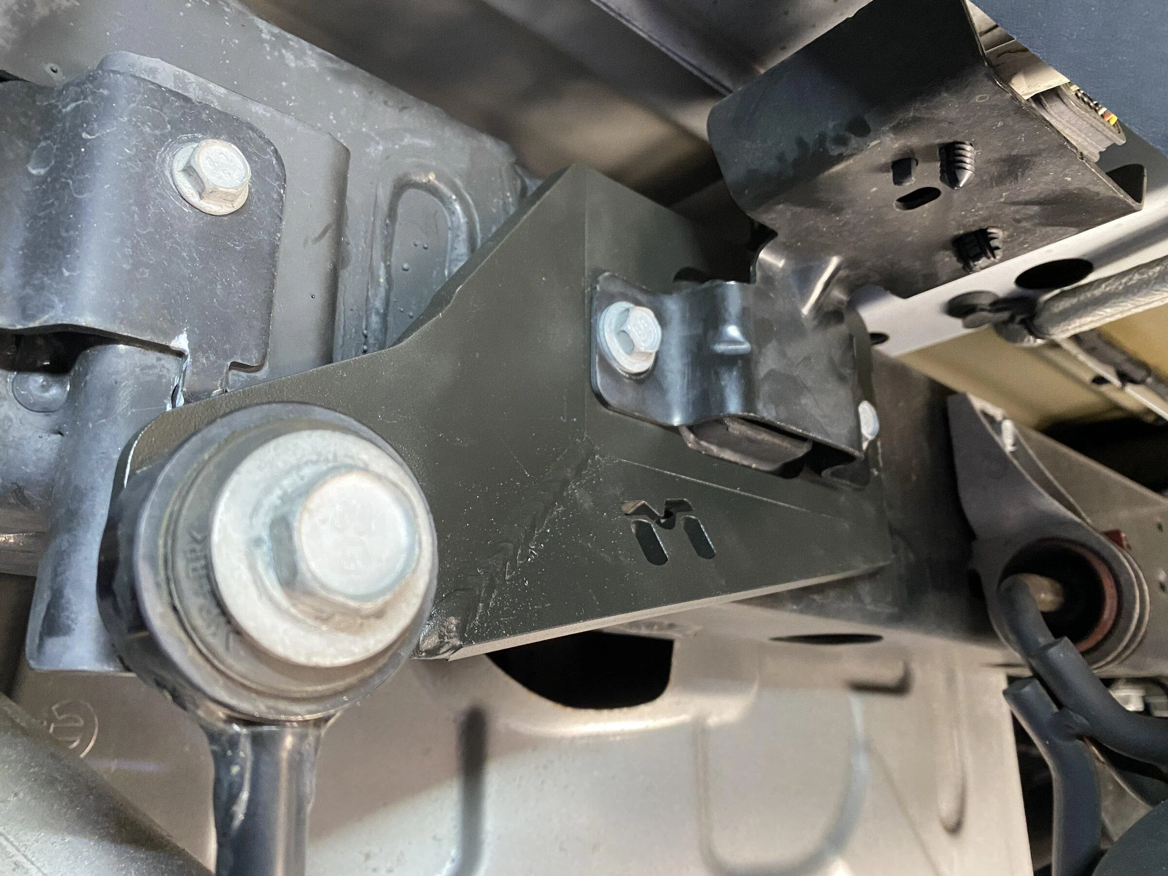

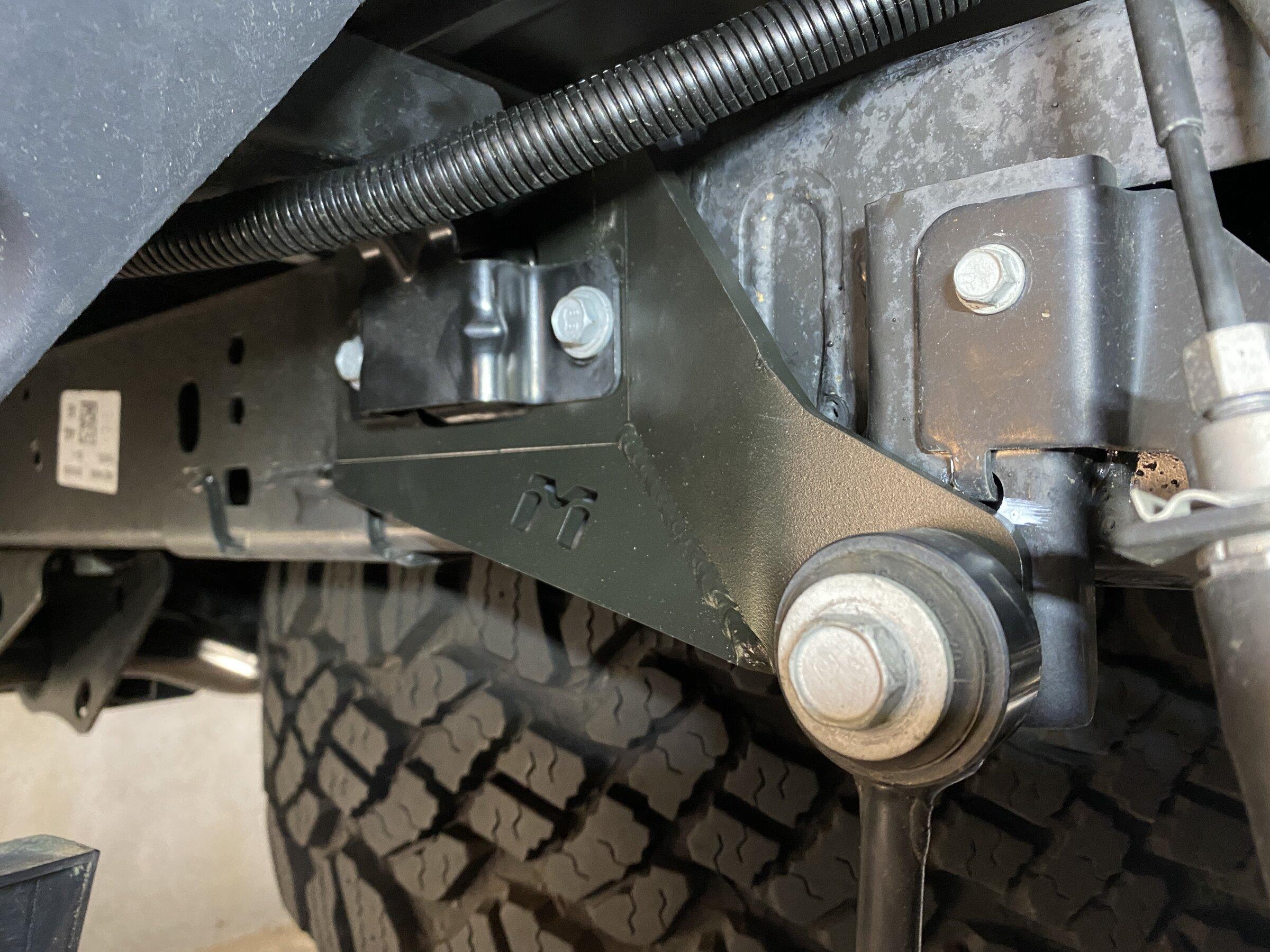

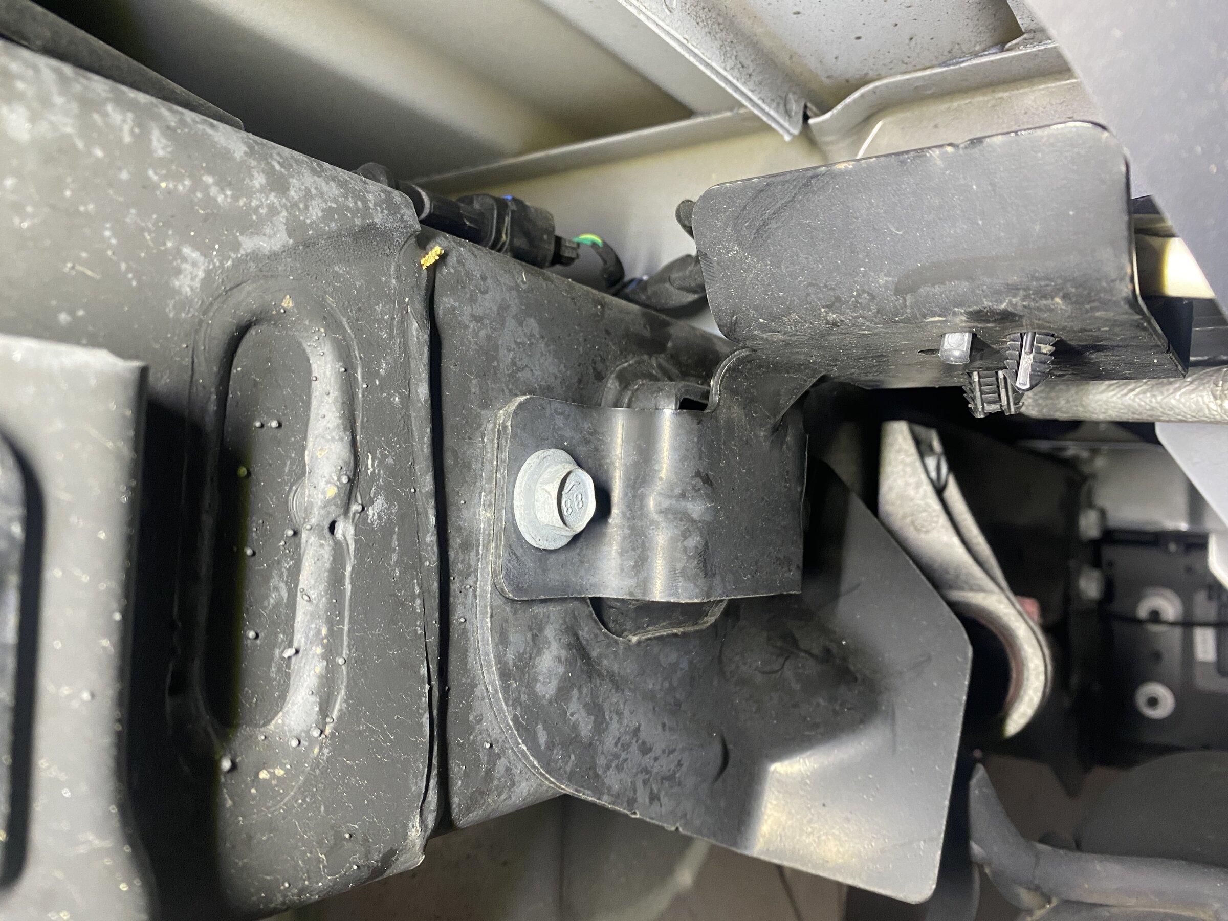

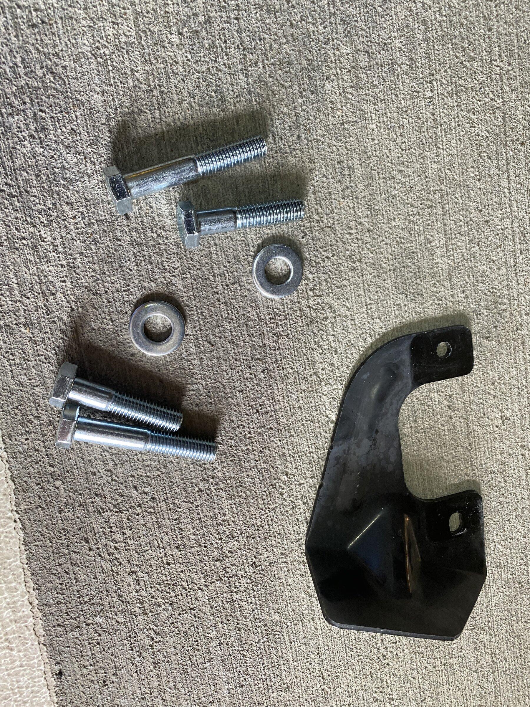

MetalCloak Rear Sway Bar Reinforcement Bracket

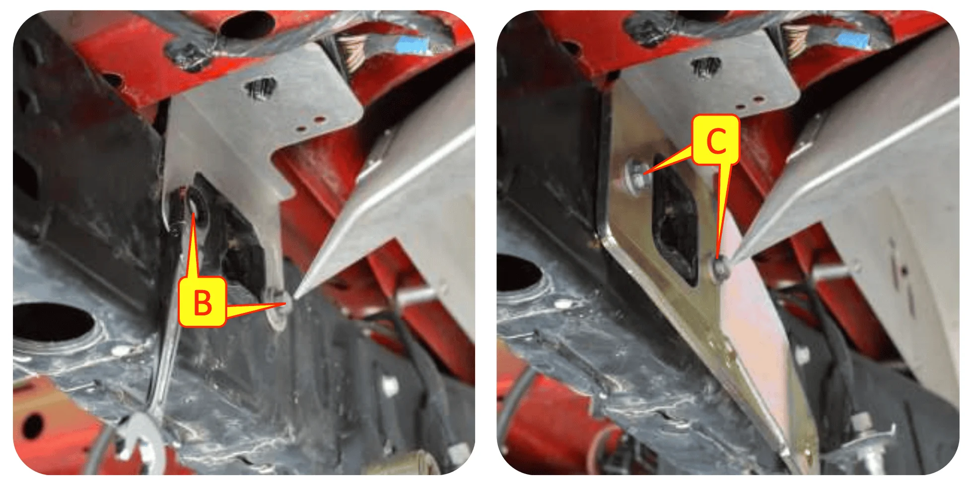

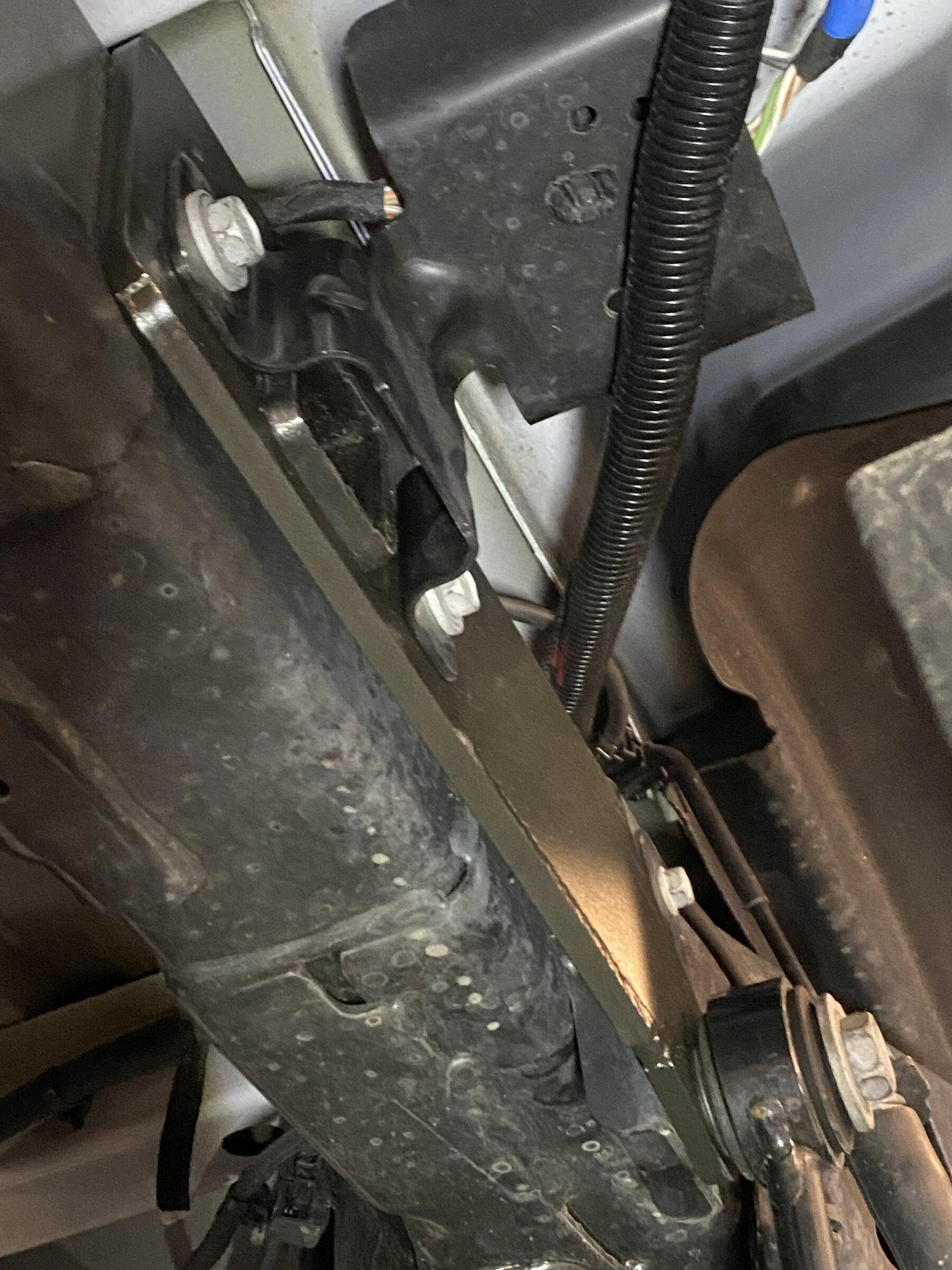

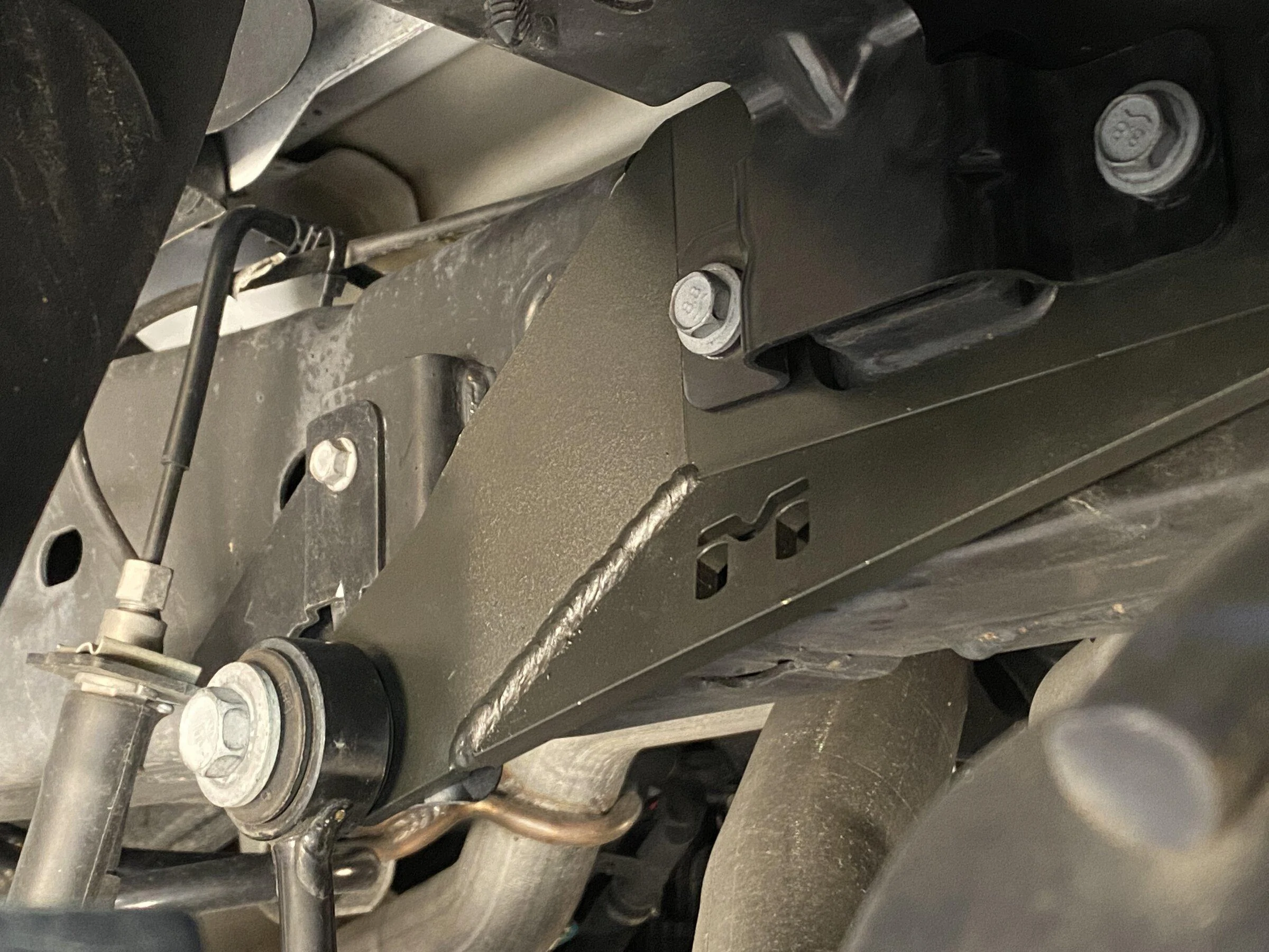

Installed successfully but had to deviate slightly from MetalCloak's instructions.
For 2021 JTs, there is a bracket on both sides and a what looks to be heat shield on the driver side. The heat shield you have to toss, there is no room for it. You have to sandwich the reinforcement bracket between the frame rail and the OEM bracket. Also the bolt and washers that come with the bracket are not needed for 2021 JTs.
Hope this makes sense.

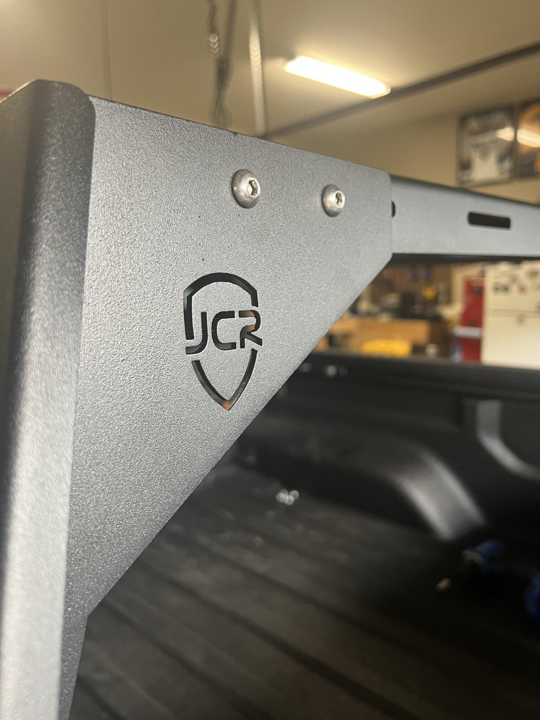

Got my JCR half rack and Access Literider cover installed.
Jeep Gladiator What did you do TO your Gladiator today? [ADMIN WARNING: NO POLITICS, NO GUN TALK] 43BA81F0-E7FF-467D-B930-8036036C665D
Jeep Gladiator What did you do TO your Gladiator today? [ADMIN WARNING: NO POLITICS, NO GUN TALK] B1D4E68B-85F6-463E-A2BD-8A48A4DF441C
Great work and thank you for the post. Just got notice mine shipped yesterday.

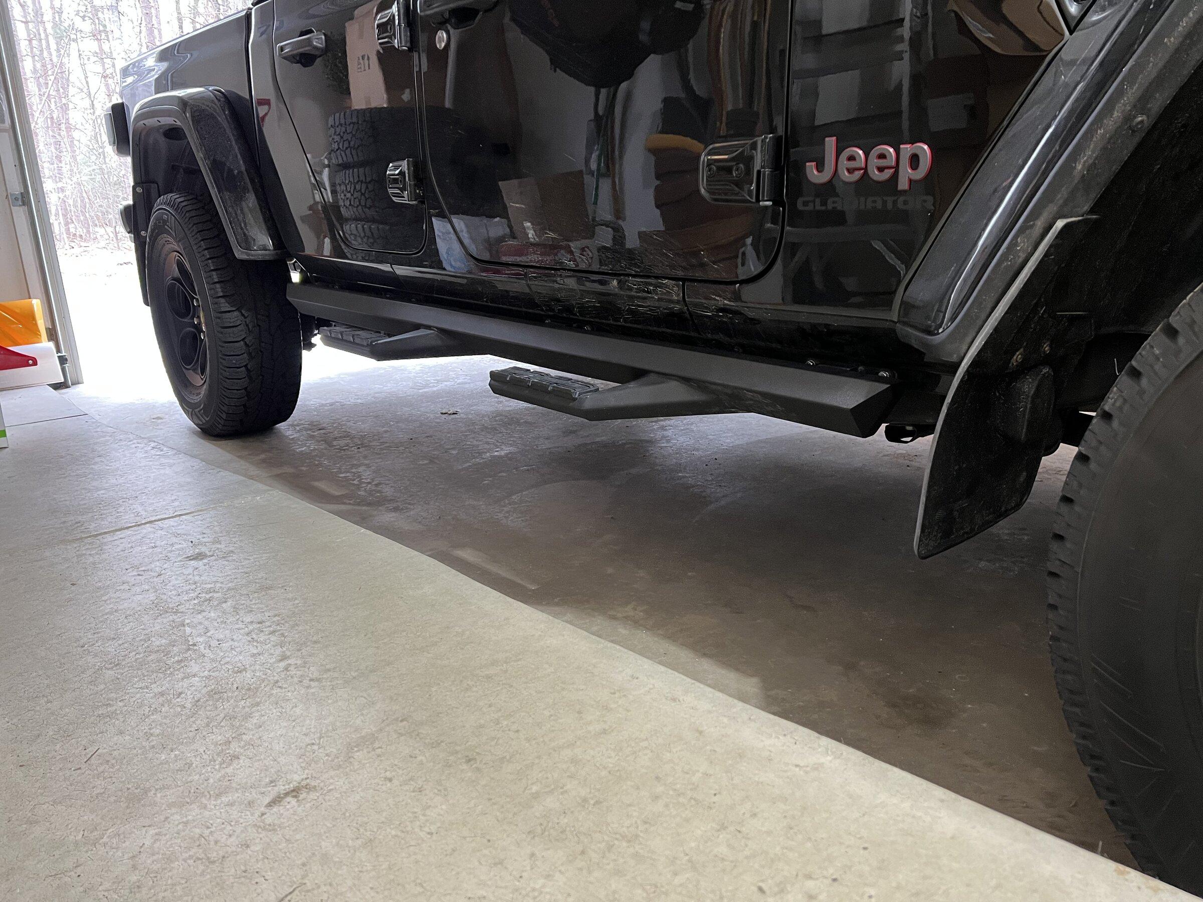

I wasn’t planning any side steps until I added the AEV spacer lift. These are Iron Cross sidearm. Thanks to fellow forum member a good investment. I’ll see how they go but the step is pretty solid.
Funny my wife made note of how the front light bar seems to match the AEV center caps.

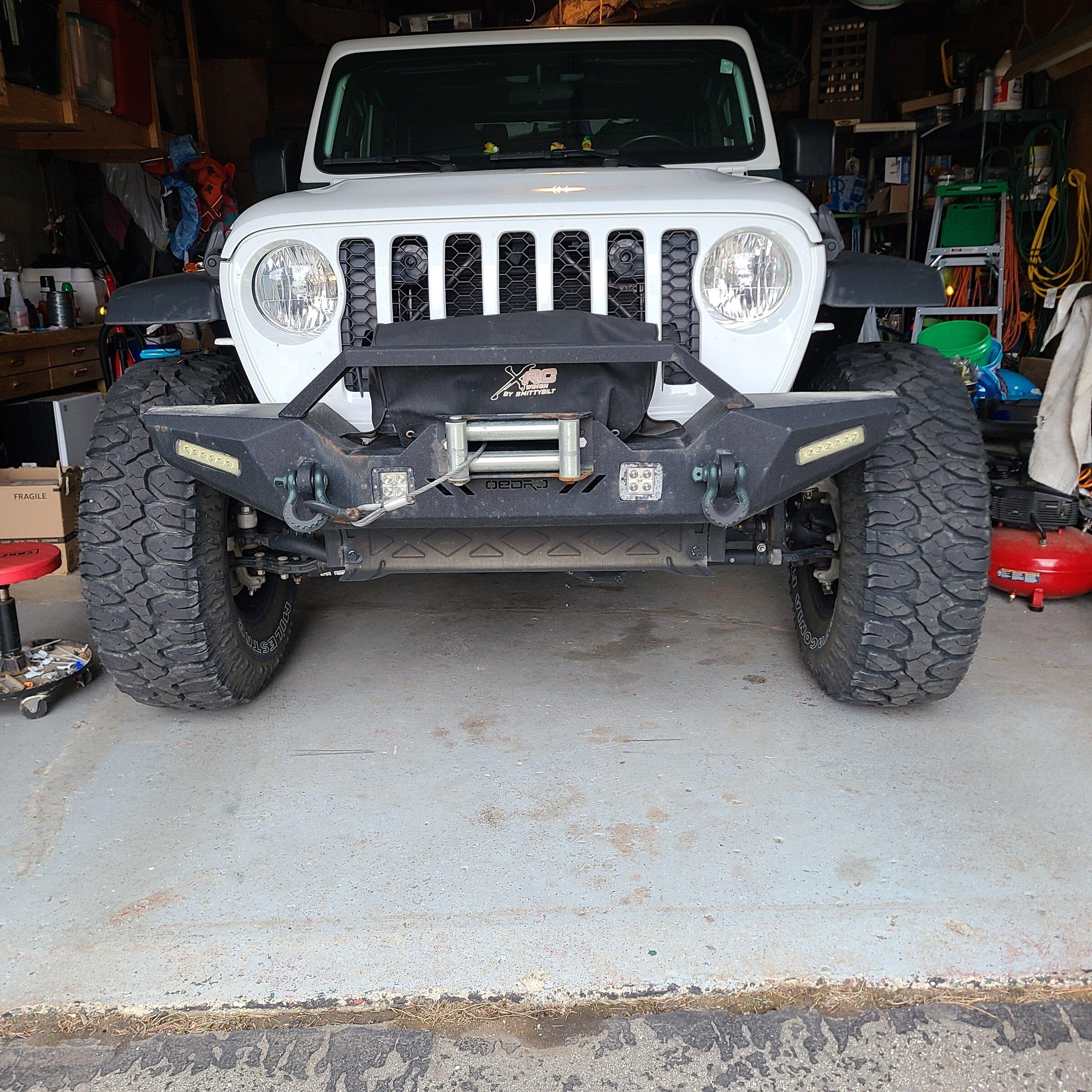

I have a question that hopefully you, or someone who sees this, can answer. Because you have these 2 vehicles and bumpers. Any idea if the 10th anniversary steel rubicon bumper
(made for the JK i think) will fit a 22 rubicon gladiator? I found what I think is a good buy, but not making the drive until I know for sure. The seller says it will fit, but ?‍♂
