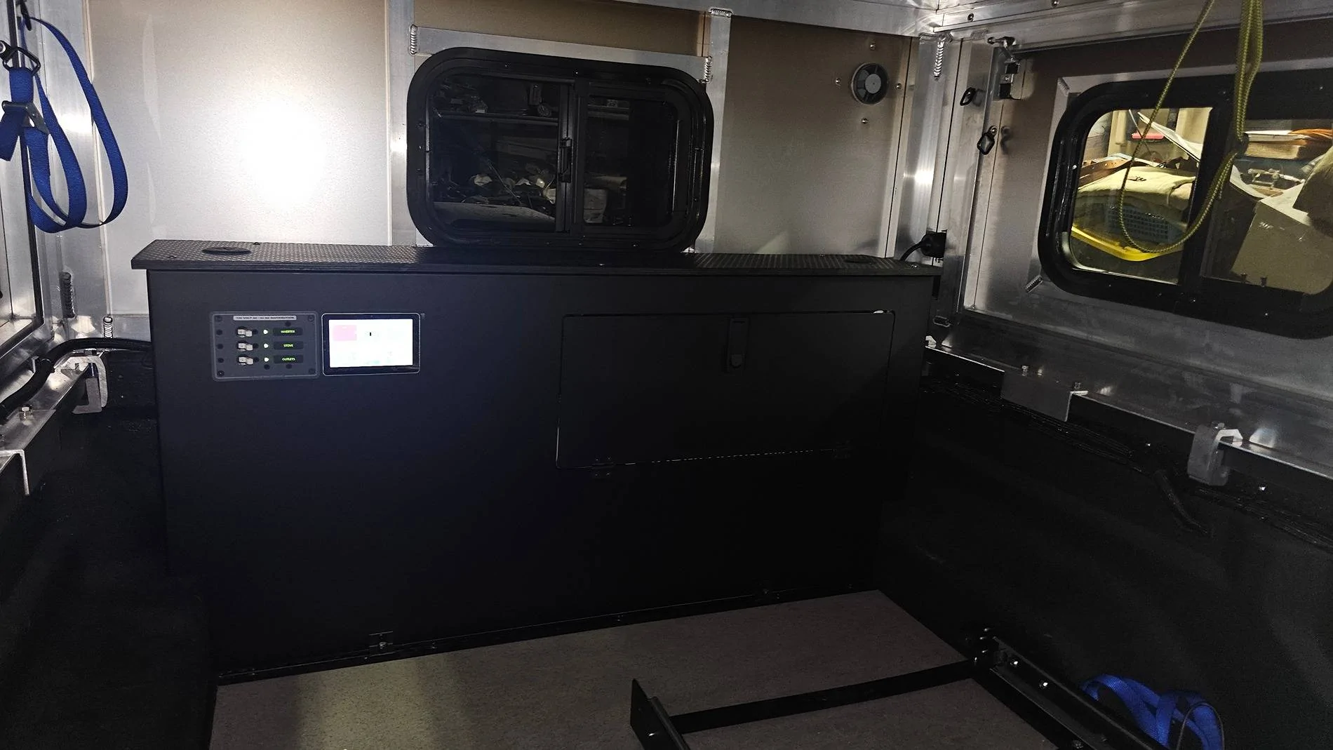

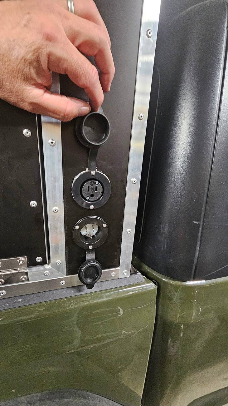

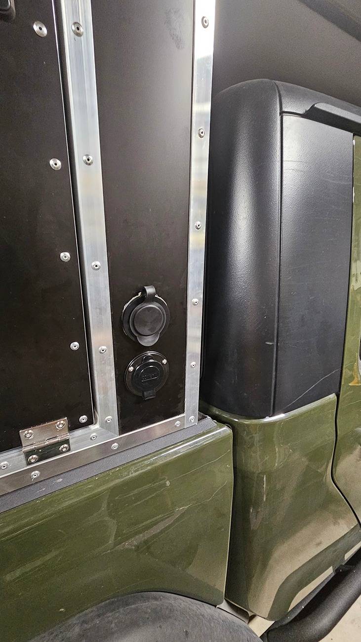

Picked it up from Zero Declination today. I added a couple of desires, which KP handled beautifully.
System is fully operational now, with all of my mods, and I couldn't be happier!
Their workmanship is top shelf!
Letting the water sealant cure, then I will remove the excess.

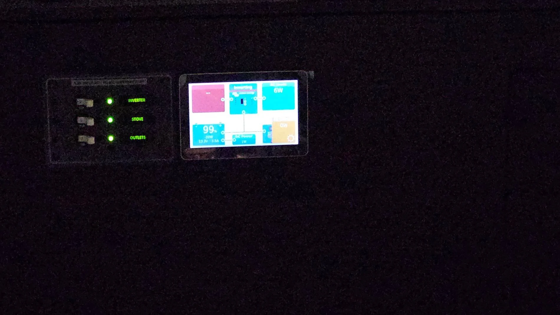

Now that I am back from my Summer Sojourn and everything that I broke during the trip has been repaired (mostly), it's time to get started on some mods that I was delaying until we returned.
I've been planning to expand my House Battery capacity from 100aH to 200aH. I couldn't find a dual battery box with the correct footprint for the space available so I wound up using two singles:
A little bit of wiring for parallel batteries and an RJ45 cable so they can talk to the controller:
I still need to do some cable management so it won't look like a bird's nest, but this pic was right after I tested it out.
I had to modify the two separate box lids in order to make 1 box lid and it all worked out pretty decent:

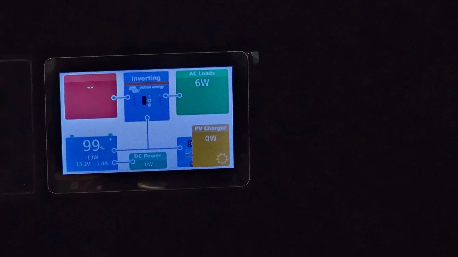

And here's the Battery 1 status:
And the Battery 2 status:
I'm chuffed!!!

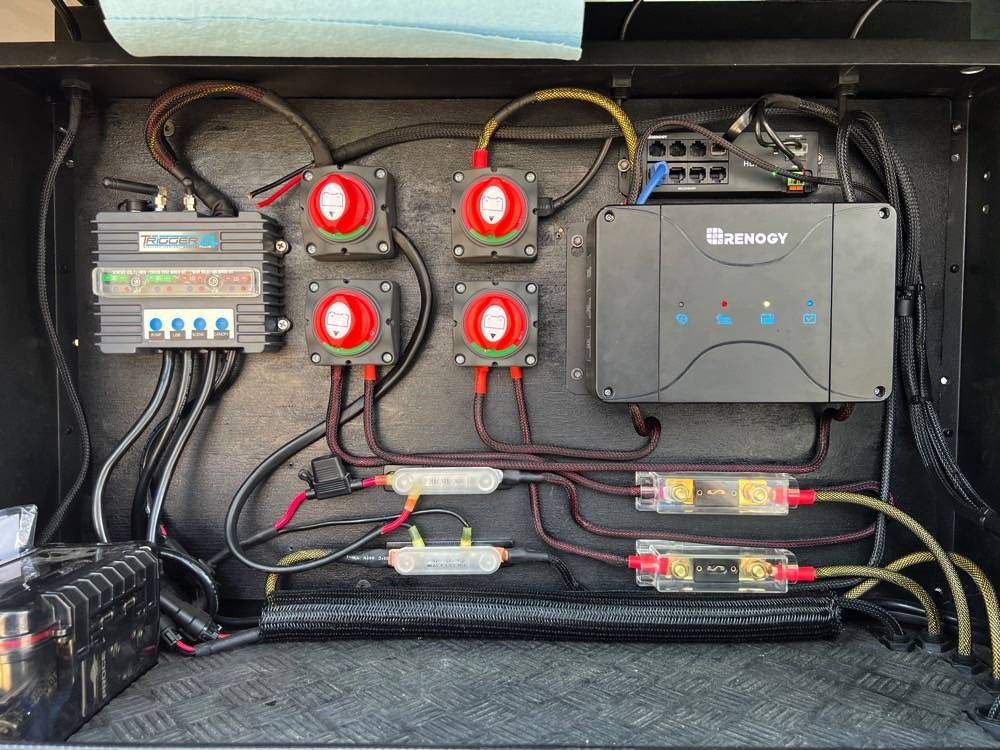

With the dual House Battery install finished yesterday, today it was time to do some updates in the electrical control cupboard:
Jeep Gladiator What did you do TO your Gladiator today? [ADMIN WARNING: NO POLITICS, NO GUN TALK] 15_HouseElectricalPanel_1
I decided to add some cutout switches to isolate power sources and loads without have to pull a fuse or unplug a connector. So now I can isolate:
-Top left: All house loads
-Top right: Solar Panels
-Bottom Left: MPPT Output
-Bottom Right: Alternator
The eagle-eyed of you will see one errant pair of wires that aren't landed and I still need to decide how I want to manage that one; it's power to my RTT and I'd like to have it on a different switch than all of the other house loads some that I don't have to leave all of the house loads energized at night while we are sleeping. I'll figure it out but it just got too d@rn hot to do any more outside today.

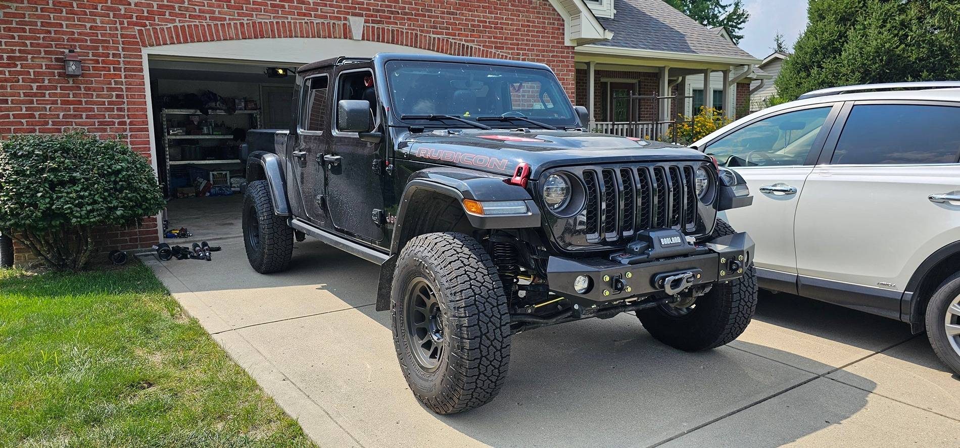

Finished up the MetalCloak Leveling Kit today. Of course that was necessary since last week I installed their Frame Built front bumper and placed a 12k Badland winch in it. The leveling kit included 2.5" dual rate springs, adjustable upper control arms, adjustable front track bar, and I added their red RockSport long travel shocks to the package. Took it on a short shakedown cruise (just to make sure I hadn't forgotten to tighten anything) and am really impressed so far.

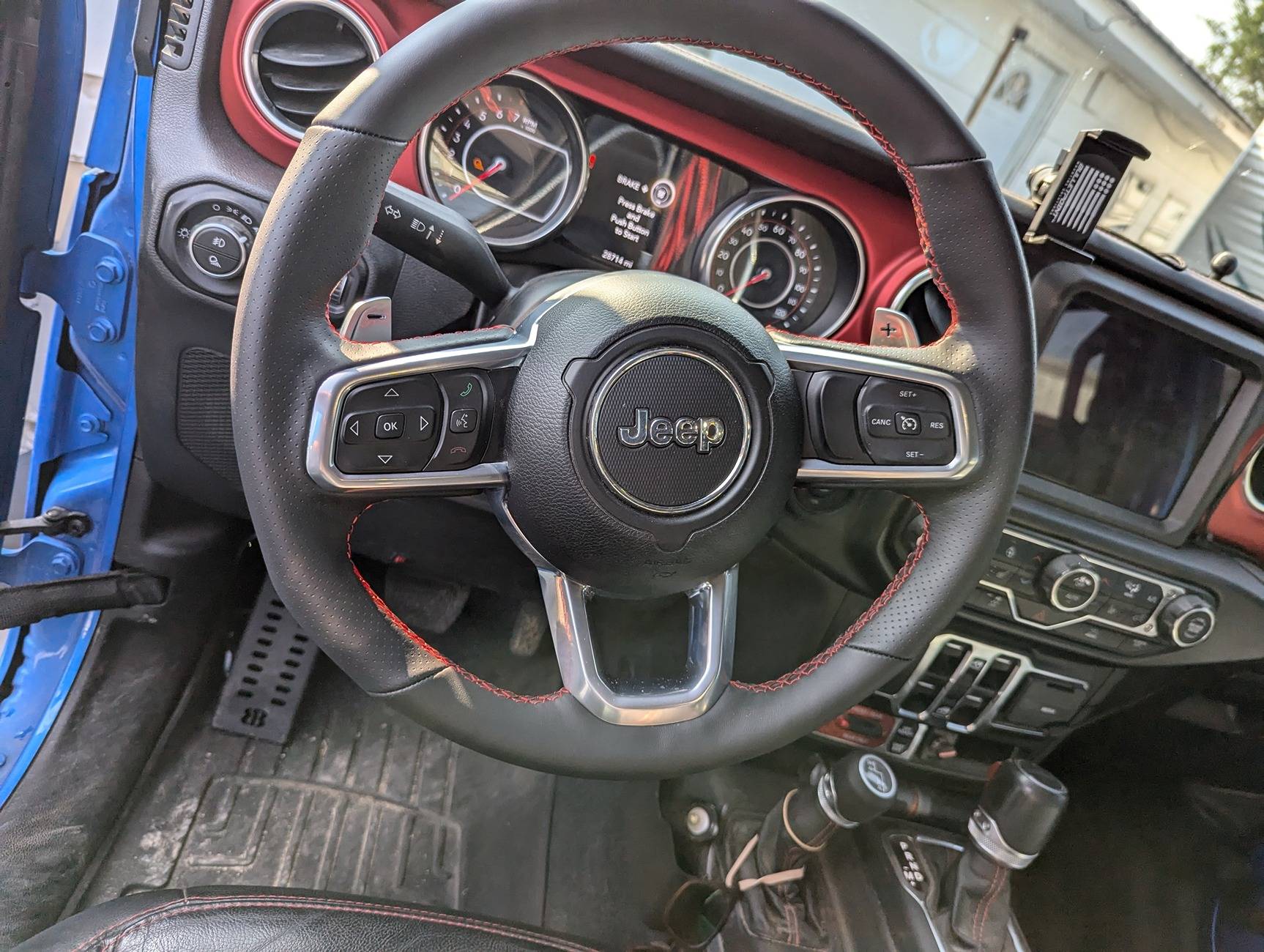

This evening I upgraded my steering wheel to the red stitched 392 wheel and added allmopar's paddle shifter kit. The shifters work perfectly and the new wheel feels great.
Super cool. Mind sharing the links to the parts?
