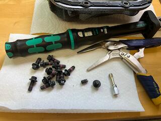

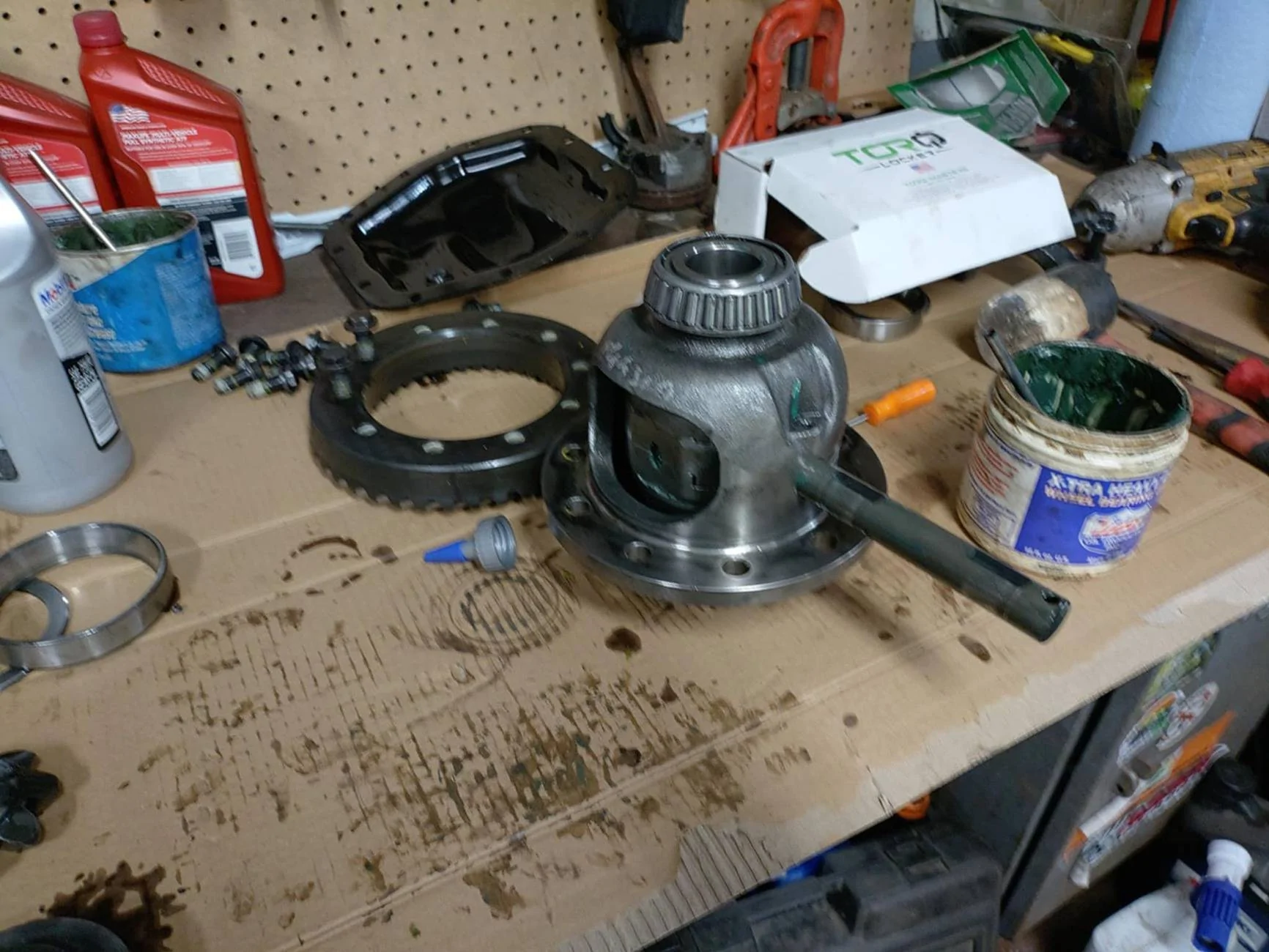

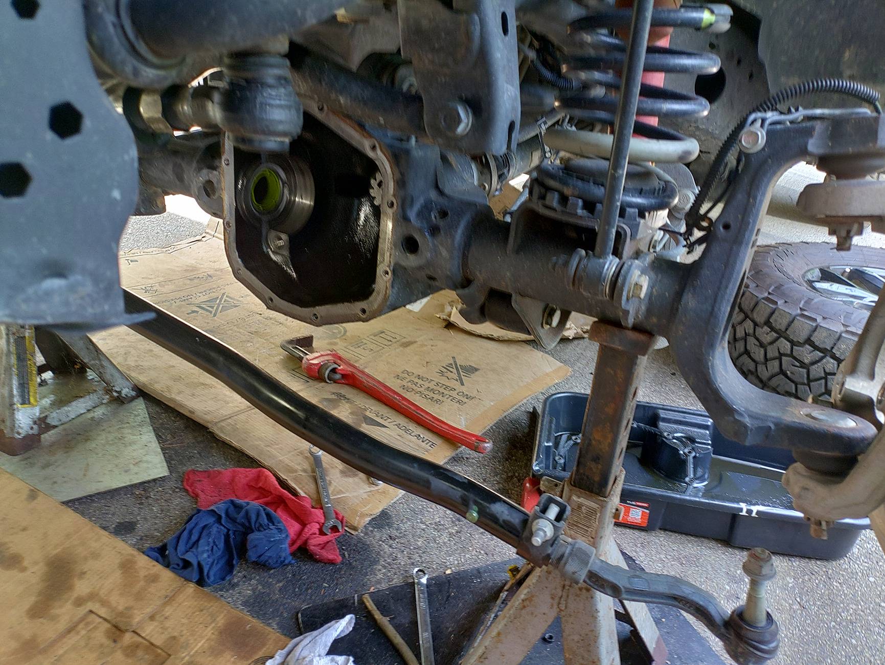

Went to finish up the locker sensor replacement and install the new Spicer nodular iron differential covers. I decided to use the bolts that came with the covers. Was following the procedure I've done before using new bolts, first pass to 16 Nm / 12 ft. lbs., and then the second pass to 35 Nm / 26 ft. lbs. Bolt number 11 snapped off on the second pass.

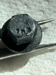

Removed all of the other bolts and the cover, and was able to get vise grips on the snapped off bolt and remove it before the pre-applied thread locker set up. This is the one that snapped.
I suspect it isn't of the highest quality. Since I've come to expect things to go wrong, I had the Mopar replacement bolts available and used those to install both front and rear covers.
