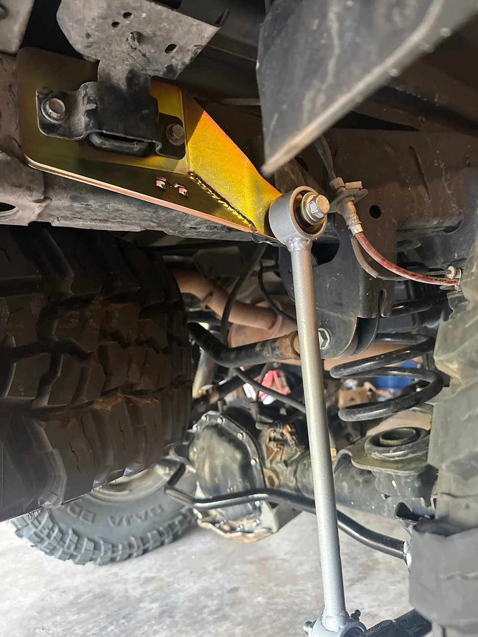

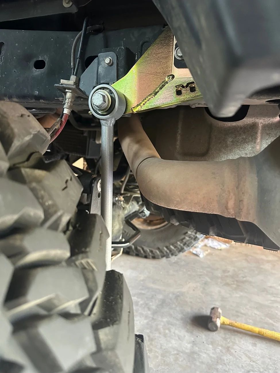

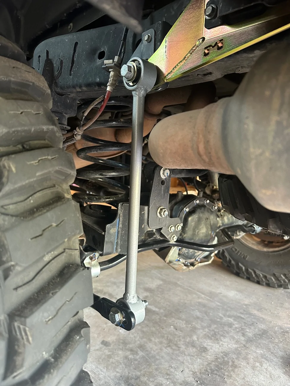

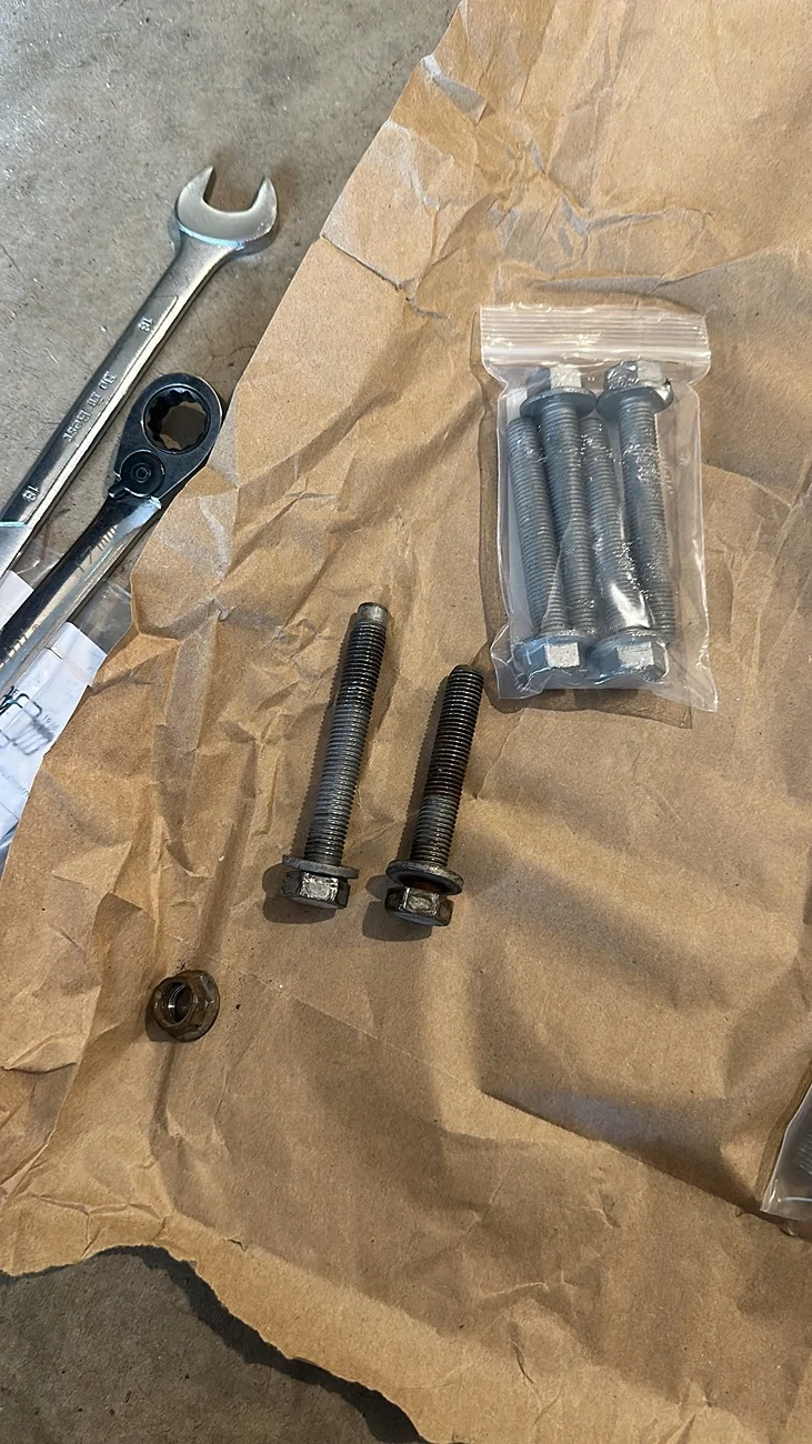

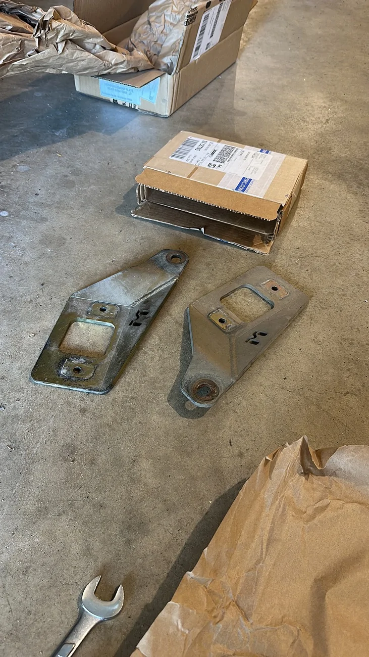

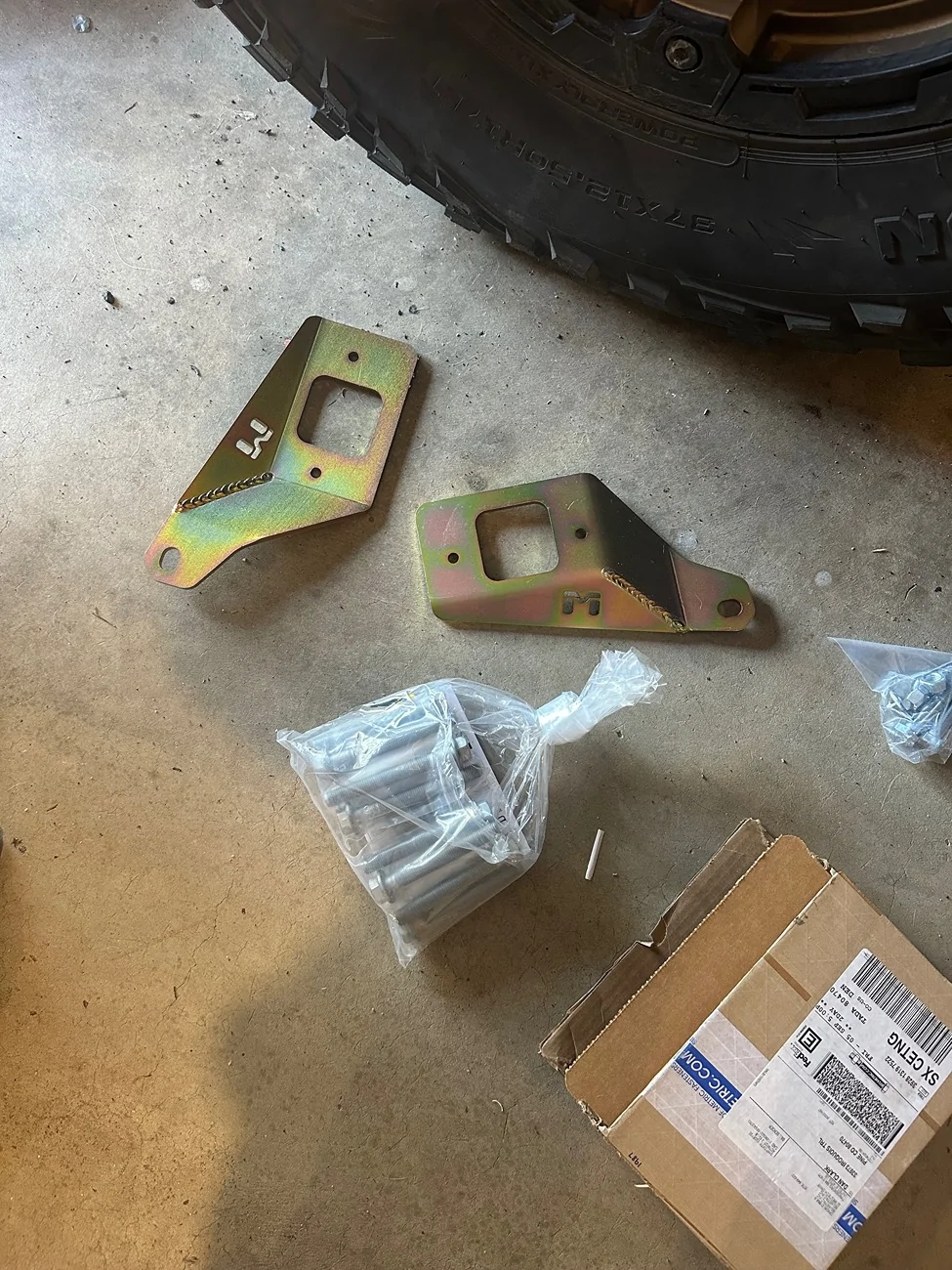

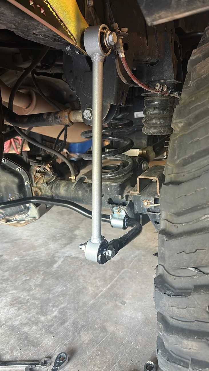

Replaced my @Metalcloak rear swaybar reinforcement brackets. To be EXTREMELY CLEAR, the brackets did exactly what they were designed to do. I installed them in 2022 before the rubicon, and have pushed my swaybar up with rocks too many times to count. The passenger side now, just after Pritchett this year (2nd time) had a slight bend that was affecting link alignment it just wasn’t parallel with the frame anymore. Swapped them and tapped the frame bracket back to straight with a dead blow before reinstall. These brackets have ensured that I still have those brackets intact after so much abuse. By fixing the angle, and replacing the fasteners with new zinc flake m12x1.5x90mm, everything is straight and strong again. This should hold up to near anything I throw at them. I’d replaced bent links and hardware several times on the trail or in parts store parking lots several times. No idea when the bolts ended up different lengths. :)

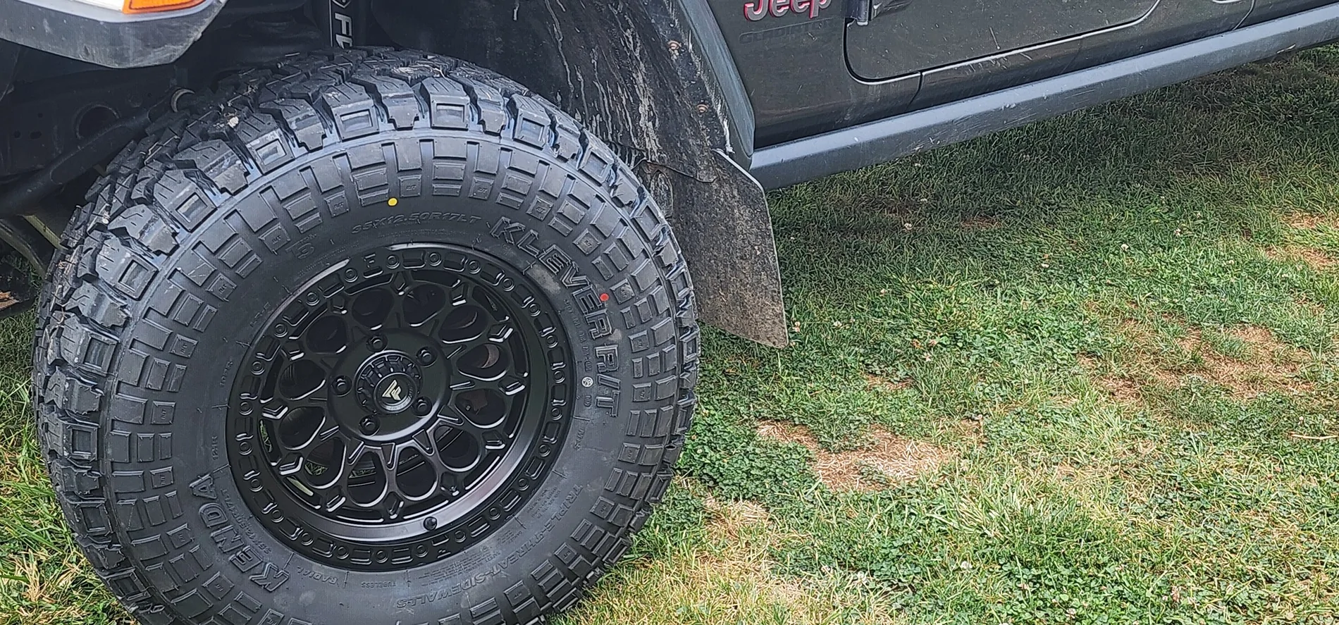

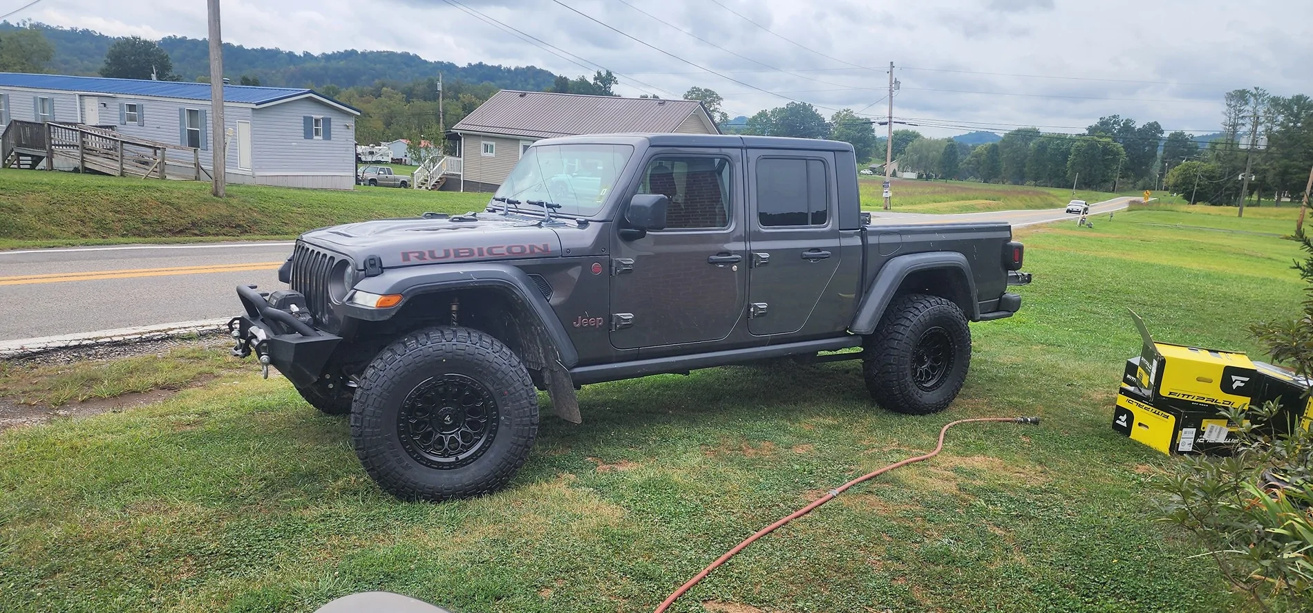

Well, it was overdue as I bent another rim ( very slightly) and the Mickey MT's just would not balance out right and the closer they reached the wore out stage they were abusivly loud and have always had a slight egg shape. Off road the MT's where Masters. On the road they left alot to be desired. Even not pushing water out on heavily soaked roads. I am keeping the 2 best ones for spare tires. And will carry one with me .
So today I got my Fittapaldi off road K101's mounted and some new shoes to go with it . Kenda Klever RT's.. to actually be so quiet I could hear the engine reving up was pretty awesome. All vibration went bye bye as well.

Glad you got that worked out. Mine do balance, but I agree that they aren’t as good on the road as the ATs were. But I guess I expected that. I’ll be watching to see if they get worse as they wear. 2,400 miles of towing in less than 2 weeks will be an indicator.

They did really good for about 20K .
