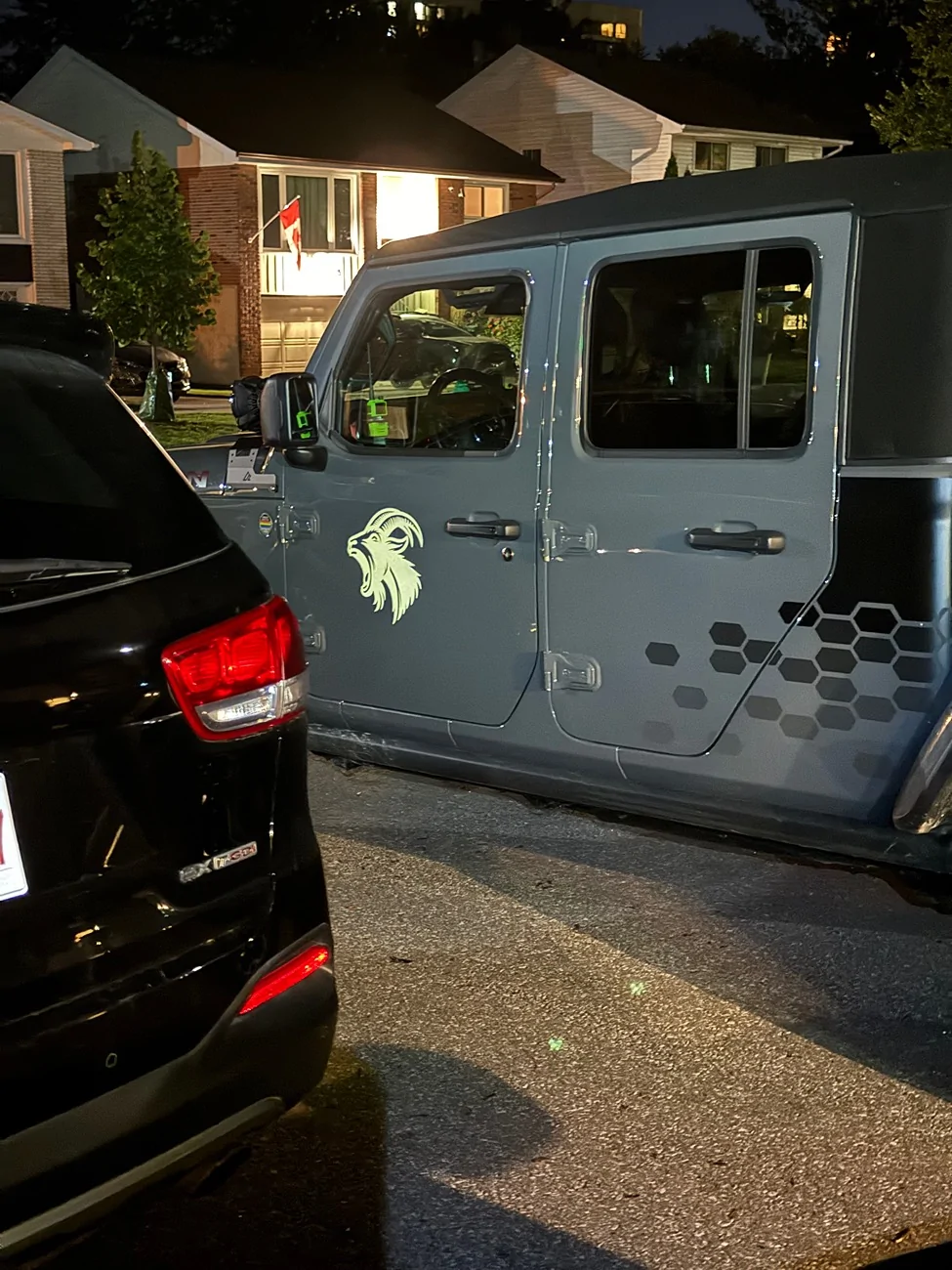

Started to install Gravity Titan Pros as pod lights and discovered the wiring how to is wrong/for the older Gravity Pro 6 and so I have some wire and fuse editing to do.
I did get my decal on the driver’s side. It’s reflective at night and ghosts during the day, unless you’re head on to it.

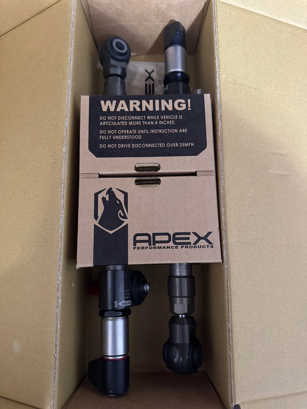

I got tired of waiting for my back to stop hurting and made an appointment with Shift Auto to put my triangulated 4 link suspension kit on .Done on the 16th and really can't wait to feel the difference. Shift has done many of them.

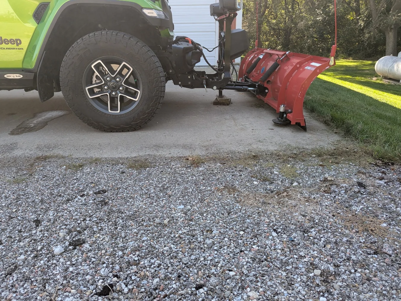

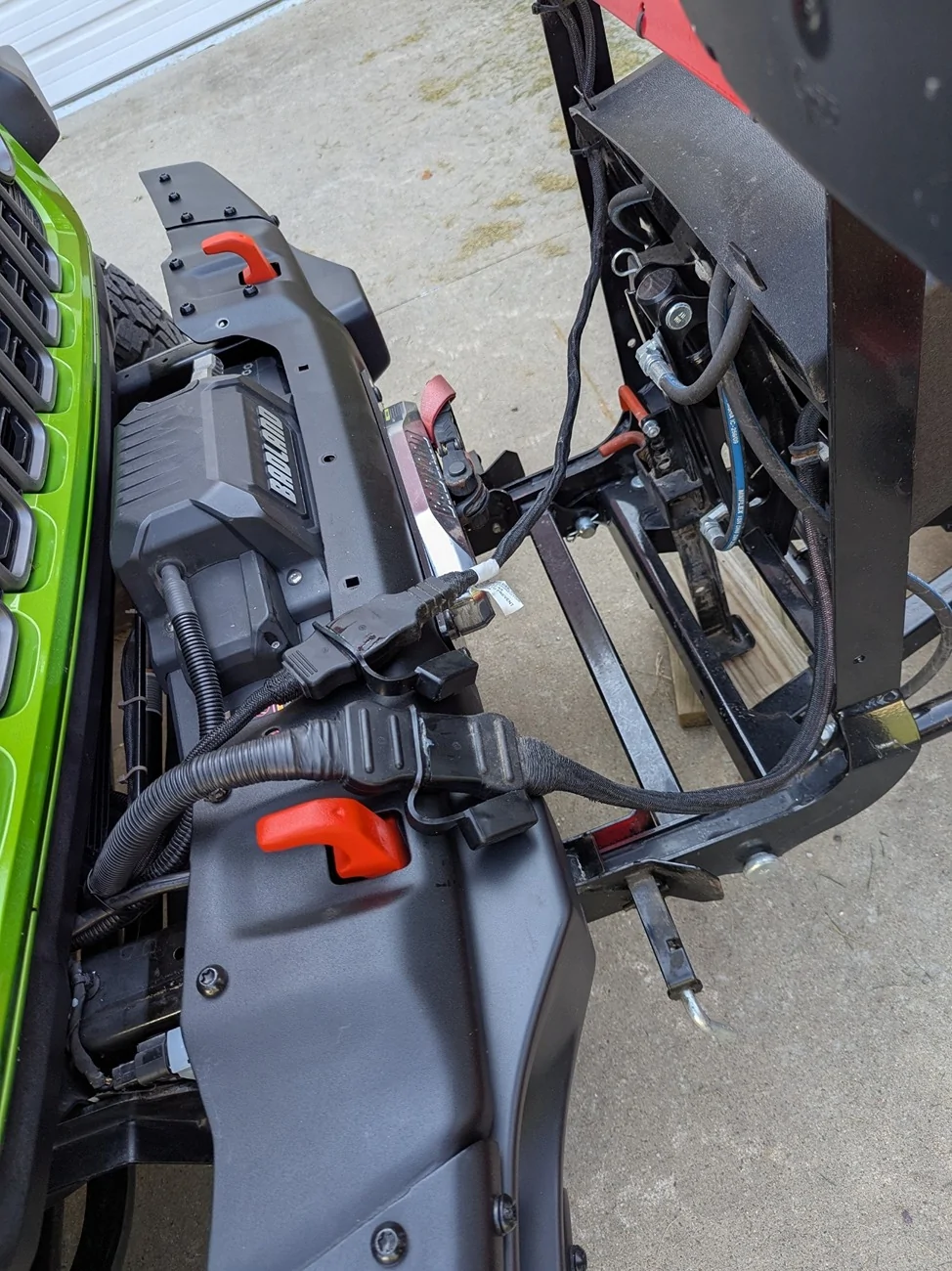

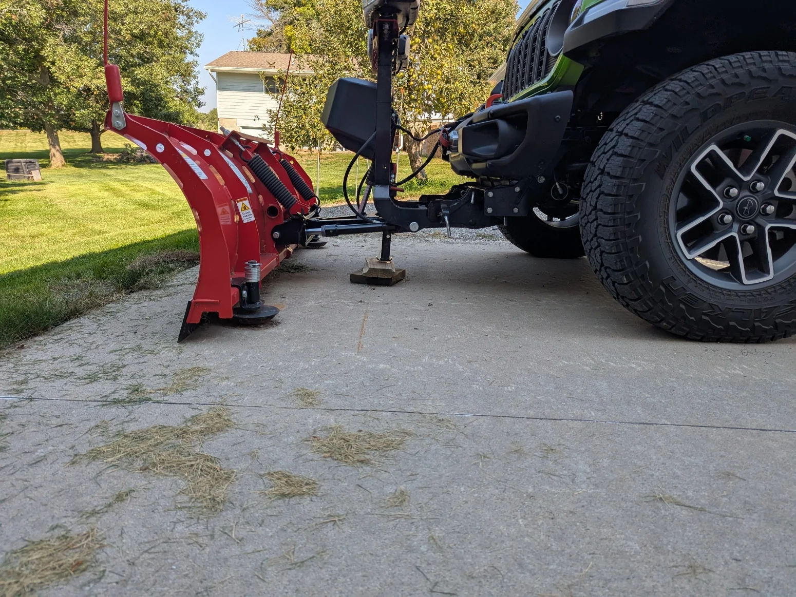

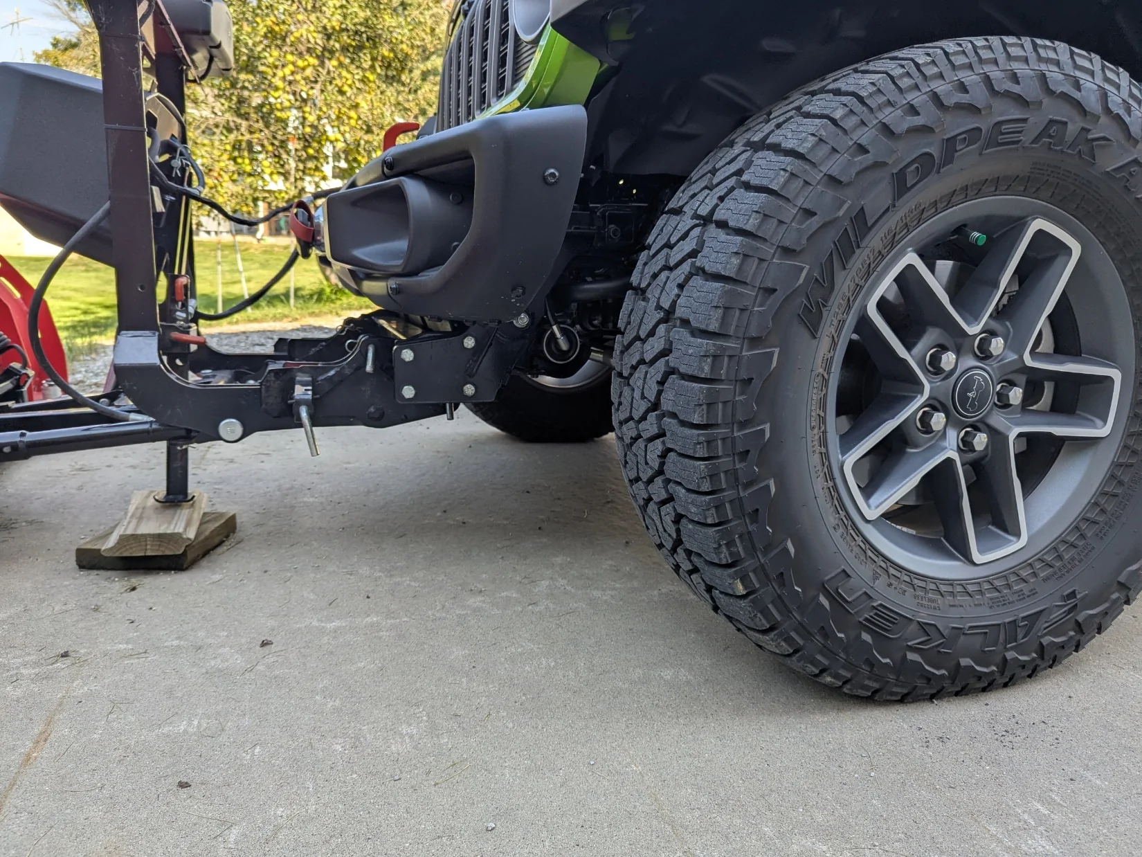

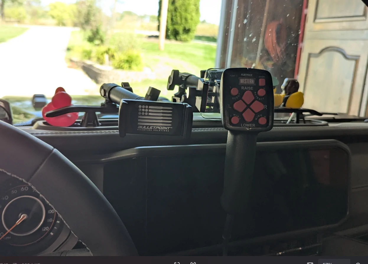

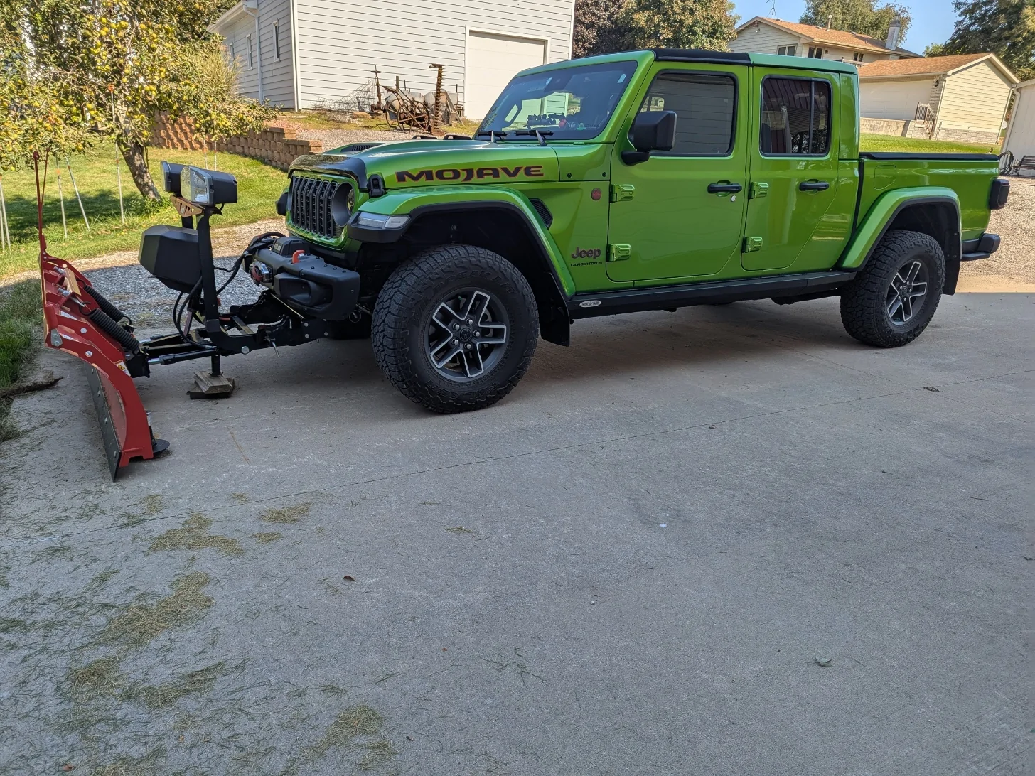

It works! You can put a Western Defender snow plow on a Mojave! (with a lot of work/effort)
The extra weight of the winch up front helped bring the frame down to the top acceptable distance for my brackets - so adding the weight of the winch was a win, keeping the plow frame close to level, almost parallel to the ground..........
The weight of the plow attached and blade resting on the ground dropped the front 3/4".
More with that blade raised, of course, but would seldom really have it on the road with the blade mounted and 3/4" drop when just sitting in the garage isn't too bad.
Also did some measuring and comparing with Rubicon - my Mojave sits pretty close to 1" taller than Rubicon. I measured from wheel center to a specific point on the fender to allow for tire size, inflation and all. With that method, a change in tire size would make no difference since I'm measuring center of the axle up to a comparable point on the body.

Do you think you’ll be able to plow faster with that Mojave?
40,514
54,050
LOL - I doubt it.
Without the LSD that the Overland had, it will be interesting.
When I did my plow shopping in 2022, the only JT that Western listed for working with their plow was the Overland. Not sure why, but assumed in the case of the Mojave it was the height and shock reservoirs. Rubicon, I figured it was the sway bar disconnect - but after putting it on the Overland, it wasn't even close to the sway bar at any point.
The instructions talk about trimming the air dam - not a mention at all about a skid plate.
So maybe it was figured it wouldn't work with a skid plate. It doesn't - unless you cut the ends off the skid plate. So maybe that was it - won't work because of the skid plate and shock reservoirs?
