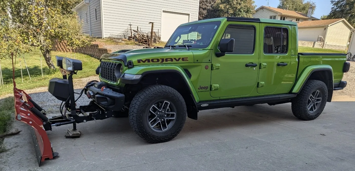

Have you ever used or heard of BOSS? My brother-in-law is one of their hardware/software engineers. I've seen some of the the projects he has developed over the years. Now, he drives a Prius and never plowwed a drive way. So I am curious if BOSS has a reputable product.
You mean the BOSS snow plows? Yeah. They also only show their plow only working with Sport or Overland as far as the Gladiator.
I bought my Western through a local dealer - I checked around, and availability and close location were an advantage (but they had never installed one on a Jeep so wanted to see mine when it was done back in 2022)
But BOSS is a big brand in plows.

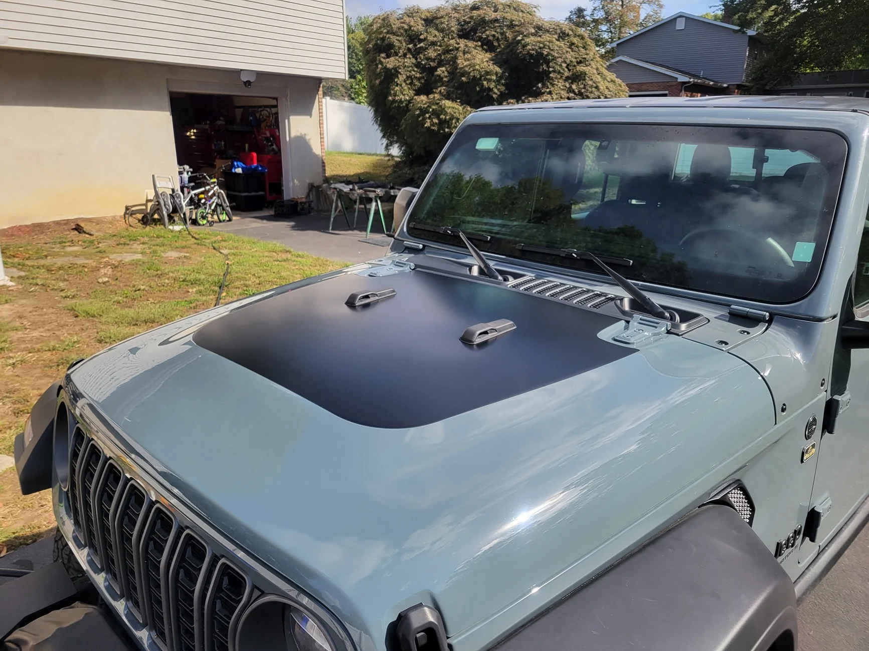

Installed the SEC10 hood decal I got from Extreme Terrain. Went pretty easy but did have to remove the hood tie down and washer nozzles as it was not cut for them.

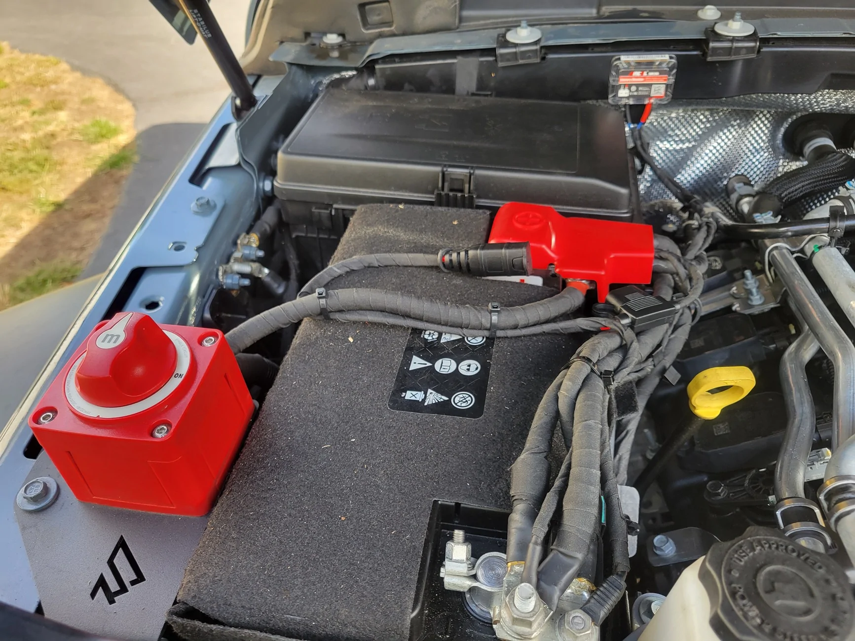

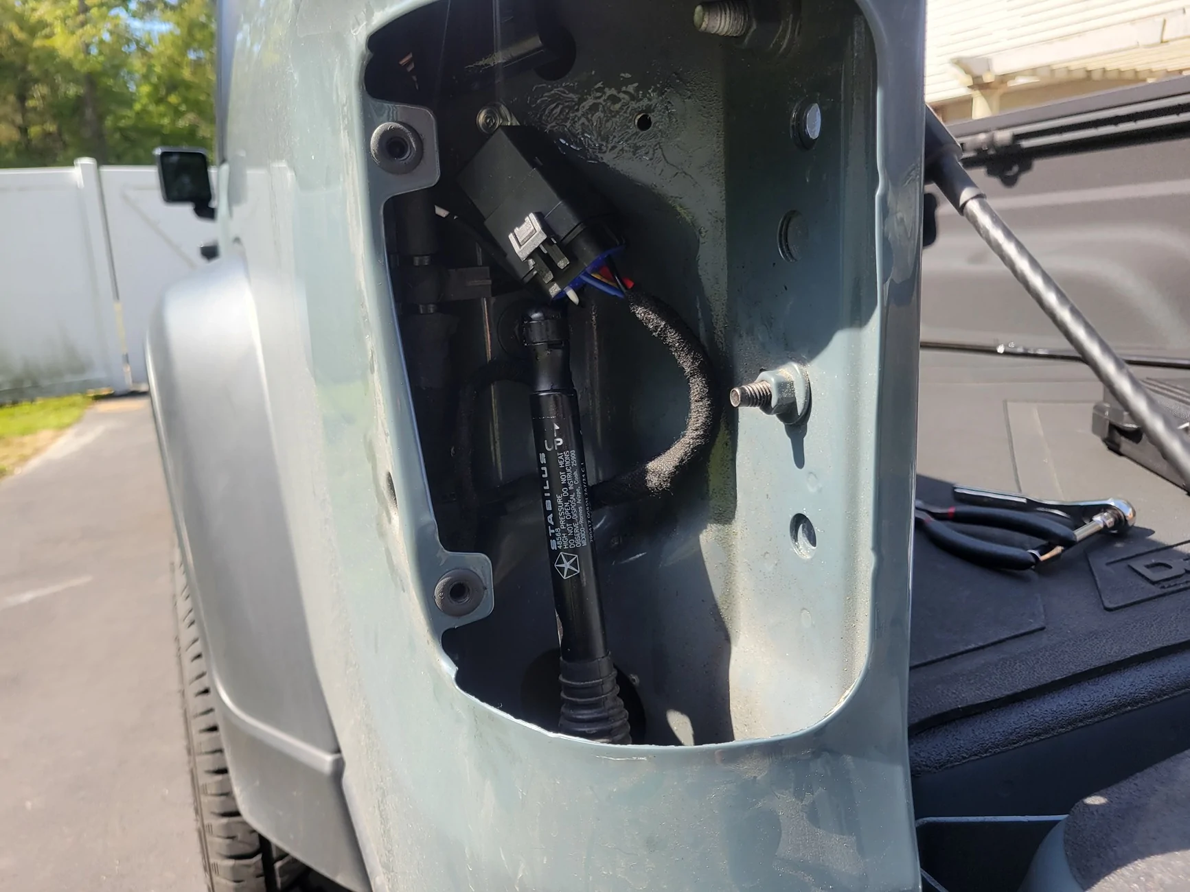

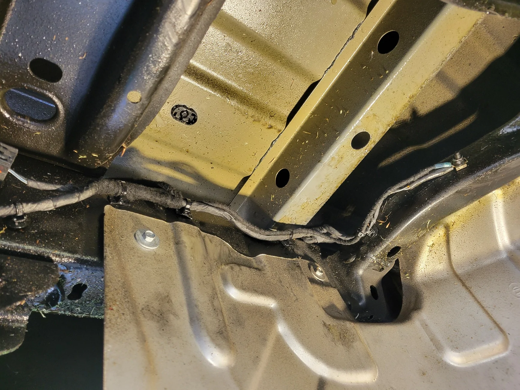

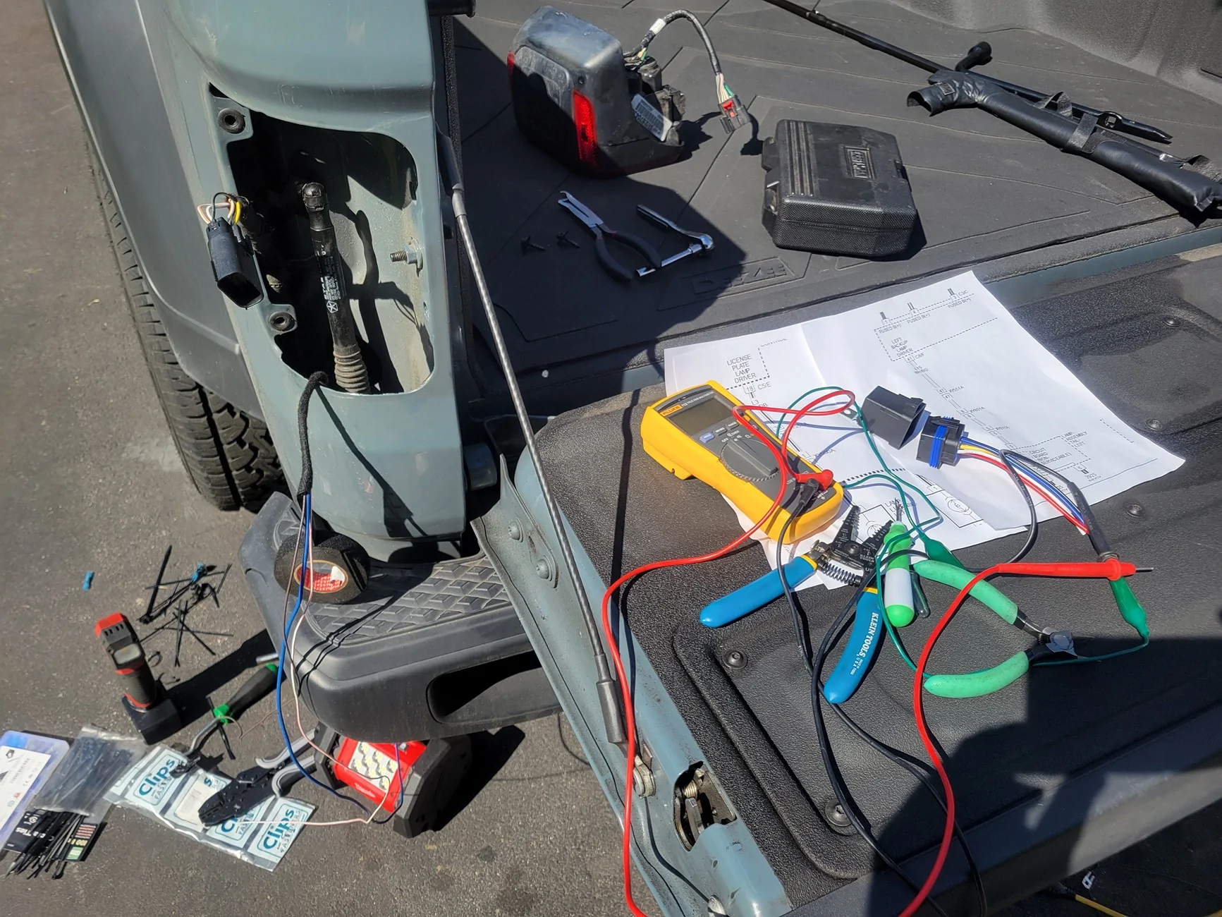

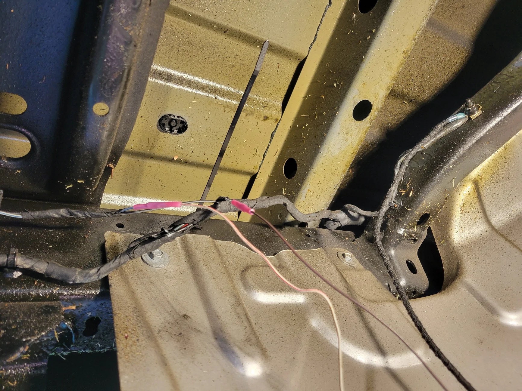

Today was electrical day.
Wired in a ANCEL BM200 battery monitor. Also put in a NOCO battery tender lead set.
Hardwired in a license plate light reverse blanking relay.

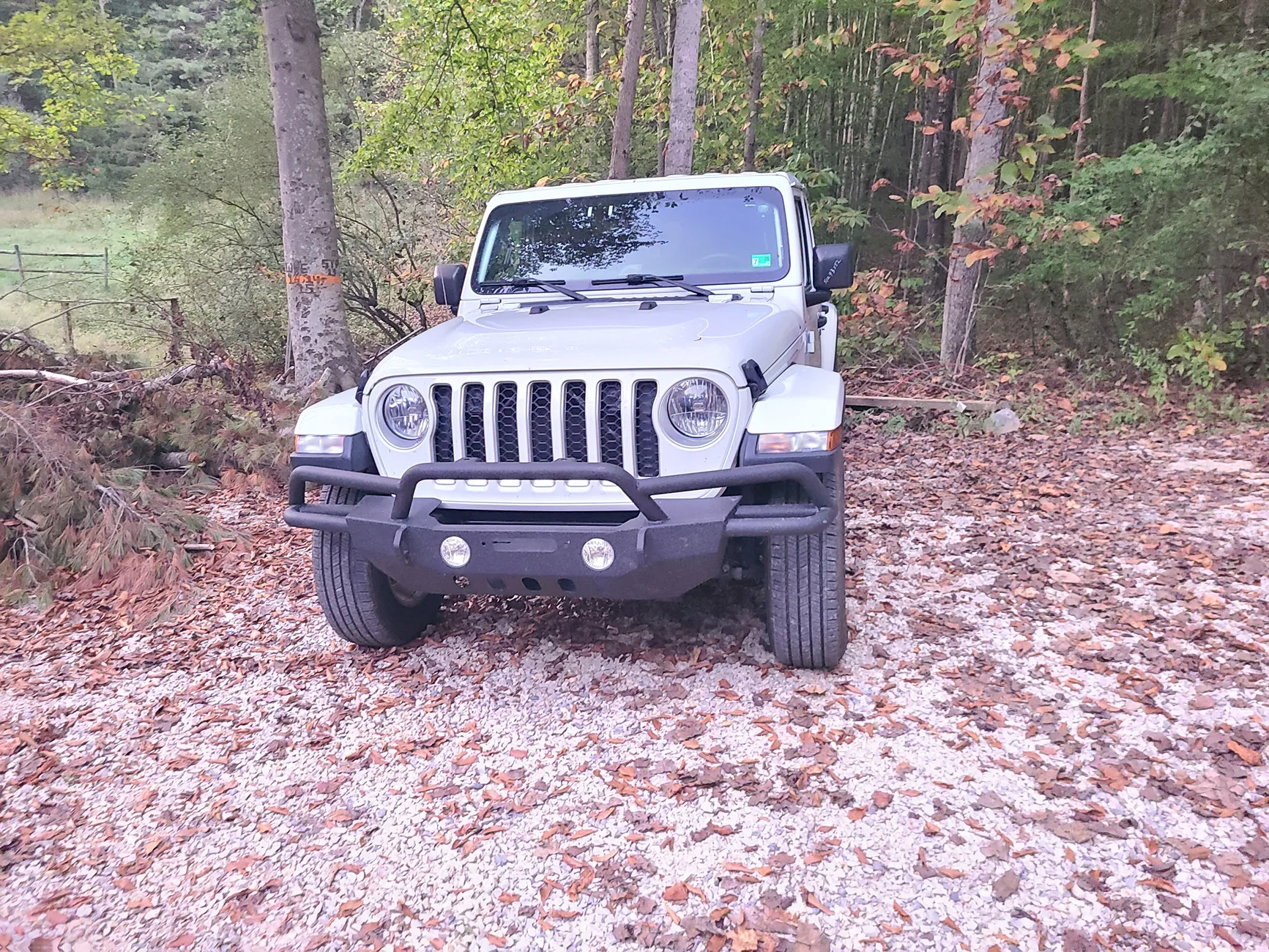

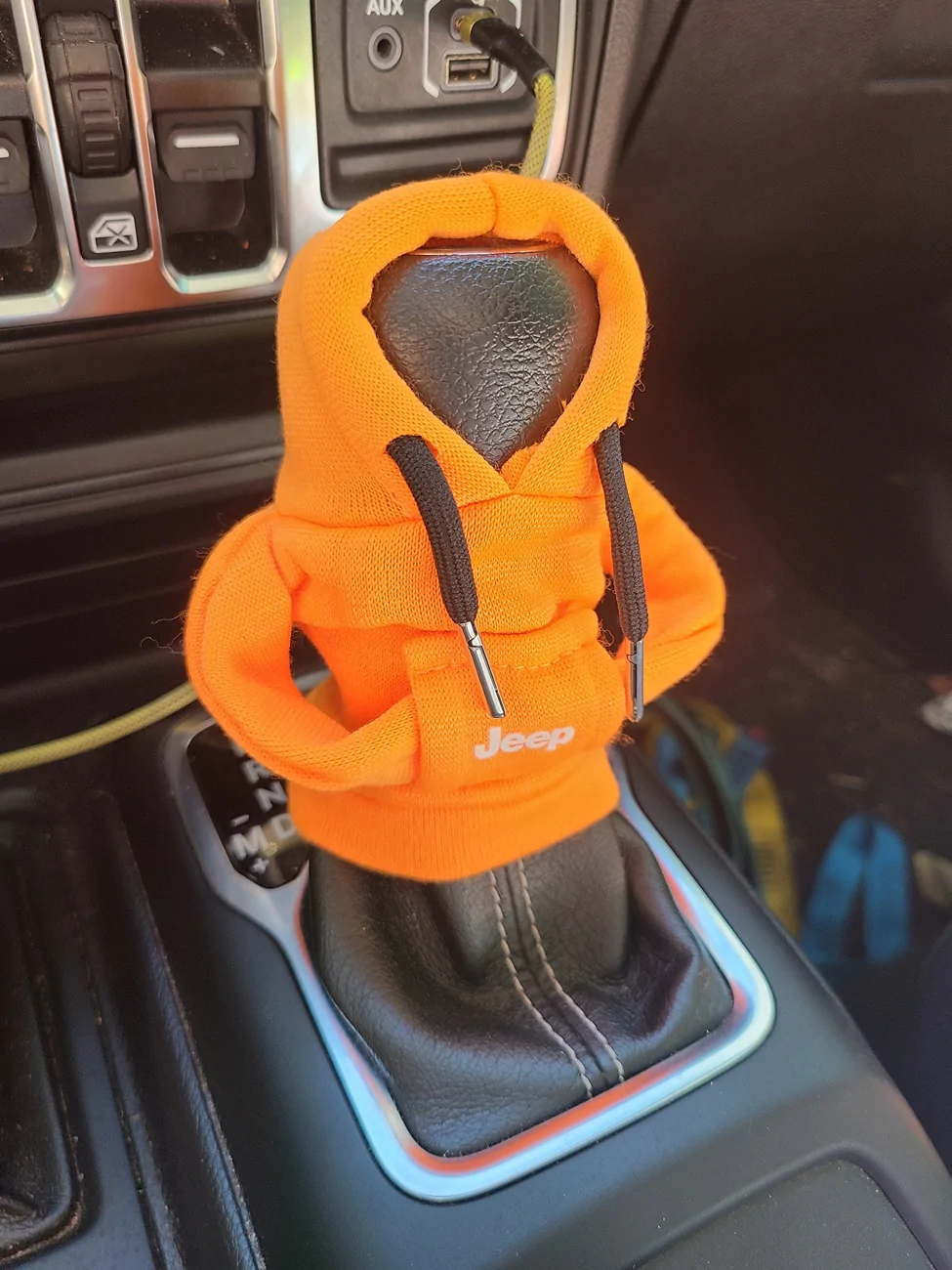

Just got my first Jeep less than a month ago, haven't even made the first payment yet, and I'm already modding it! Today I put gas struts under the hood, added some AliExpress sill guards, Changed out the front bumper, and most importantly, got a HOODIE FOR MY GEAR SHIFT! 😆🤣

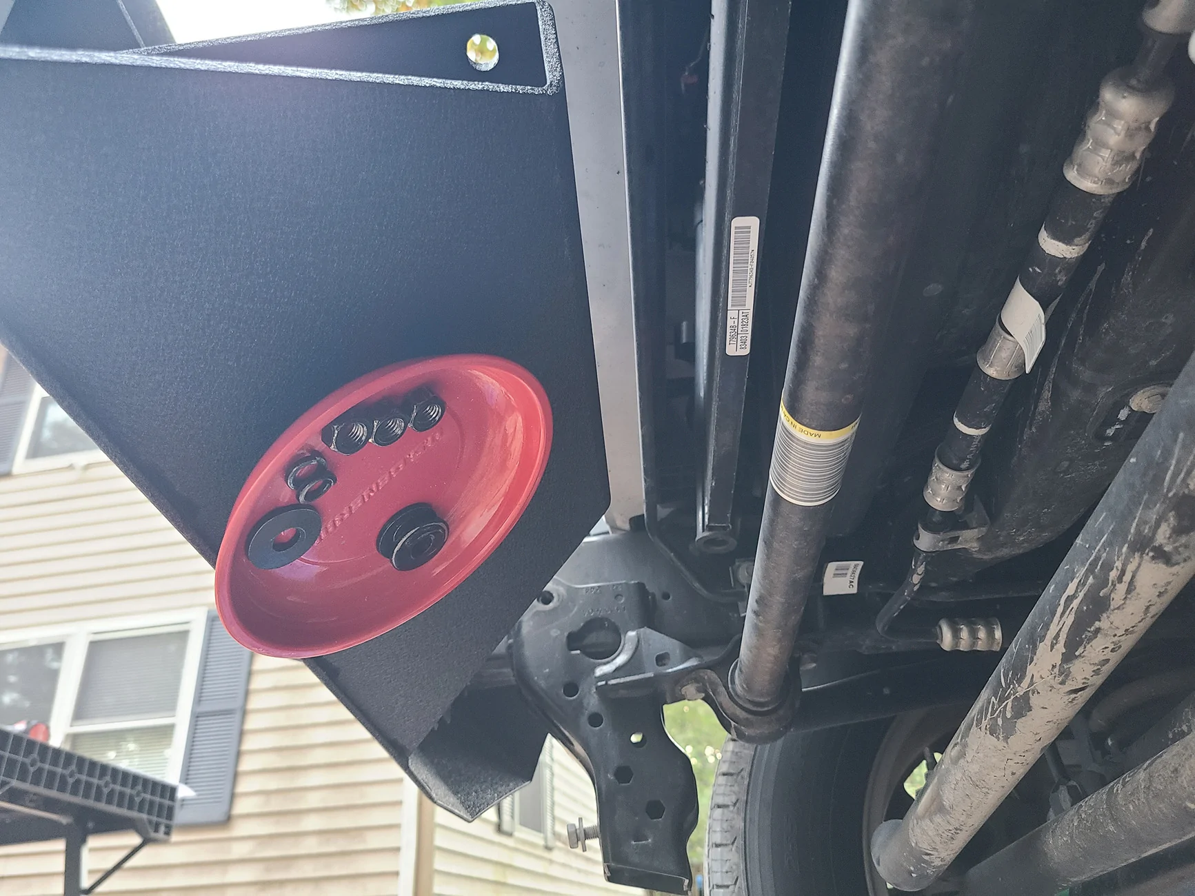

Got to use my little magnetic parts tray for the first time too. Pretty sweet little gadget.

This thing is so stupid and unnecessary, but it just makes me smile and chuckle every time I look at it. 5 bucks well spent.

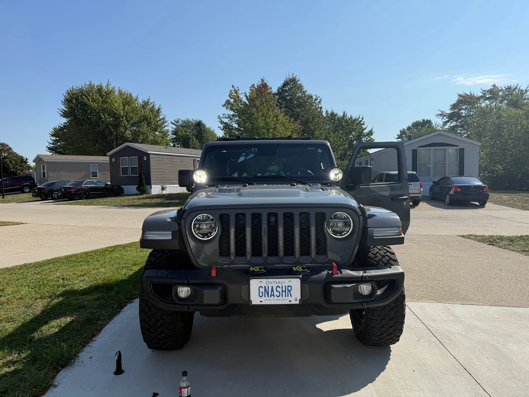

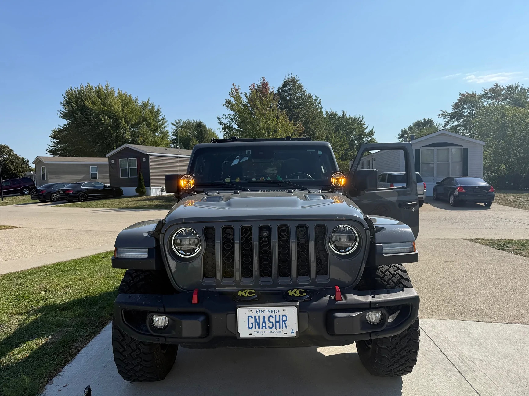

Wired up the KC Hilite Gravity Pro titans. The wire harness between the lights is barely long enough to cross the jeep’s firewall. It should be 3-6” longer. The included 10 amp and 20 amp fuses are overkill, the dust lights pull ~3amp and the main lights 15 amps. I’ve wired both to the 15 amp AUX 3 and 4 switches.
Also installed a Glow Badge Aux switch board.
